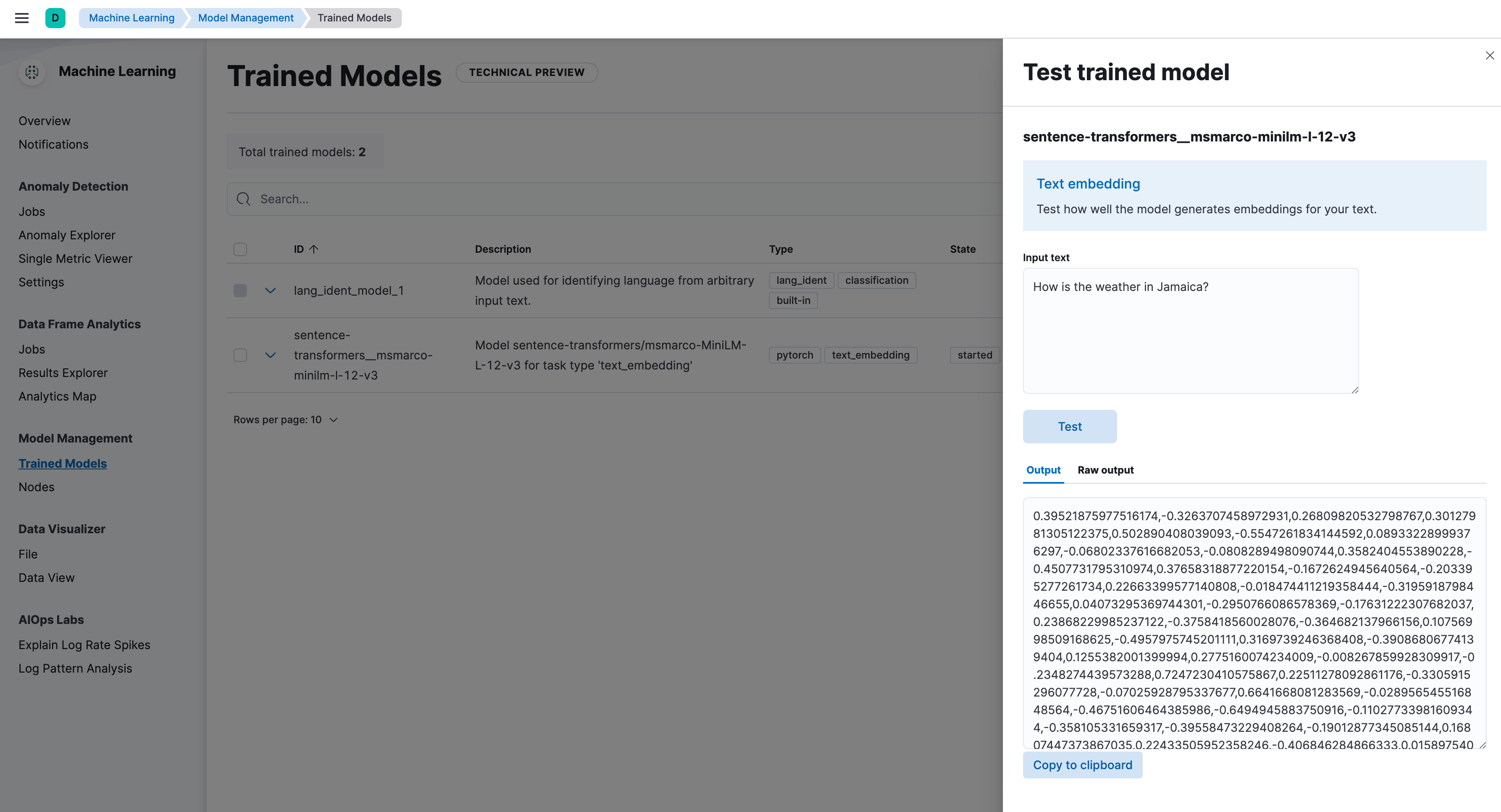

Test the text embedding model
Deployed models can be evaluated in Kibana under Machine Learning > Trained Models by selecting the Test model action for the respective model.
Test trained model UI
Test the model by using the _infer API
You can also evaluate your models by using the _infer API. In the following request, text_field is the field name where the model expects to find the input, as defined in the model configuration. By default, if the model was uploaded via Eland, the input field is text_field.
POST /_ml/trained_models/sentence-transformers__msmarco-minilm-l-12-v3/_infer
  "docs": {
    "text_field": "How is the weather in Jamaica?"
The API returns a response similar to the following:
  "inference_results": [
      "predicted_value": [
        0.39521875977516174,
        -0.3263707458972931,
        0.26809820532798767,
        0.30127981305122375,
        0.502890408039093,
The result is the predicted dense vector transformed from the example text.

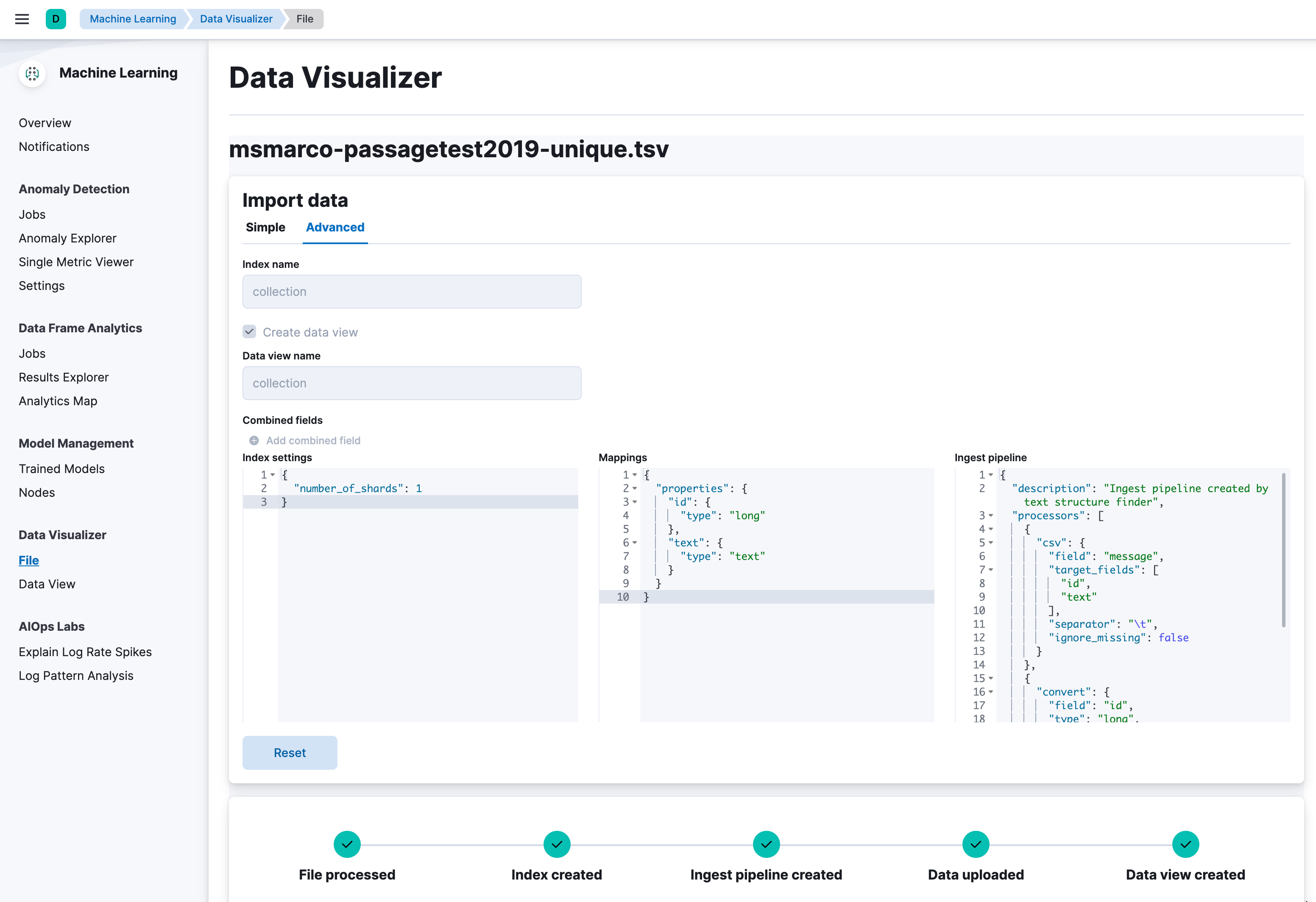

Load data
In this step, you load the data that you later use in an ingest pipeline to get the embeddings.
The data set msmarco-passagetest2019-top1000 is a subset of the MS MARCO Passage Ranking data set used in the testing stage of the 2019 TREC Deep Learning Track. It contains 200 queries and for each query a list of relevant text passages extracted by a simple information retrieval (IR) system. From that data set, all unique passages with their IDs have been extracted and put into a tsv file, totaling 182469 passages. In the following, this file is used as the example data set.
Upload the file by using the Data Visualizer. Name the first column id and the second one text. The index name is collection. After the upload is done, you can see an index named collection with 182469 documents.
Importing the data

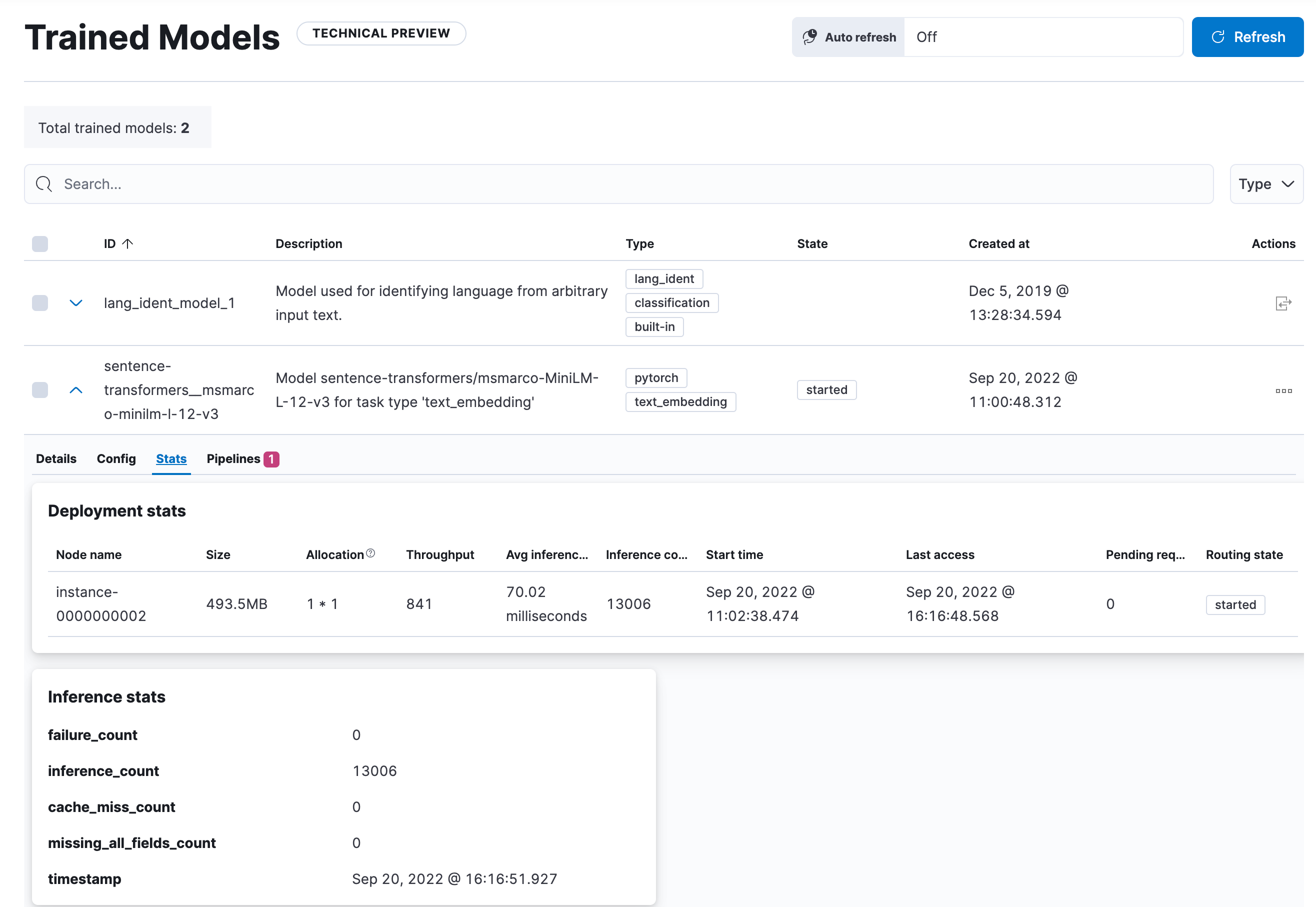

Create the text embeddings by reindexing the data to the collection-with-embeddings index through the inference pipeline. The inference ingest processor inserts the embedding vector into each document.
POST _reindex?wait_for_completion=false
  "source": {
    "index": "collection",
    "size": 50
  "dest": {
    "index": "collection-with-embeddings",
    "pipeline": "text-embeddings"
The default batch size for reindexing is 1000. Reducing size to a smaller number makes the update of the reindexing process quicker which enables you to follow the progress closely and detect errors early.
The API call returns a task ID that can be used to monitor the progress:
GET _tasks/<task_id>
You can also open the model stat UI to follow the progress.
Model status UI
After the reindexing is finished, the documents in the new index contain the inference results – the vector embeddings.
