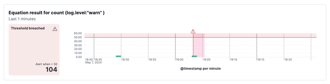

- The page includes a chart for each condition specified in the rule. These charts help you understand when the breach occurred and its severity.

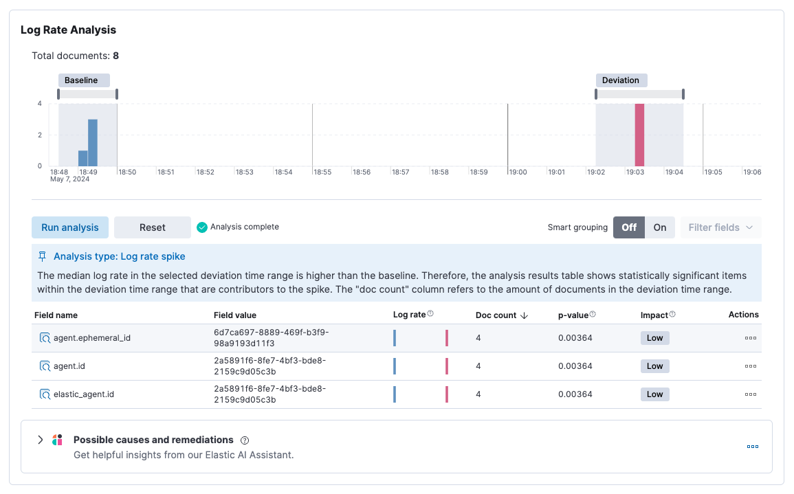

- If your rule is intended to detect log threshold breaches (that is, it has a single condition that uses a count aggregation), you can run a log rate analysis, assuming you have the required license. Running a log rate analysis is useful for detecting significant dips or spikes in the number of logs. Notice that you can adjust the baseline and deviation, and then run the analysis again. For more information about using the log rate analysis feature, refer to the AIOps Labs documentation.

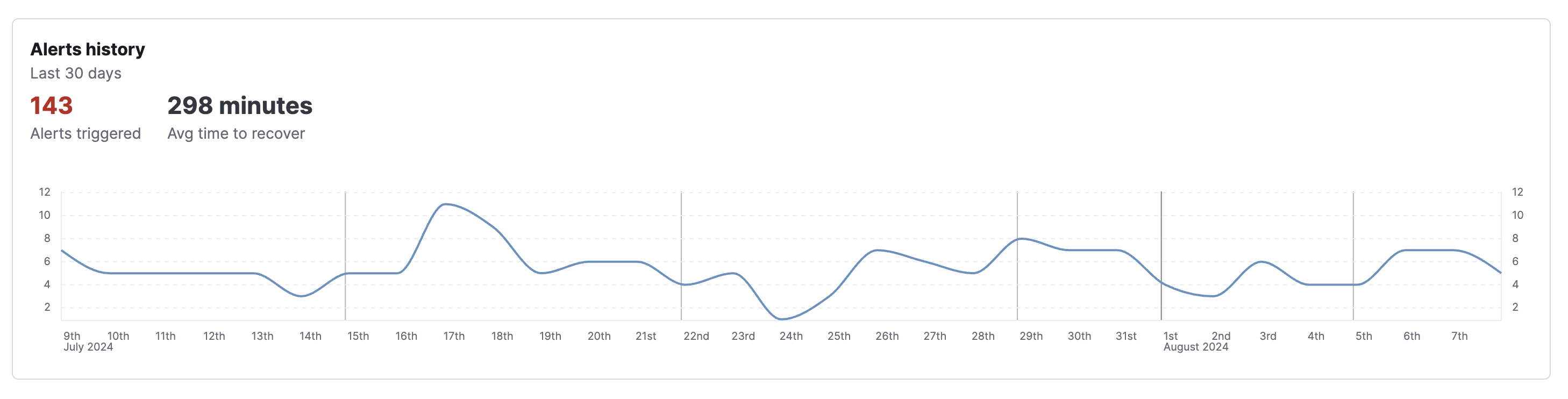

- The page may also include an alerts history chart that shows the number of triggered alerts per day for the last 30 days. This chart is currently only available for rules that specify a single condition.
- Timelines on the page are annotated to show when the threshold was breached. You can hover over an alert icon to see the timestamp of the alert.
Analyze these charts to better understand when the breach started, it’s current state, and how the issue is trending.
