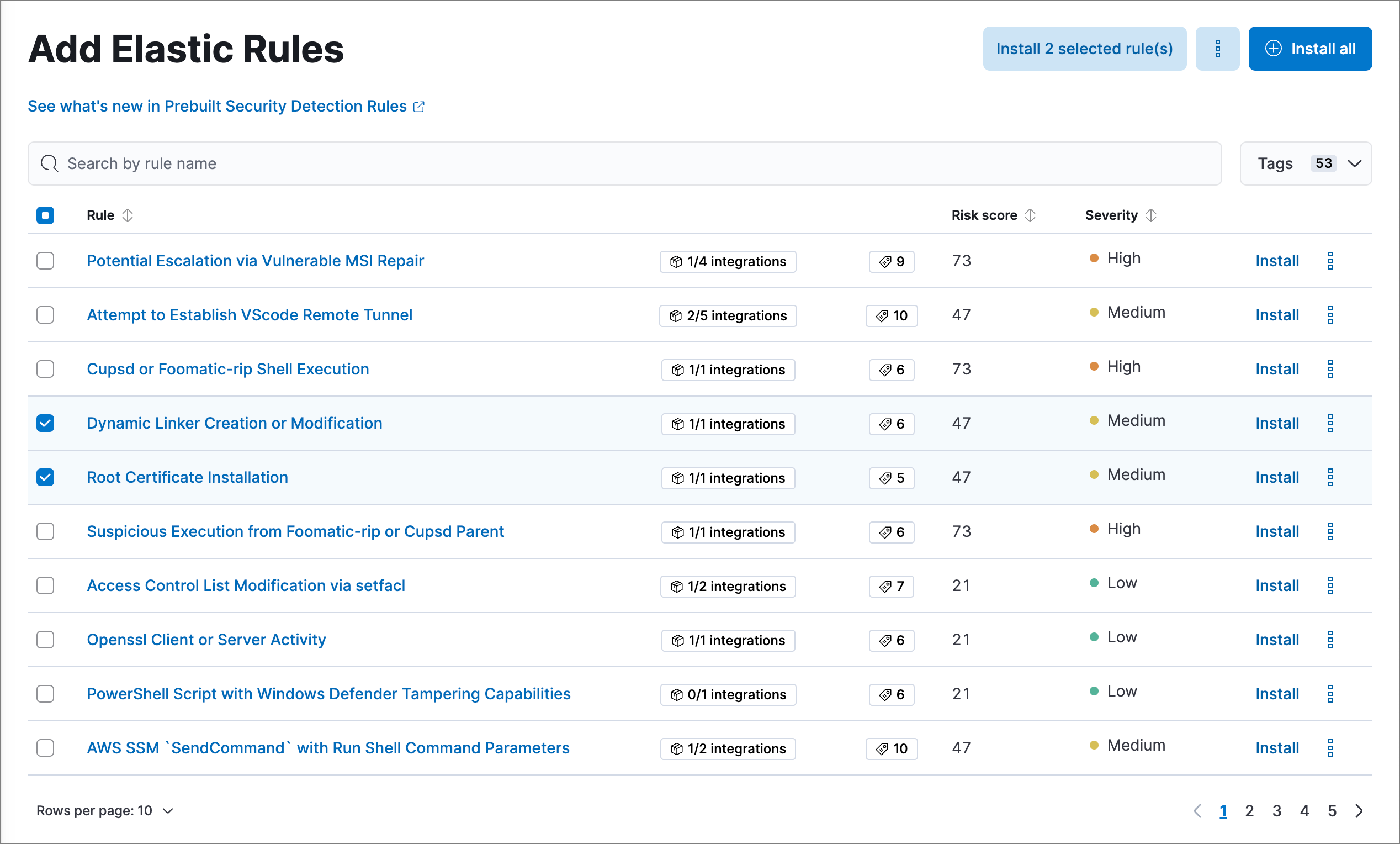

Go to Rules → Detection rules (SIEM). The badge next to Add Elastic rules shows the number of prebuilt rules available for installation.
Click Add Elastic rules.
To examine the details of a rule before you install it, select the rule name. This opens the rule details flyout.
Do one of the following:
- Install all available rules: Click Install all at the top of the page. (This doesn’t enable the rules; you still need to do that manually.)
Install a single rule: In the rules table, either click Install to install a rule without enabling it, or click
→ Install and enable to start running the rule once it’s installed.
Install multiple rules: Select the rules, and then at the top of the page either click Install x selected rule(s) to install without enabling the rules, or click
→ Install and enable to install and start running the rules.
Use the search bar and Tags filter to find the rules you want to install. For example, filter by
OS: Windows
if your environment only includes Windows endpoints. For more on tag categories, refer to Prebuilt rule tags. -

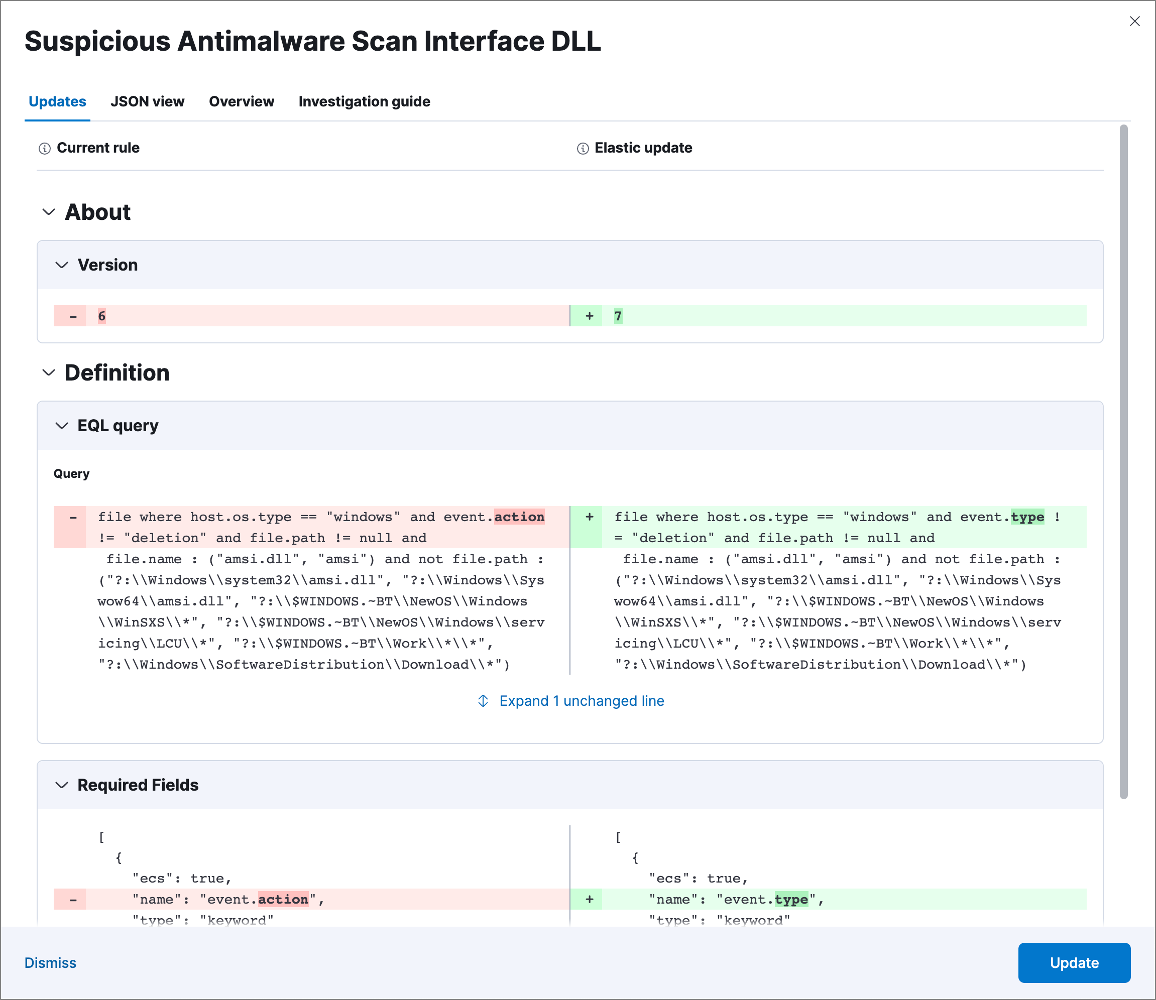

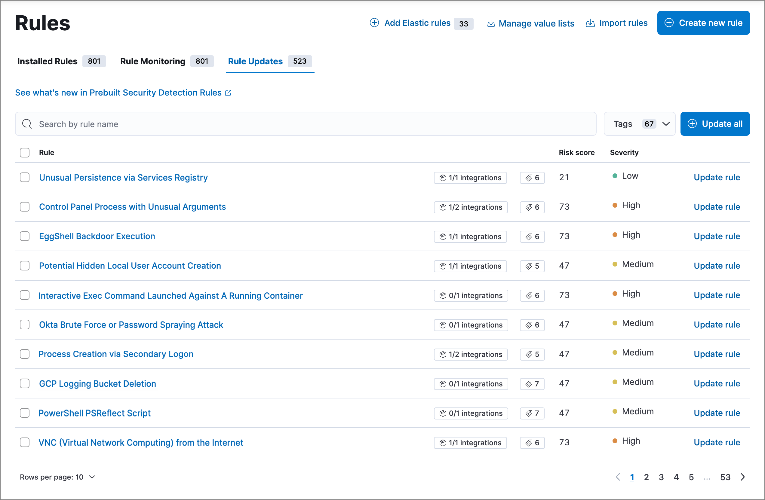

editElastic regularly updates prebuilt rules to optimize their performance and ensure they detect the latest threats and techniques. When updated versions are available for your installed prebuilt rules, the Rule Updates tab appears on the Rules page, allowing you to update your installed rules with the latest versions.
Go to Rules → Detection rules (SIEM), then select the Rule Updates tab.
The Rule Updates tab doesn’t appear if all your installed prebuilt rules are up to date.
(Optional) To examine the details of a rule’s latest version before you update it, select the rule name. This opens the rule details flyout.
Select the Updates tab to view rule changes field by field, or the JSON view tab to view changes for the entire rule in JSON format. Both tabs display side-by-side comparisons of the Current rule (what you currently have installed) and the Elastic update version (what you can choose to install). Deleted characters are highlighted in red; added characters are highlighted in green.
To accept the changes and install the updated version, select Update.
Do one of the following to update prebuilt rules on the Rules page:
- Update all available rules: Click Update all.
- Update a single rule: Click Update rule for that rule.
Update multiple rules: Select the rules and click Update x selected rule(s).
Use the search bar and Tags filter to find the rules you want to update. For example, filter by
OS: Windows
