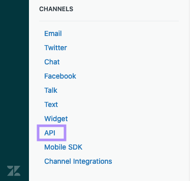

Step 1. Locate the Zendesk Admin interface (gear icon in the sidebar). Select API under Channels:

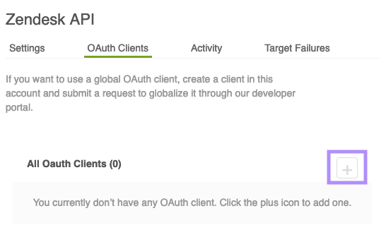

Step 2. Make sure to agree to the Terms of Service. Navigate over to the OAuth Clients tab and click the + button on the right-hand side:
