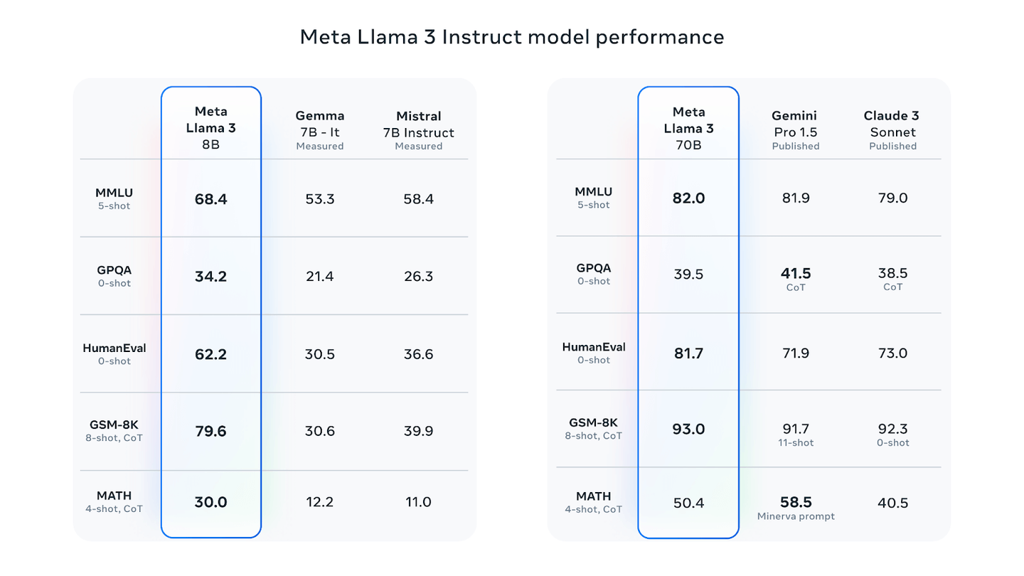

Meta Llama 3 Instruct Model Performance. (from https://ai.meta.com/blog/meta-llama-3/)
The above figure shows data on Llama3 performance across different datasets as compared to other models. In order to be optimized for performance for real world scenarios, Llama3 was also evaluated on a high quality human evaluation set.

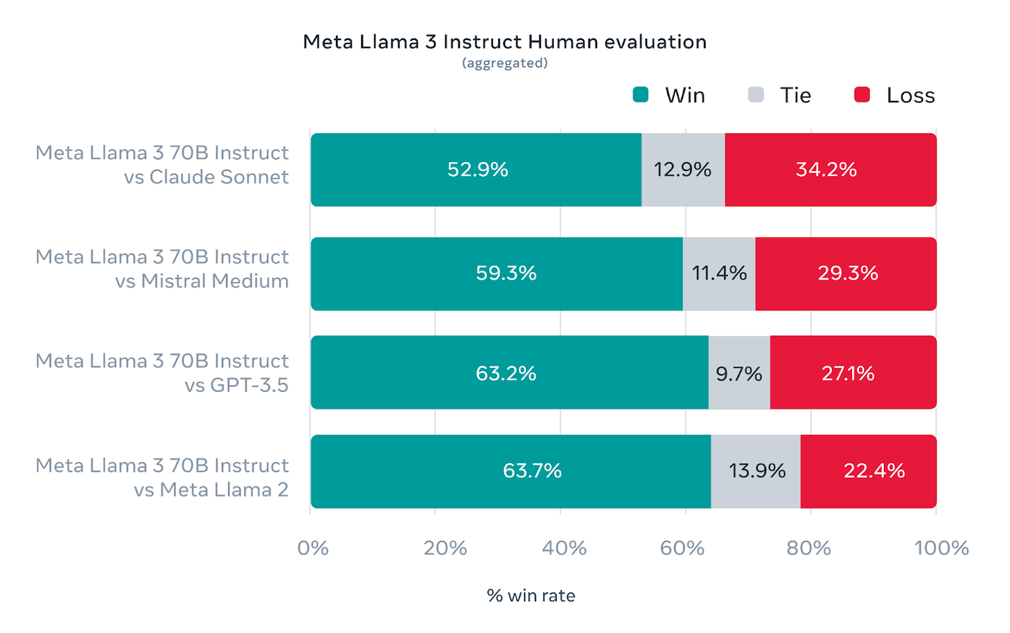

Aggregated results of Human Evaluations across multiple categories and prompts (from https://ai.meta.com/blog/meta-llama-3/)

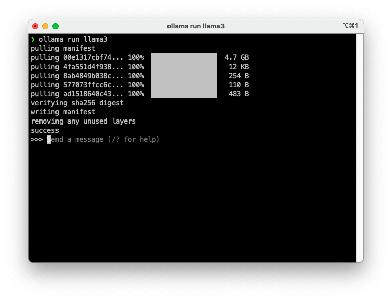

  2. Once installed, follow the commands below to download the Llama3 model.
    ollama run llama3
This should take some time depending upon your network bandwidth. Once the run completes, you should end with the interface below.

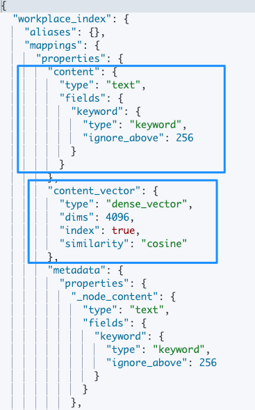

ElasticsearchStore is defined with the name of the index to be created, the vector field and the content field. And this index is created when we run the pipeline.
The index mapping created is as below:
The pipeline is executed using the step below. Once this pipeline run completes, the index workplace_index is now available for querying. Do note that the vector field content_vector is created as a dense vector with dimension 4096. The dimension size comes from the size of the embeddings generated from Llama3.

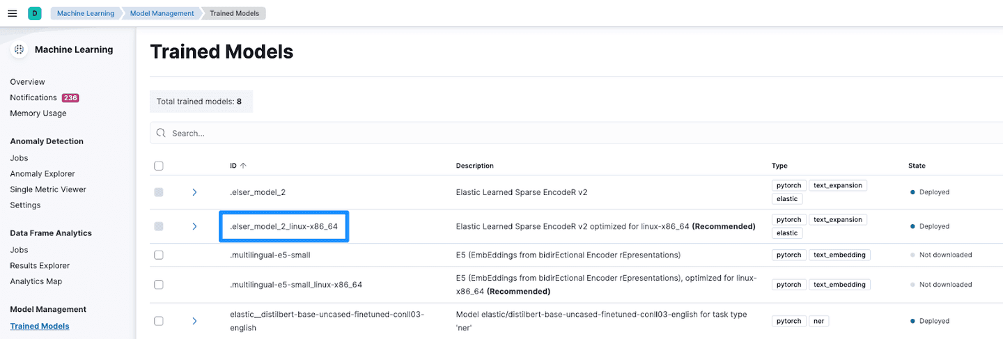

Let's now move to the second method, which uses Llama3 as a local LLM, but we use Elastic’s ELSER v2 to generate embeddings and for semantic search.
Method 2: Elastic, Langchain, ELSER v2, Llama 3 (8B) version running locally using Ollama.

The vector store is defined with the index to be created and the model to be used for embedding and retrieval. You can retrieve the model_id by navigating to Trained Models under Machine Learning.
This also results in the creation of an ingest pipeline in Elastic, which generates and stores the embeddings as the documents are ingested into Elastic.
