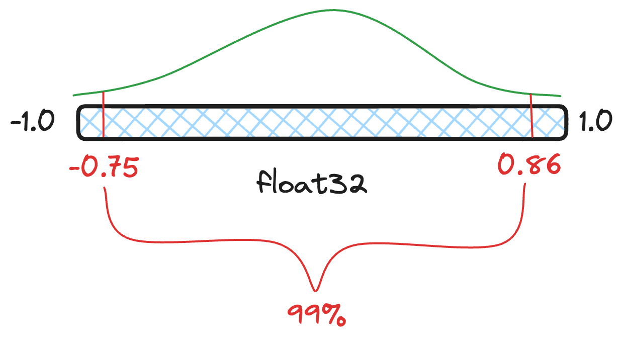

Introduced in Elasticsearch 8.12, scalar quantization was initially a simple min/max quantization scheme. Per lucene segment, we would find the global quantile values for a given confidence interval. These quantiles are then used as the minimum and maximum to quantize all the vectors. While this naive quantization is powerful, it only really works for whole byte quantization.
In Elasticsearch 8.15, we added half-byte, or int4, quantization. To achieve this with high recall, we added an optimization step, allowing for the best quantiles to be calculated dynamically. Meaning, no more static confidence intervals. Lucene will calculate the best global upper and lower quantiles for each segment. Achieving 8x reduction in memory utilization over float32 vectors.

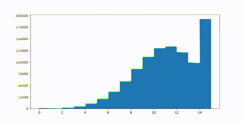

  • Each vector, is centered on the Apache Lucene segment's centroid. This allows us to make better use of the possible quantized vectors to represent the dataset as a whole.
  • Every vector is individually quantized with a unique set of optimized quantiles.
  • Asymmetric quantization is used allowing for higher recall with the same memory footprint.

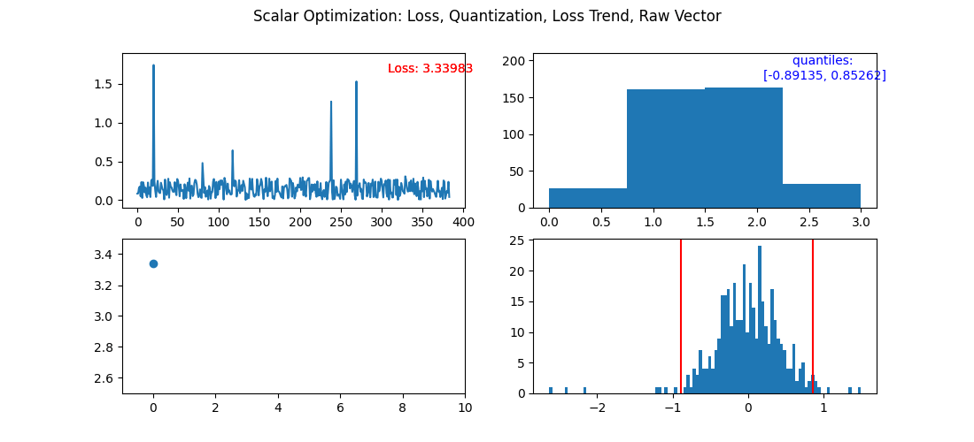

In short, when quantizing each vector:
  • We center the vector on the centroid
  • Compute a limited number of iterations to find the optimal quantiles. Stopping early if the quantiles are unchanged or the error (loss) increases
  • Pack the resulting quantized vectors

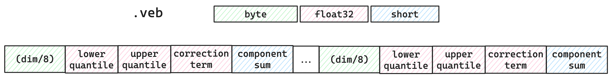

  • Store the packed vector, its quantiles, the sum of its components, and an extra error correction term
Storage and Retrieval
The storage and retrieval of optimized scalar quantization vectors are similar to BBQ. The main difference is the particular values we store.
One piece of nuance is the correction term. For Euclidean distance, we store the squared norm of the centered vector. For dot product we store the dot product between the centroid and the uncentered vector.
