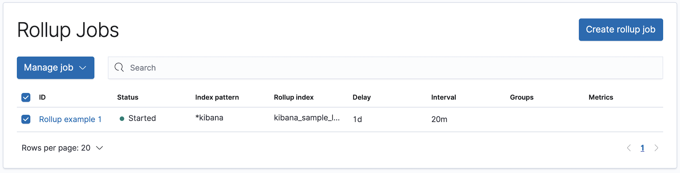

A rollup job is a periodic task that aggregates data from indices specified by an index pattern, and then rolls it into a new index. Rollup indices are a good way to compactly store months or years of historical data for use in visualizations and reports.
To get started, open the main menu, then click Stack Management > Rollup Jobs.
![][List of currently active rollup jobs](images/management_rollup_list.png)

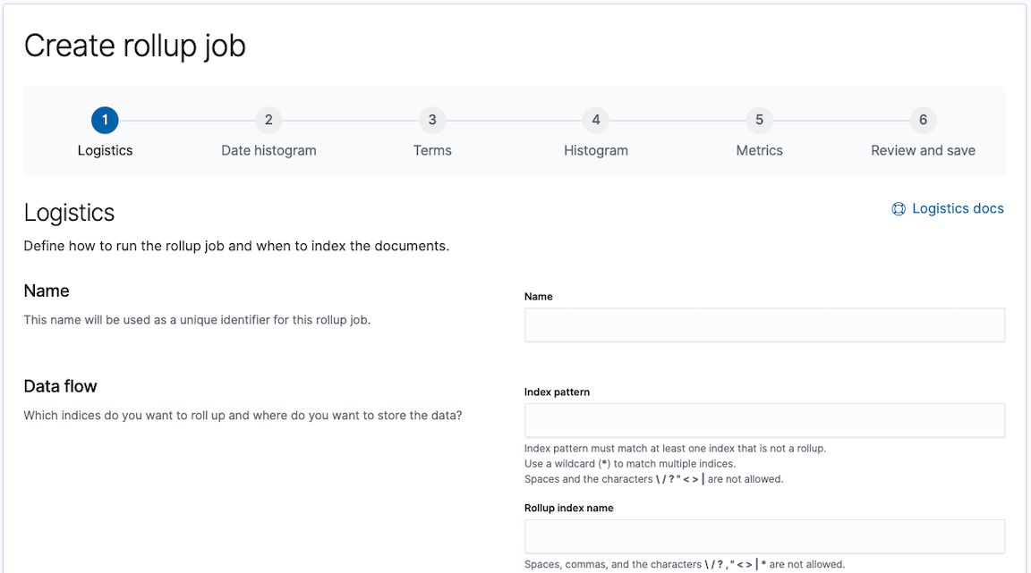

Create a rollup job
editKibana makes it easy for you to create a rollup job by walking you through the process. You fill in the name, data flow, and how often you want to roll up the data. Then you define a date histogram aggregation for the rollup job and optionally define terms, histogram, and metrics aggregations.
When defining the index pattern, you must enter a name that is different than
the output rollup index. Otherwise, the job
will attempt to capture the data in the rollup index. For example, if your index pattern is metricbeat-*
you can name your rollup index rollup-metricbeat
, but not metricbeat-rollup
![][Wizard that walks you through creation of a rollup job](images/management_create_rollup_job.png)

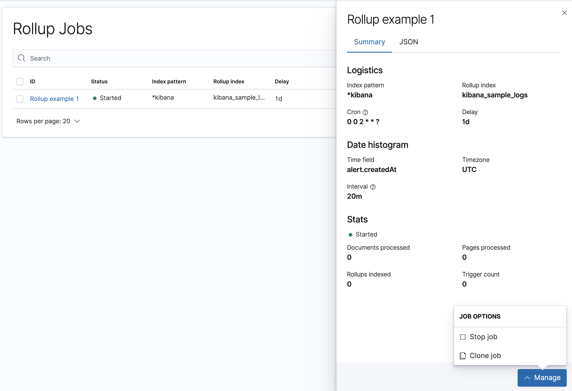

Start, stop, and delete rollup jobs
editOnce you’ve saved a rollup job, you’ll see it the Rollup Jobs overview page, where you can drill down for further investigation. The Manage menu enables you to start, stop, and delete the rollup job. You must first stop a rollup job before deleting it.
![][Rollup job details](images/management_rollup_job_details.png)
You can’t change a rollup job after you’ve created it. To select additional fields or redefine terms, you must delete the existing job, and then create a new one with the updated specifications. Be sure to use a different name for the new rollup job—reusing the same name can lead to problems with mismatched job configurations. You can read more at rollup job configuration.

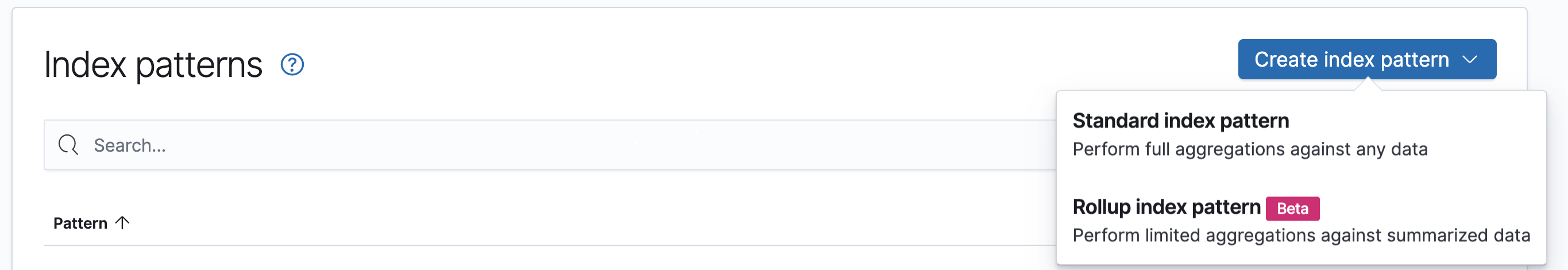

- Open the main menu, then click Stack Management > Index Patterns.
Click Create index pattern, and select Rollup index pattern from the dropdown.
Enter rollup_logstash,kibana_sample_logs as your Index Pattern and
@timestamp
as the Time Filter field name.The notation for a combination index pattern with both raw and rolled up data is

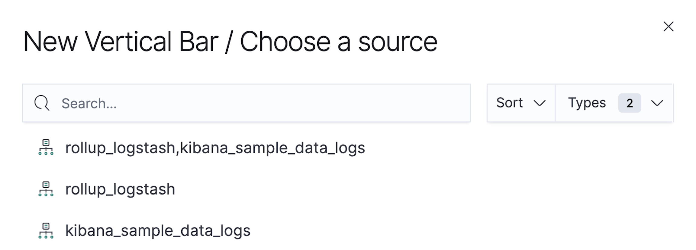

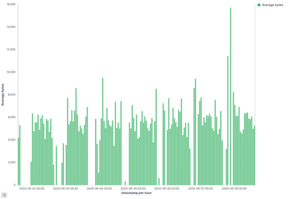

matches the index pattern for raw data. - Open the main menu, click Dashboard, then create and add a vertical bar chart.
Choose
rollup_logstash,kibana_sample_data_logs

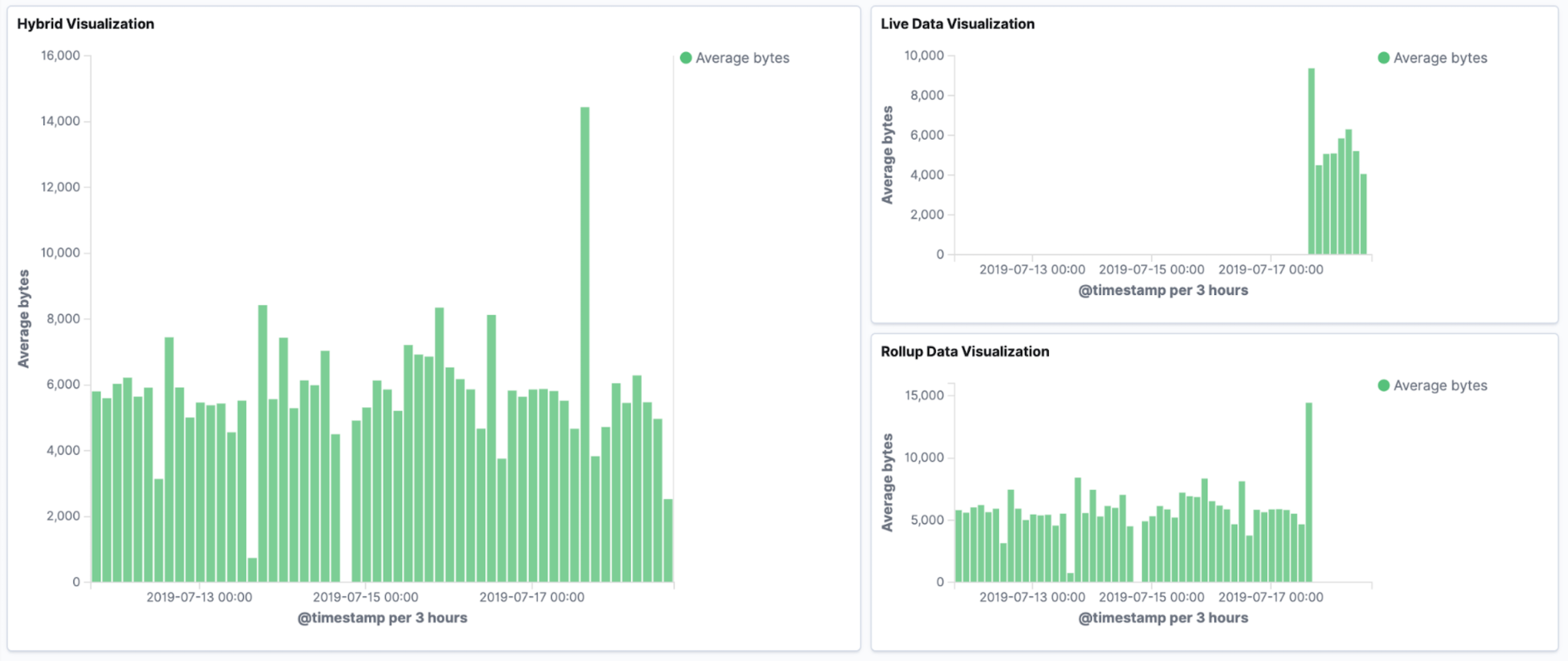

as your source to see both the raw and rolled up data. -
Look at the data in your visualization.
Optionally, create a dashboard that contains visualizations of the rolled up data, raw data, or both.
