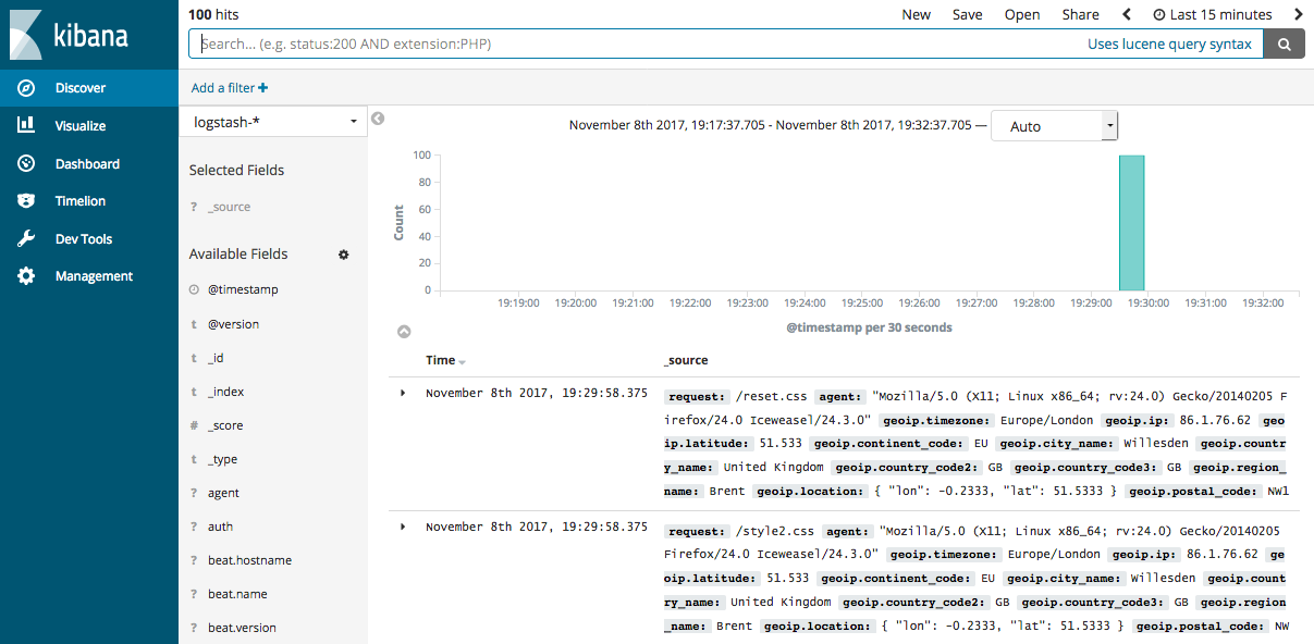

Indexing Your Data into Elasticsearch
Now that the web logs are broken down into specific fields, you’re ready to get your data into Elasticsearch.
You can run Elasticsearch on your own hardware or use our hosted Elasticsearch Service that is available on AWS, GCP, and Azure. Try the Elasticsearch Service for free.
The Logstash pipeline can index the data into an Elasticsearch cluster. Edit the first-pipeline.conf file and replace the entire output section with the following text:
output {
    elasticsearch {
        hosts => [ "localhost:9200" ]
With this configuration, Logstash uses http protocol to connect to Elasticsearch. The above example assumes that Logstash and Elasticsearch are running on the same instance. You can specify a remote Elasticsearch instance by using the hosts configuration to specify something like hosts => [ "es-machine:9092" ].
At this point, your first-pipeline.conf file has input, filter, and output sections properly configured, and looks something like this:
input {
    beats {
        port => "5044"
 filter {
    grok {
        match => { "message" => "%{COMBINEDAPACHELOG}"}
    geoip {
        source => "clientip"
output {
    elasticsearch {
Save your changes. To force Filebeat to read the log file from scratch, as you did earlier, shut down Filebeat (press Ctrl+C), delete the registry file, and then restart Filebeat with the following command:
sudo ./filebeat -e -c filebeat.yml -d "publish"
Testing Your Pipeline
Now that the Logstash pipeline is configured to index the data into an Elasticsearch cluster, you can query Elasticsearch.
Try a test query to Elasticsearch based on the fields created by the grok filter plugin. Replace $DATE with the current date, in YYYY.MM.DD format:
curl -XGET 'localhost:9200/logstash-$DATE/_search?pretty&q=response=200'
The date used in the index name is based on UTC, not the timezone where Logstash is running. If the query returns index_not_found_exception, make sure that logstash-$DATE reflects the actual name of the index. To see a list of available indexes, use this query: curl 'localhost:9200/_cat/indices?v'.
You should get multiple hits back. For example:
  "took": 50,
  "timed_out": false,
  "_shards": {
    "total": 5,
    "successful": 5,
    "skipped": 0,
    "failed": 0
  "hits": {
    "total": 98,
    "max_score": 2.793642,
    "hits": [
        "_index": "logstash-2017.11.09",
        "_type": "doc",
        "_id": "3IzDnl8BW52sR0fx5wdV",
        "_score": 2.793642,
        "_source": {
          "request": "/presentations/logstash-monitorama-2013/images/frontend-response-codes.png",
          "agent": """"Mozilla/5.0 (Macintosh; Intel Mac OS X 10_9_1) AppleWebKit/537.36 (KHTML, like Gecko) Chrome/32.0.1700.77 Safari/537.36"""",
          "geoip": {
            "timezone": "Europe/Moscow",
            "ip": "83.149.9.216",
            "latitude": 55.7485,
            "continent_code": "EU",
            "city_name": "Moscow",
            "country_name": "Russia",
            "country_code2": "RU",
            "country_code3": "RU",
            "region_name": "Moscow",
            "location": {
              "lon": 37.6184,
              "lat": 55.7485
            "postal_code": "101194",
            "region_code": "MOW",
            "longitude": 37.6184
          "offset": 2932,
          "auth": "-",

If you are using Kibana to visualize your data, you can also explore the Filebeat data in Kibana:
Discovering Filebeat data in Kibana
See the Filebeat quick start docs for info about loading the Kibana index pattern for Filebeat.
