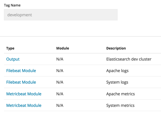

Beats. For example, you might have a tag called development
that you use to
group all configurations that are valid for running Beats in your development
environment. The development
tag might have:
- Two Metricbeat module configuration blocks: one that reads system metrics and another that reads metrics from Apache HTTP servers
- Two Filebeat module configuration blocks: one that reads Apache HTTP server logs and another that reads system logs
- One Elasticsearch output configuration block that sends the output to your Elasticsearch development cluster

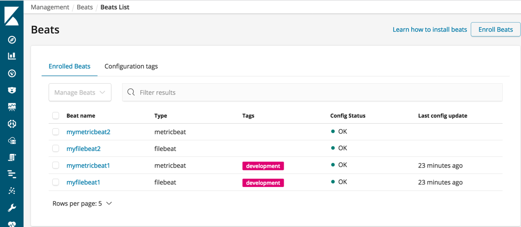

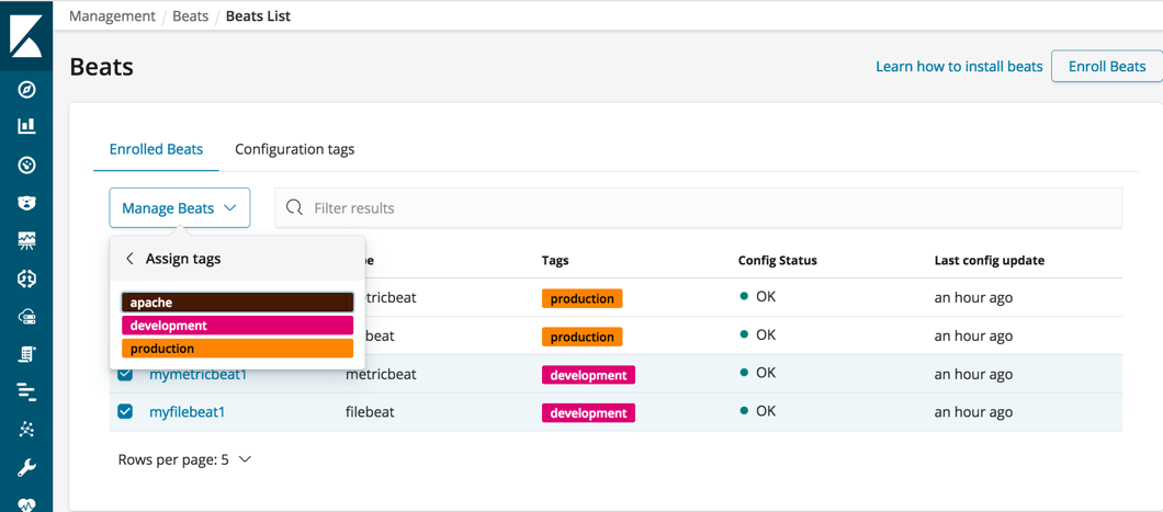

You can add or remove tags to change the set of configuration blocks applied to
your Beats. For example, after you’ve tested configurations in your
development
environment, you can remove the development
tag and add a
production
tag that has an Elasticsearch output configuration block for sending the
data to your production cluster.

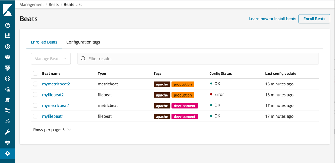

You can apply multiple tags to a Beat. For example, instead of defining the
apache modules under the development
tag as described earlier, you could
create a separate tag called apache
that contains the Apache module
configurations, then apply the tag to all Beats running on Apache servers.
This would enable you to maintain your Apache module configurations under a
single tag, while also using a development
tag to send output for some
instances to your development cluster.
You can apply as many tags as you need. Just keep in mind that the configurations for all assigned tags are merged, which means that you should not specify conflicting configurations. If there are errors in the configuration, you’ll see an Error status in the Central Management UI and need to look at the logs for the Beat to troubleshoot the problem.
