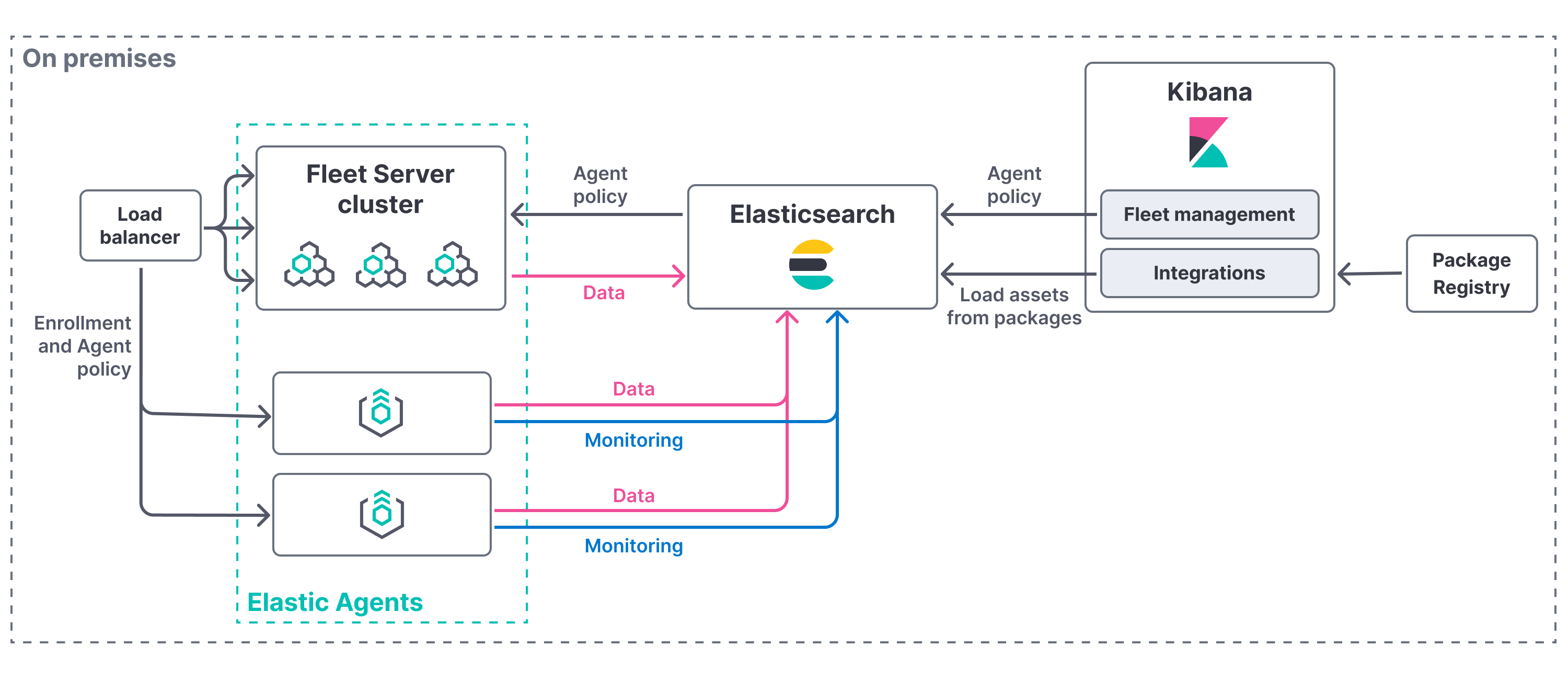

editTo use Fleet for central management, a Fleet Server must be running and accessible to your hosts.
You can deploy Fleet Server on-premises and manage it yourself. In this deployment model, you are responsible for high-availability, fault-tolerance, and lifecycle management of Fleet Server.
This approach might be right for you if you would like to limit the control plane traffic out of your data center or have requirements for fully air-gapped operations. For example, you might take this approach if you need to satisfy data governance requirements or you want agents to only have access to a private segmented network.
This approach might not be right for you if you don’t want to manage the life cycle of your Elastic environment and instead would like that to be handled by Elastic.
When using this approach, it’s recommended that you provision multiple instances of the Fleet Server and use a load balancer to better scale the deployment. You also have the option to use your organization’s certificate to establish a secure connection from Fleet Server to Elasticsearch.

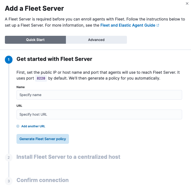

Add Fleet Server
editA Fleet Server is an Elastic Agent that is enrolled in a Fleet Server policy. The policy configures the agent to operate in a special mode to serve as a Fleet Server in your deployment.
To add a Fleet Server:
- In Kibana, go to Management → Fleet
- Click the Agents tab if it isn’t already selected.
- Click Add Fleet Server.
This opens in-product instructions to add a Fleet Server using one of two options: Quick Start or Advanced.
Use Quick Start if you want Fleet to generate a Fleet Server policy and enrollment token for you. The Fleet Server policy will include a Fleet Server integration plus a system integration for monitoring Elastic Agent. This option generates self-signed certificates and is not recommended for production use cases.

Step through the in-product instructions to configure and install Fleet Server.
- The fields to configure Fleet Server hosts are not available if the hosts are already configured outside of Fleet. For more information, refer to Fleet settings in Kibana.
When using the Advanced option, it’s recommended to generate a unique service
token for each Fleet Server. For other ways to generate service tokens, refer to
elasticsearch-service-tokens
If you’ve configured a non-default port for Fleet Server in the
Fleet Server integration, you need to include the
--fleet-server-host
and--fleet-server-port
options in theelastic-agent install
command. Refer to the install command documentation for details. -
Please note that Fleet Server will keep using the Elasticsearch host provided via
--fleet-server-host
at install time. The Elasticsearch hosts configured in the associated policy will be ignored by the Fleet Server integration. We strongly recommend using a load balancer to avoid coupling the Fleet Server to the provided host.
At the Install Fleet Server to a centralized host step, the
command installs an Elastic Agent as a managed service and enrolls it in a Fleet Server policy. For more Fleet Server commands, refer to the Elastic Agent command reference. - If installation is successful, a confirmation indicates that Fleet Server is set up and connected.
