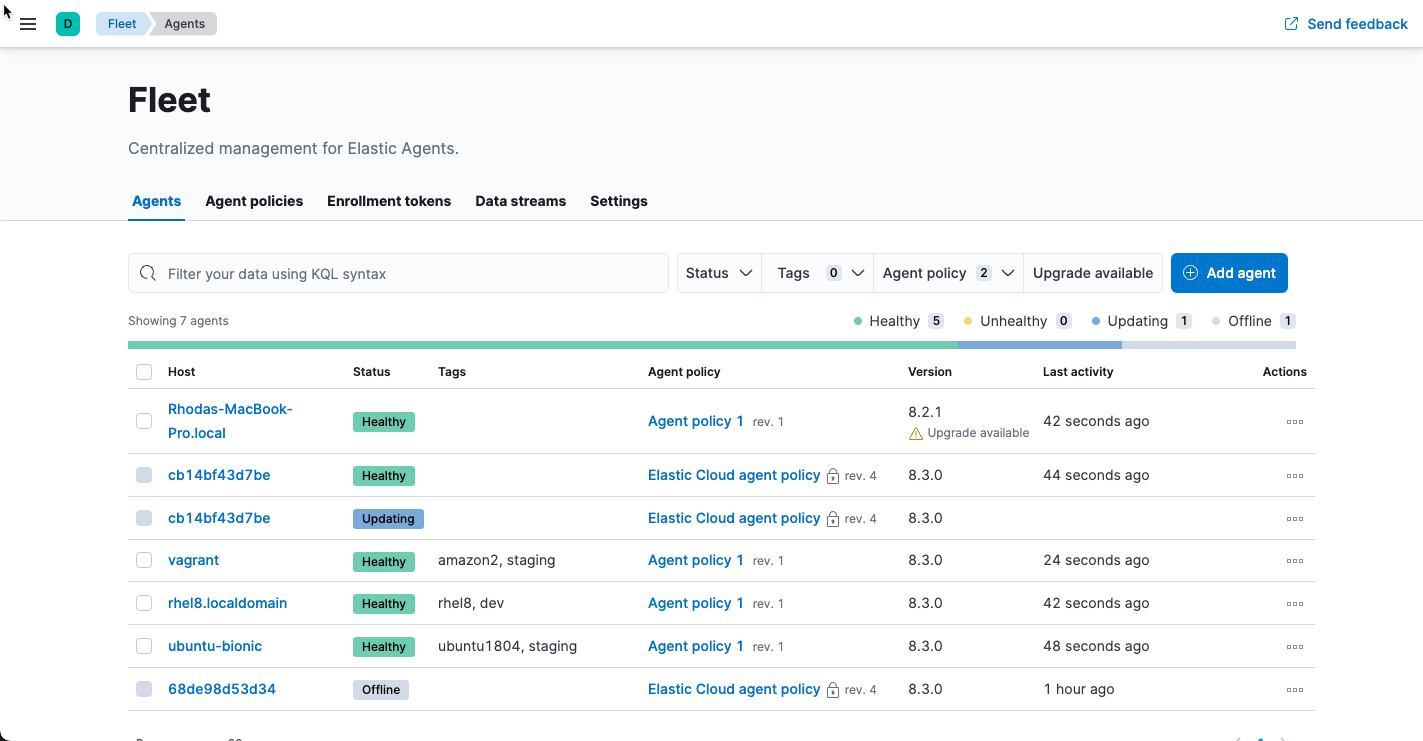

If Elastic Agent is configured as managed, in Kibana you can observe under Fleet>Agents

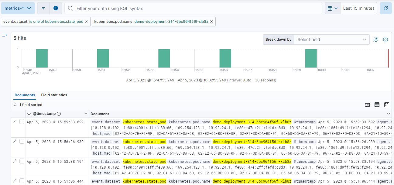

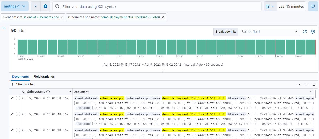

Verify Ingestion Latency
editKibana Discovery can be used to identify frequency of your metrics being ingested.
Filter for Pod dataset:
Filter for State_Pod dataset
Identify how many events have been sent to Elasticsearch:
kubectl logs -n kube-system elastic-agent-h24hh -f | grep -i state_pod [ouptut truncated ...] "state_pod":{"events":2936,"success":2936}
The number of events denotes the number of documents that should be depicted inside Kibana Discovery page.
For eg, in a cluster with 798 pods, then 798 docs should be depicted in block of ingestion inside Kibana
