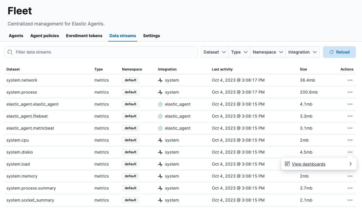

View agent details and inspect the data streams

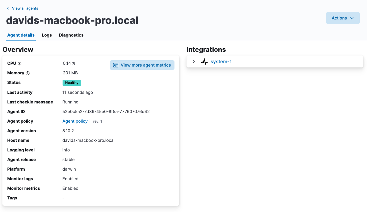

editAfter deploying an Elastic Agent to a host, view details about the agent and inspect the data streams it creates. To learn more about the benefits of using data streams, refer to Data streams.

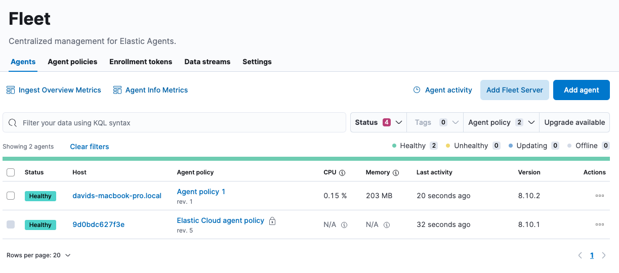

On the Agents tab in Fleet, confirm that the Elastic Agent status is
Healthy
Click the host name to examine the Elastic Agent details. This page shows the integrations that are currently installed, the policy the agent is enrolled in, and information about the host machine:
Go back to the main Fleet page and click the Data streams tab. You should be able to see the data streams for various logs and metrics from the host. This is out-of-the-box without any extra configuration or dashboard creation:

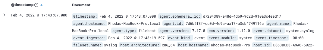

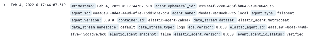

Go to Analytics > Discover and examine the data streams. Note that documents indexed by Elastic Agent match these patterns:
logs-*
metrics-*
If Beats are installed on the host machine, the data in Elasticsearch will be duplicated, with one set coming from Beats and another from Elastic Agent for the same data source.
For example, filter on
filebeat-*
to see the data ingested by Filebeat.Next, filter on
logs-*
. Notice that the document containsdata_stream.*
fields that come from logs ingested by the Elastic Agent.This duplication is superfluous and will consume extra storage space on your Elasticsearch deployment. After you’ve finished migrating all your configuration settings to Elastic Agent, you’ll remove Beats to prevent redundant messages.

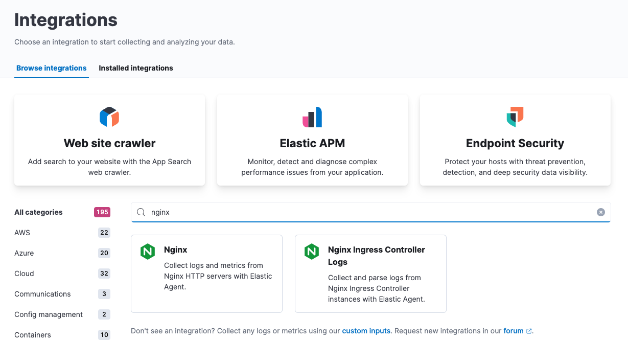

Add integrations to the agent policy
editNow that you’ve deployed an Elastic Agent to your host and it’s successfully sending data to Elasticsearch, add another integration. For guidance on which integrations you need, look at the list you created earlier when you prepared for the migration.
For example, if the agent policy you created earlier includes the System integration, but you also want to monitor Nginx:

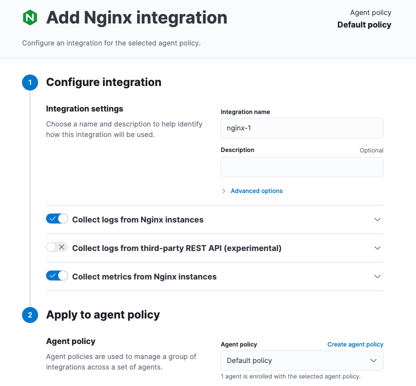

From the main menu in Kibana, click Add integrations and add the Nginx integration.
Configure the integration, then apply it to the agent policy you used earlier. Make sure you expand collapsed sections to see all the settings like log paths.
When you save and deploy your changes, the agent policy is updated to include a new integration policy for Nginx. All Elastic Agents enrolled in the agent policy get the updated policy, and the Elastic Agent running on your host will begin collecting Nginx data.
Integration policy names must be globally unique across all agent policies.
Go back to Fleet > Agents and verify that the agent status is still healthy. Click the host name to drill down into the agent details. From there, you can see the agent policy and integration policies that are applied.

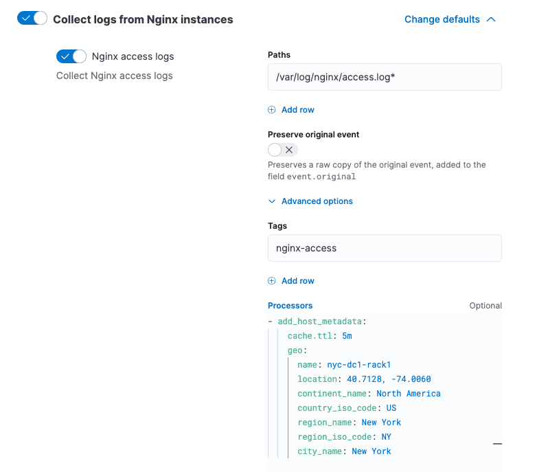

Migrate processor configurations
editProcessors enable you to filter and enhance the data before it’s sent to the output. Each processor receives an event, applies a defined action to the event, and returns the event. If you define a list of processors, they are executed in the order they are defined. Elastic provides a rich set of processors that are supported by all Beats and by Elastic Agent.
Prior to migrating from Beats, you defined processors in the configuration file for each Beat. After migrating to Elastic Agent, however, the Beats configuration files are redundant. All configuration is policy-driven from Fleet (or for advanced use cases, specified in a standalone agent policy). Any processors you defined previously in the Beats configuration need to be added to an integration policy; they cannot be defined in the Beats configuration.
Globally-defined processors are not currently supported by Elastic Agent. You must define processors in each integration policy where they are required.
To add processors to an integration policy:
- In Kibana, go to Fleet > Agent policies, and click the policy name to view its integration policies.
- Click the name of the integration policy to edit it.
Click the down arrow next to enabled streams, and under Advanced options, add the processor definition. The processor will be applied to the data set where it’s defined.
For example, the following processor adds geographically specific metadata to host events:
- add_host_metadata: cache.ttl: 5m geo: name: nyc-dc1-rack1 location: 40.7128, -74.0060 continent_name: North America country_iso_code: US region_name: New York region_iso_code: NY city_name: New York
In Kibana, look at the data again to confirm it contains the fields you expect.

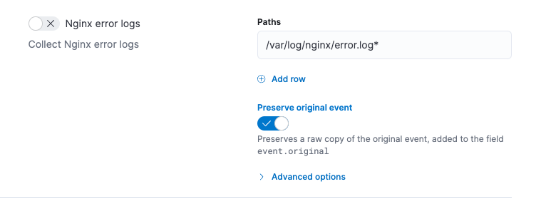

Preserve raw events
editIn some cases, Beats modules preserve the original, raw event, which consumes more storage space, but may be a requirement for compliance or forensic use cases.
In Elastic Agent, this behavior is optional and disabled by default.
If you must preserve the raw event, edit the integration policy, and for each enabled data stream, click the Preserve original event toggle.
Do this for every data stream with a raw event you want to preserve.

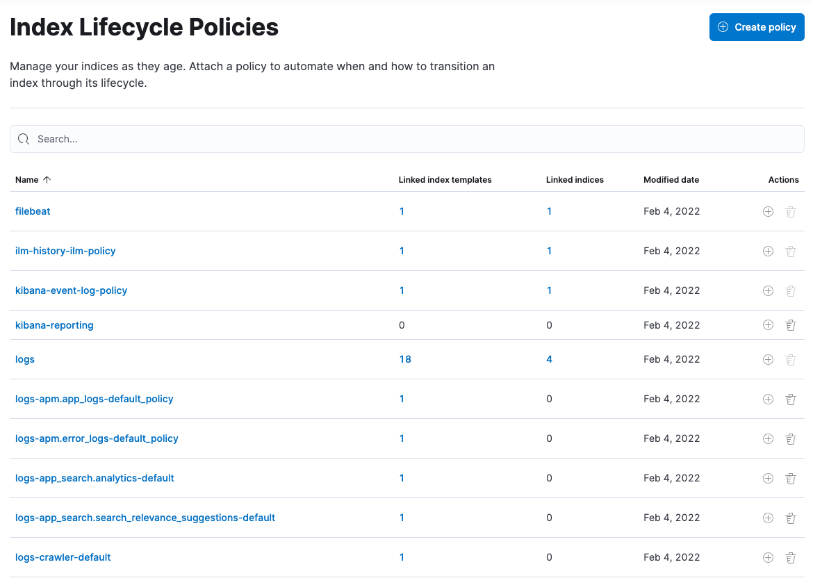

Migrate index lifecycle policies
editIndex lifecycle management (index lifecycle management) policies in Elasticsearch enable you to manage indices according to your performance, resiliency, and retention requirements. To learn more about index lifecycle management, refer to the index lifecycle management documentation.
index lifecycle management is configured by default in Beats (version 7.0 and later) and in Elastic Agent (all versions). To view the index lifecycle policies defined in Elasticsearch, go to Management > Index Lifecycle Policies.
If you used index lifecycle management with Beats, you’ll see index lifecycle policies like
filebeat and metricbeat in the list. After migrating to Elastic Agent, you’ll see
polices named logs and metrics, which encapsulate the index lifecycle management policies for all
logs-*
and metrics-*
index templates.
When you migrate from Beats to Elastic Agent, you have a couple of options for migrating index policy settings:
Modify the newly created index lifecycle policies (recommended). As mentioned earlier, index lifecycle management is enabled by default when the Elastic Agent is installed. Index lifecycle policies are created and added to the index templates for data streams created by integrations.
If you have existing index lifecycle policies for Beats, it’s highly recommended that you modify the lifecycle policies for Elastic Agent to match your previous policy. To do this:
- In Kibana, go to Stack Management > Index Lifecycle Policies and search for a Beats policy, for example, filebeat. Under Linked indices, notice you can view indices linked to the policy. Click the policy name to see the settings.
- Click the logs policy and, if necessary, edit the settings to match the old policy.
- Under Index Lifecycle Policies, search for another Beats policy, for example, metricbeat.
- Click the metrics policy and edit the settings to match the old policy.
Optionally delete the Beats index lifecycle policies when they are no longer used by an index.
Keep the Beats policy and apply it to the index templates created for data streams. To preserve an existing policy, modify it, as needed, and apply it to all the index templates created for data streams:
- Under Index Lifecycle Policies, find the Beats policy, for example, filebeat.
- In the Actions column, click the Add policy to index template icon.
- Under Index template, choose a data stream index template, then add the policy.
- Repeat this procedure, as required, to apply the policy to other data stream index templates.
