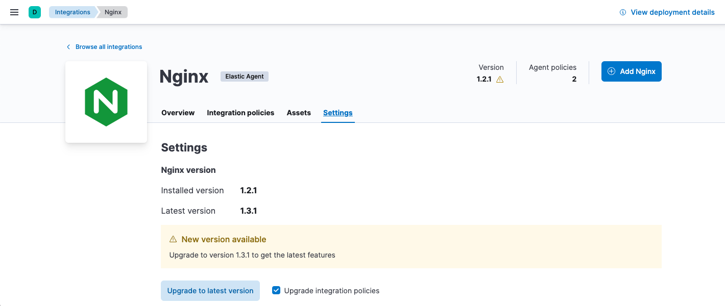

edit- In Kibana, go to Management > Integrations > Installed integrations. Search for and select the integration you want to upgrade. Notice there is a warning icon next to the version number to indicate a new version is available.
Click the Settings tab and notice the message about the new version.
Before upgrading the integration, decide whether to upgrade integration policies to the latest version, too. To use new features and capabilities, you’ll need to upgrade existing integration policies. However, the upgrade may introduce changes, such as field changes, that require you to resolve conflicts.
- Select Upgrade integration policies to upgrade any eligible integration policies when the integration is upgraded.
- To continue using the older package version, deselect Upgrade integration policies. You can still choose to upgrade integration policies manually later on.
Click Upgrade to latest version.
If you selected Upgrade integration policies and there are conflicts, upgrade integration policies manually and resolve the conflicts in the policy editor.
- After the upgrade is complete, verify that the installed version and latest version match.

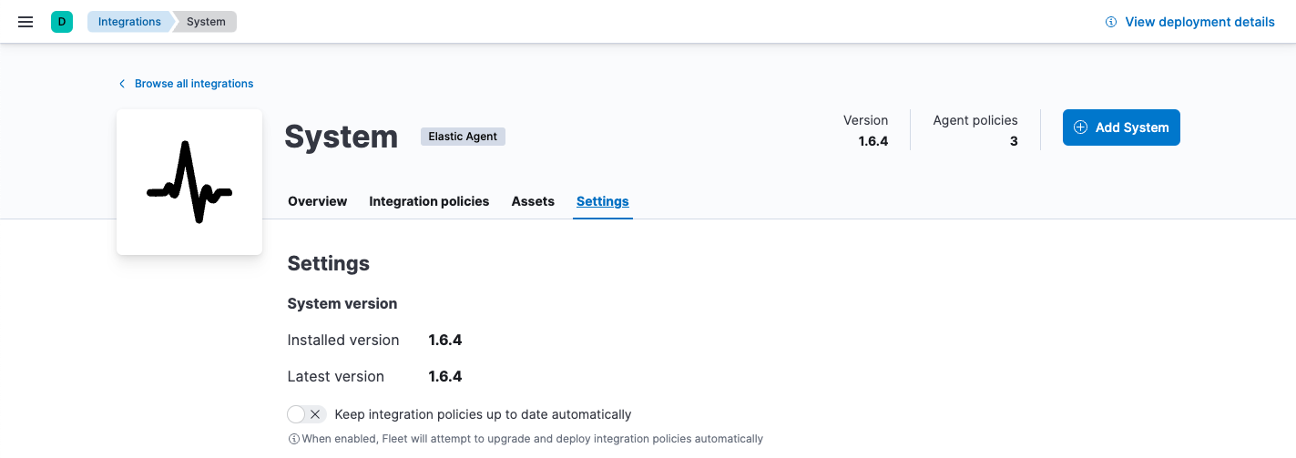

Keep integration policies up to date automatically
editSome integration packages, like System, are installed by default during Fleet setup. These integrations are upgraded automatically when Fleet detects that a new version is available. These integrations have an option to upgrade integration policies automatically, too. When this option is selected (the default), Fleet automatically upgrades your policies behind the scenes when a new version of the integration is available. If there are conflicts during the upgrade, your integration policies will not be upgraded, and you’ll need to upgrade integration policies manually.
To keep integration policies up to data automatically:
- In Kibana, go to Management > Integrations > Installed Integrations. Search for and select the integration you want to configure.
Click Settings and make sure Keep integration policies up to data automatically is selected.
If this option isn’t available on the Settings tab, this feature is not available for the integration you’re viewing.

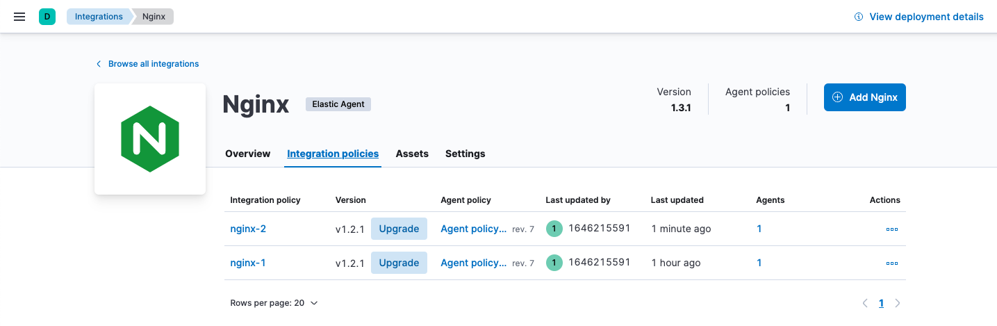

Upgrade integration policies manually
editIf you can’t upgrade integration policies when you upgrade the integration, upgrade them manually.
Click the Policies tab and find the integration policies you want to upgrade.

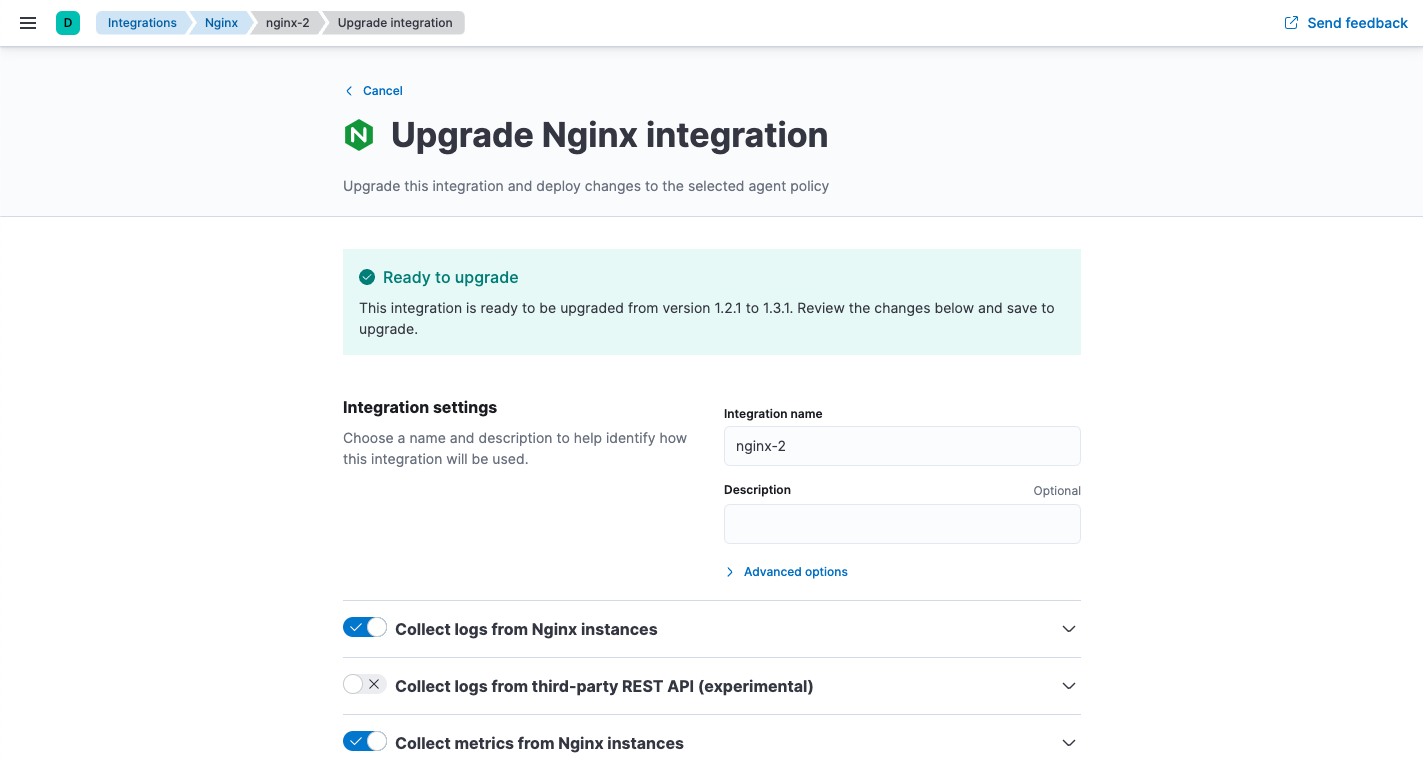

Click Upgrade to begin the upgrade process.
The upgrade will open in the policy editor.
- Make any required configuration changes and, if necessary, resolve conflicts. For more information, refer to Resolve conflicts.

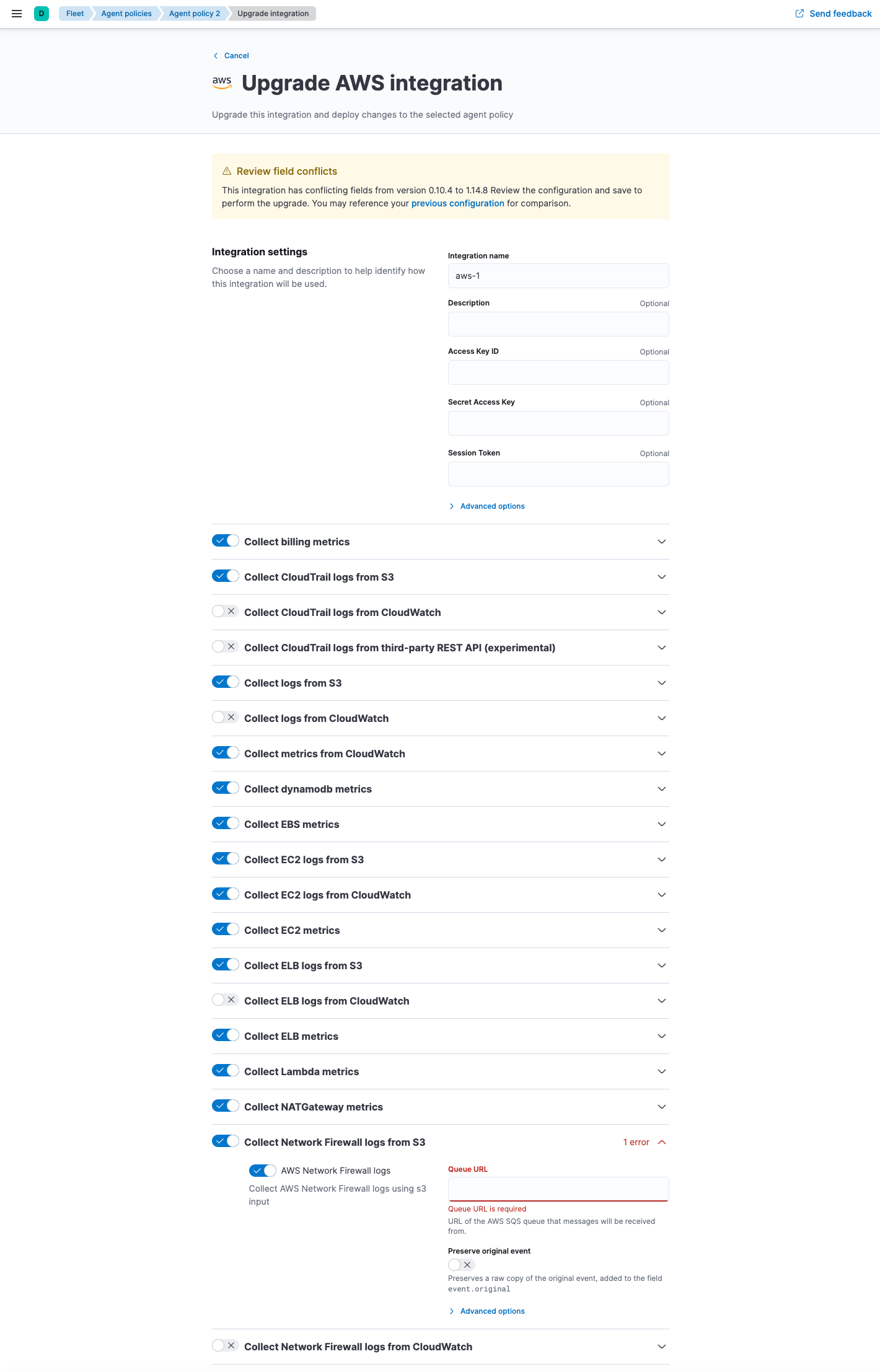

Resolve conflicts
editWhen attempting to upgrade an integration policy, it’s possible that breaking changes or conflicts exist between versions of an integration. For example, if a new version of an integration has a required field and doesn’t specify a default value, Fleet cannot perform the upgrade without user input. Conflicts are also likely if an experimental package greatly restructures its fields and configuration settings between releases.
If Fleet detects a conflict while automatically upgrading an integration policy, it will not attempt to upgrade it. You’ll need to:
- Upgrade the integration policy manually.
Use the policy editor to fix any conflicts or errors.

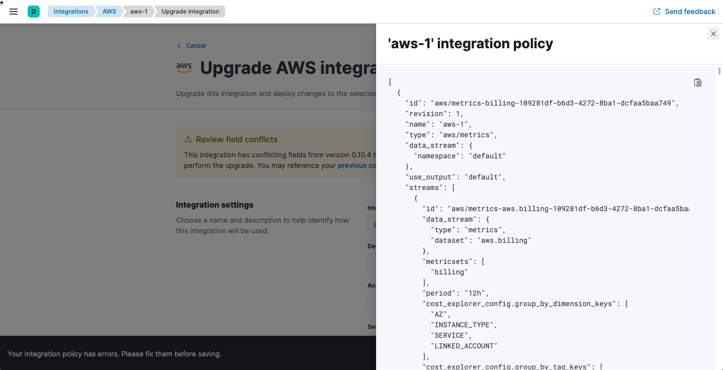

Under Review field conflicts, notice that you can click previous configuration to view the raw JSON representation of the old integration policy and compare values. This feature is useful when fields have been deprecated or removed between releases.
- In the policy editor, fix any errors and click Upgrade integration.
