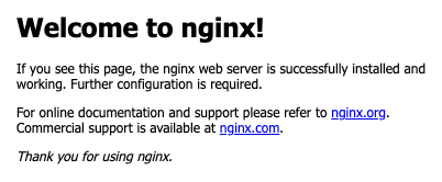

Run the following command on an Ubuntu Linux host, or refer to the nginx install documentation for the command appropriate to your operating system.
sudo apt install nginx
Open a web browser and visit your host machine’s external URL, for example
http://192.168.64.17/
. You should see the nginx welcome message.

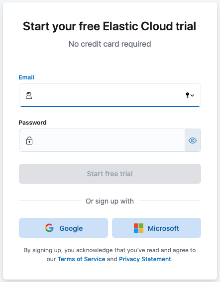

Now that your web server is running, let’s get set up to monitor it in Elastic Cloud. An Elastic Cloud deployment offers you all of the features of the Elastic Stack as a hosted service. To test drive your first deployment, sign up for a free Elastic Cloud trial:
- Go to our Elastic Cloud Trial page.
Enter your email address and a password.

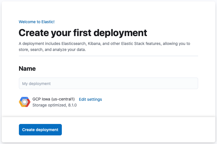

After you’ve logged in, you can create a deployment. Give your deployment a name and select Create deployment.
While the deployment sets up, make a note of your
elastic
superuser password and keep it in a safe place. - Once the deployment is ready, select Continue. At this point, you access Kibana and a selection of setup guides.

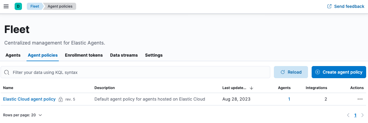

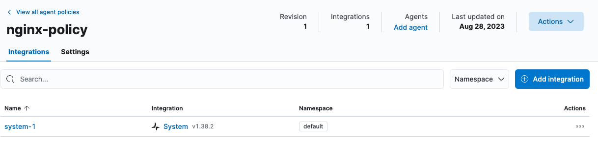

When your Elastic Cloud deployment is ready, open the Kibana menu and go to Fleet → Agent policies.

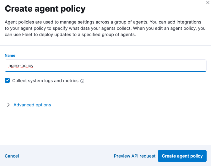

- Click Create agent policy.
Give your policy a name. For this example we’ll call it
nginx-policy
. - Leave Collect system logs and metrics selected.
Step 4: Add the Nginx Integration
editElastic integrations are a streamlined way to connect your data from popular services and platforms to the Elastic Stack, including nginx.
From the Fleet → Agent policies tab, click the link for your new
nginx-policy
Note that
system-
integration is included because you opted earlier to collect system logs and metrics. - Click Add integration.

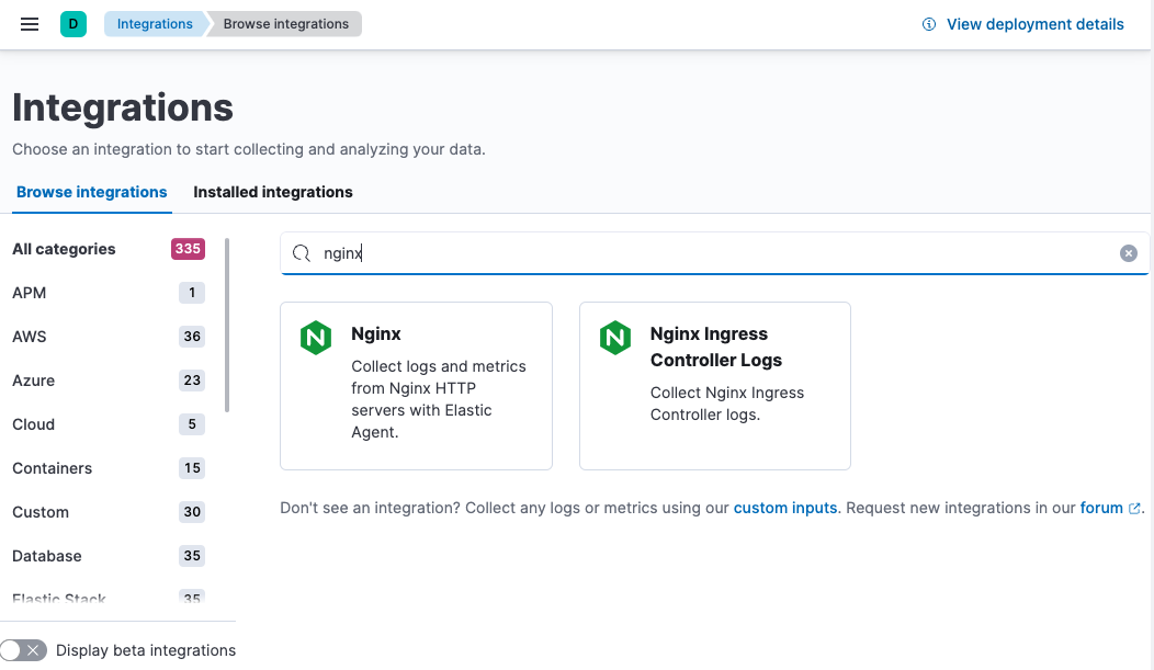

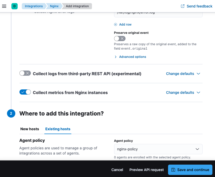

On the Integrations page search for "nginx".
- Select the Nginx card.
- Click Add Nginx.
- Click the link to Add integration only (skip agent installation). You’ll install standalone Elastic Agent in a later step.
Here, you can select options such as the paths to where your nginx logs are stored, whether or not to collect metrics data, and various other settings.

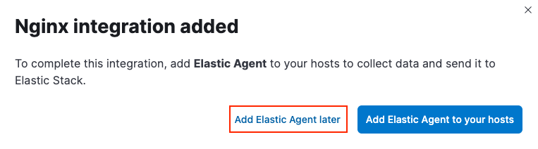

For now, leave all of the default settings and click Save and continue to add the Nginx Integration to your
nginx-policy
policy. -
In the confirmation dialog, select to Add Elastic Agent later.

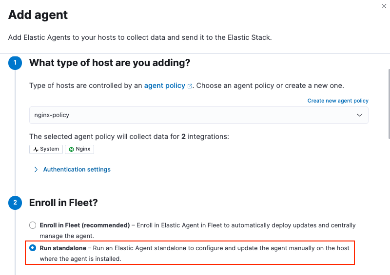

- Open the Kibana menu and go to Fleet → Agents and click Add agent.
For the What type of host are you adding? step, select
nginx-policy
from the drop-down menu if it’s not already selected. -
For the Enroll in Fleet? step, select Run standalone.

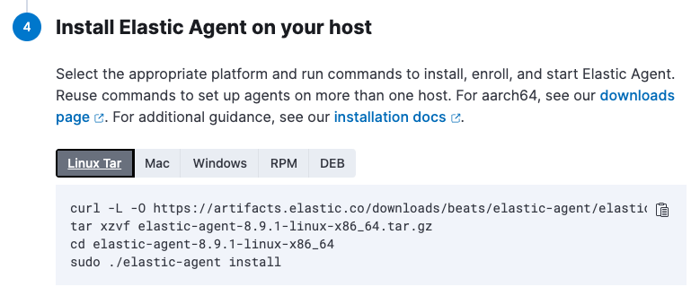

For the Install Elastic Agent on your host step, select the tab for your host operating system and run the commands on your host.
Elastic Agent commands need to be run as
root
. You can prefix each agent command withsudo
or you can start a new shell asroot
by runningsudo su

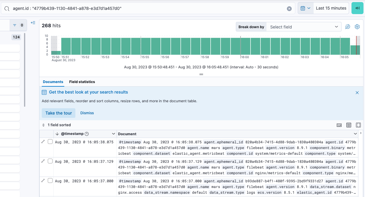

editNow that Elastic Agent is running, it’s time to confirm that the agent data is flowing into Elasticsearch.
Check that Elastic Agent logs are flowing.
- Open the Kibana menu and go to Analytics → Discover.
In the KQL query bar, enter the query
agent.id : "{agent-id}"
where{agent-id}
is the ID you retrieved from theelastic-agent status --output yaml
command. For example:agent.id : "4779b439-1130-4841-a878-e3d7d1a457d0"
.If Elastic Agent has connected successfully with your Elastic Cloud deployment, the agent logs should be flowing into Elasticsearch and visible in Kibana Discover.

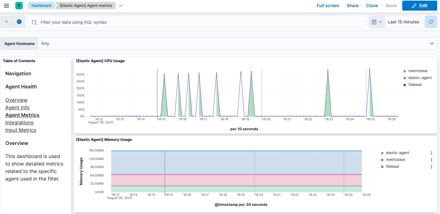

Check that Elastic Agent metrics are flowing.
- Open the Kibana menu and go to Analytics → Dashboard.
In the search field, search for
Elastic Agent
and select[Elastic Agent] Agent metrics
in the results.like the agent logs, the agent metrics should be flowing into Elasticsearch and visible in Kibana Dashboard. You can view metrics on CPU usage, memory usage, open handles, events rate, and more.

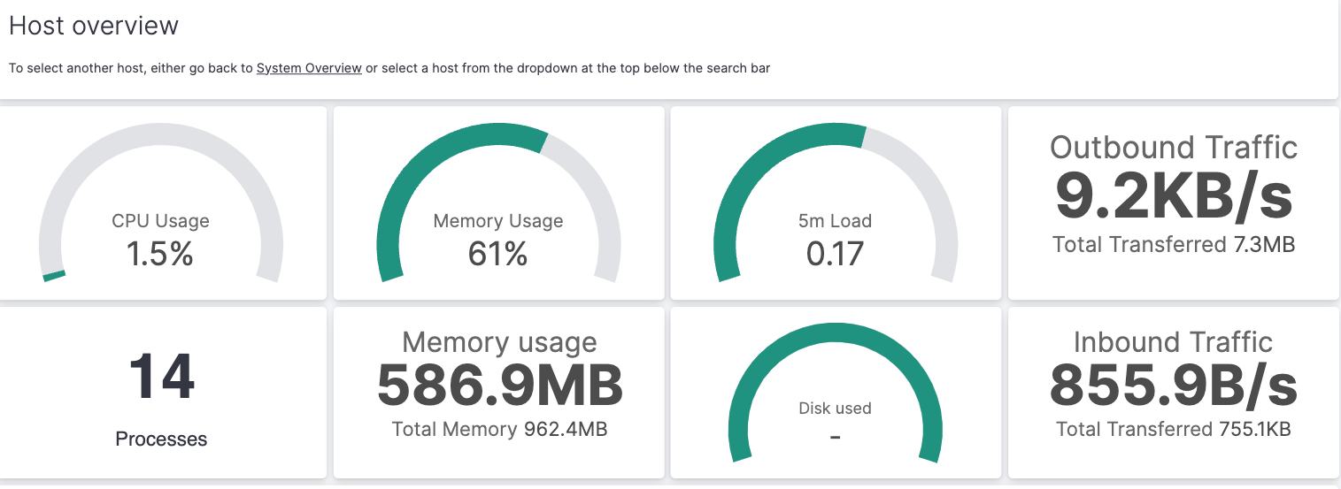

View your system metrics.
- Return to Management → Integrations → Installed integrations.
- Select the System card and open the Assets tab.
Select
[Metrics System] Host overview
. The Kibana Dashboard opens with visualizations of host metrics including CPU usage, memory usage, running processes, and others.

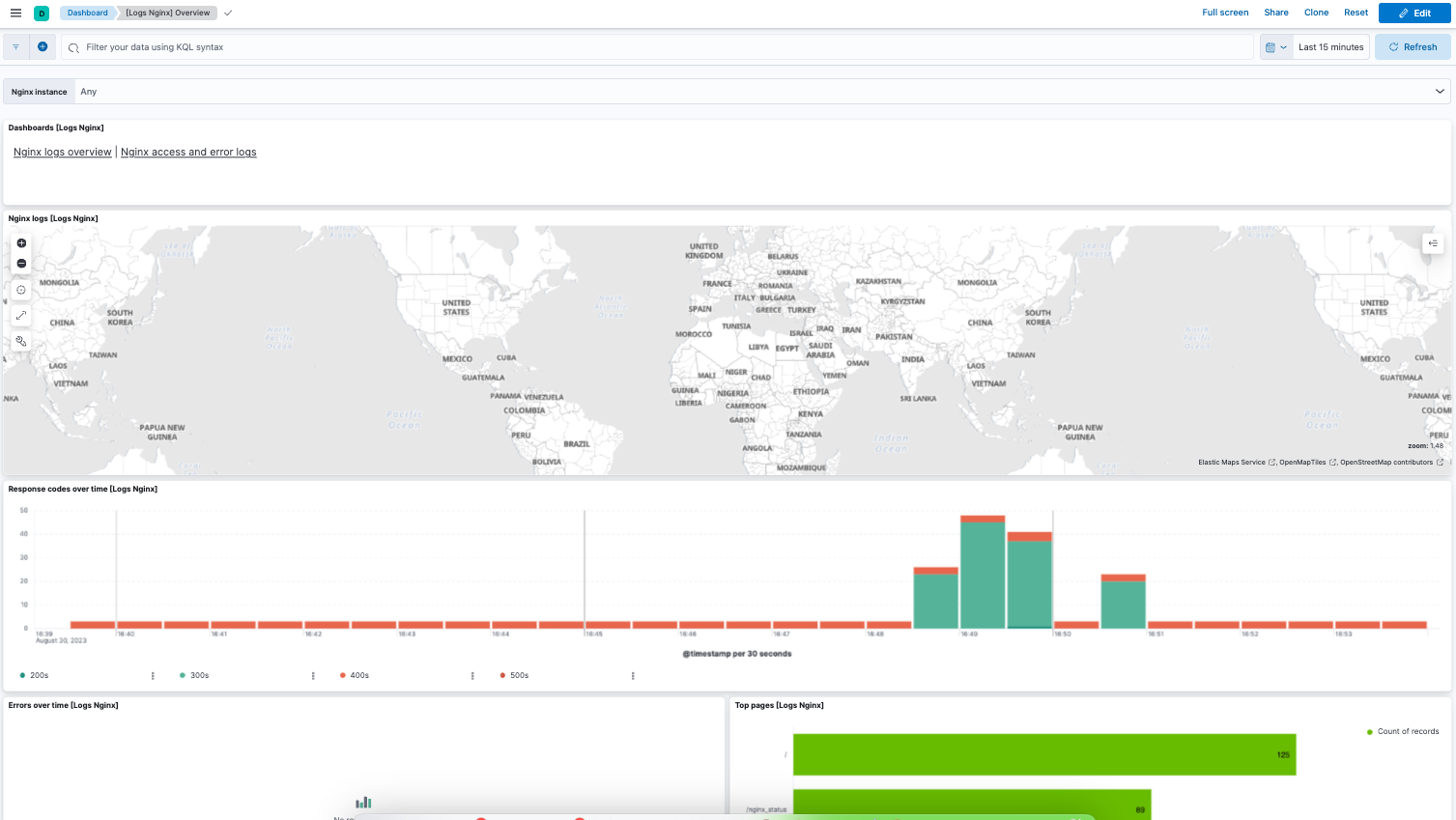

Step 8: View your nginx logging data
editNow let’s view your nginx logging data.
- Open the Kibana menu and go to Management → Integrations → Installed integrations.
- Select the Nginx card and open the Assets tab.

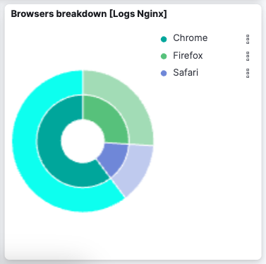

Select
[Logs Nginx] Overview
. The Kibana Dashboard opens with geographical log details, response codes and errors over time, top pages, and more. -
Refresh your nginx web page several times to update the logging data. You can also try accessing the nginx page from different web browsers. After a minute or so, the
Browsers breakdown
visualization shows the respective volume of requests from the different browser types.
