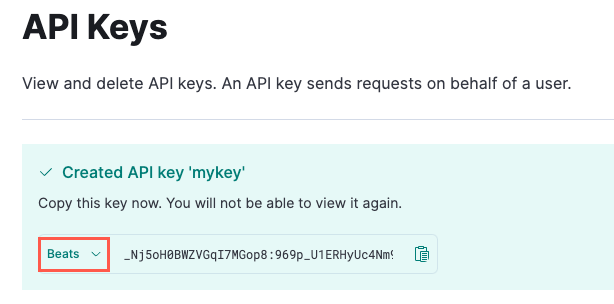

- In Kibana, navigate to Stack Management > API keys and click Create API key.
Enter a name for your API key and select Restrict privileges. In the role descriptors box, copy and paste the following JSON. This example creates an API key with privileges for ingesting logs, metrics, traces, and synthetics:
- To set an expiration date for the API key, select Expire after time and input the lifetime of the API key in days.
Click Create API key.
You’ll see a message indicating that the key was created, along with the encoded key. By default, the API key is Base64 encoded, but that won’t work for Elastic Agent.
Click the down arrow next to Base64 and select Beats.
- Copy the API key. You will need this for the next step, and you will not be able to view it again.

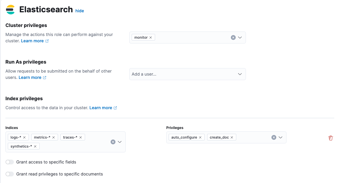

- In Kibana, go to Stack Management > Roles.
- Click Create role and enter a name for the role.
In Cluster privileges, enter
monitor
In Index privileges, enter:
logs-*-*
,metrics-*-*
,traces-*-*
andsynthetics-*-*
in the Indices field.Adjust this list to match the data you want to collect. For example, if you aren’t using APM or synthetics, remove
traces-*-*
andsynthetics-*-*
from this list. -
auto_configure
andcreate_doc
in the Privileges field.
- Create the role and assign it to a user. For more information about creating roles, refer to Kibana role management.
