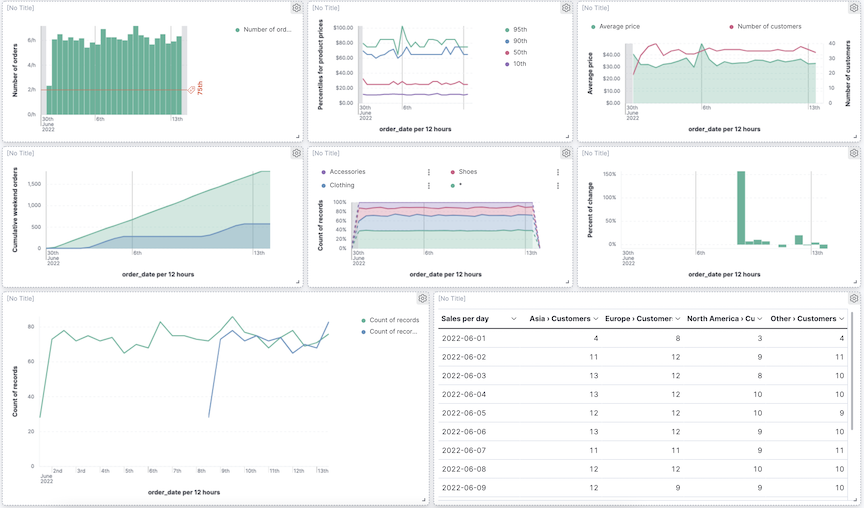

Add the data and create the dashboard
editAdd the sample ecommerce data, and create and set up the dashboard.
- On the home page, click Try sample data.
- Click Other sample data sets.
- On the Sample eCommerce orders card, click Add data.
Create the dashboard where you’ll display the visualization panels.
- Open the main menu, then click Dashboard.
- On the Dashboards page, click Create dashboard.
Open and set up the visualization editor
editOpen the visualization editor, then make sure the correct fields appear.
- On the dashboard, click Create visualization.
- Make sure the Kibana Sample Data eCommerce data view appears, then set the time filter to Last 30 days.

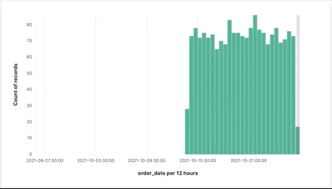

To analyze the data with a custom time interval, create a bar chart that shows you how many orders were made at your store every hour:
From the Available fields list, drag Records to the workspace.
The visualization editor creates a bar chart.
To zoom in on the data, click and drag your cursor across the bars.
In the layer pane, click Count of Records.
- Click Advanced.
From the Normalize by unit dropdown, select per hour, then click Close.
Normalize by unit converts
Count of Records
intoCount of records per hour
by dividing by 24. -
In the Name field, enter
Number of orders
. - Click Close.
- To hide the Horizontal axis label, open the Bottom Axis menu, then select None from the Axis title dropdown.

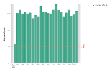

To identify the 75th percentile of orders, add a reference line:
- In the layer pane, click Add layer > Reference lines.
Click Static value.
- Click Quick function, then click Percentile.
- From the Field dropdown, select total_quantity.
In the Reference line value field, enter
75
Configure the Appearance options.
75th
. - To display the name, select Name from Text decoration.
- From the Icon dropdown, select Tag.
In the Color field, enter
#E7664C
Click Close.
- Click Save and return.

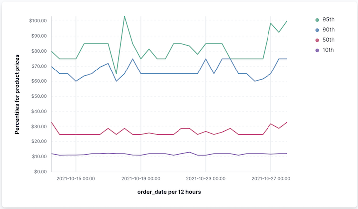

editYou can create visualizations with multiple data series within the same time interval, even when the series have similar configurations with minor differences.
To analyze multiple series, create a line chart that displays the price distribution of products sold over time:
- Open the Visualization type dropdown, then select Line.
- From the Available fields list, drag products.price to the workspace.
Create the 95th price distribution percentile:
- In the layer pane, click Median of products.price.
- Click the Percentile function.
95th
, then click Close.

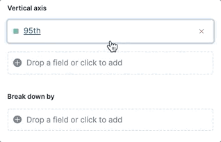

To copy a function, you drag it to the Drop a field or click to add field within the same group. To create the 90th percentile, duplicate the 95th
percentile:
Drag the 95th field to Add or drag-and-drop a field for Vertical axis.
Click 95th [1], then enter
90
in the Percentile field. -
In the Name field enter
90th
, then click Close. -
To create the
50th
and10th
percentiles, repeat the duplication steps. -
Open the Left Axis menu, select Custom from the Axis title dropdown, then enter
Percentiles for product prices
in the Axis title field. - Click Save and return.

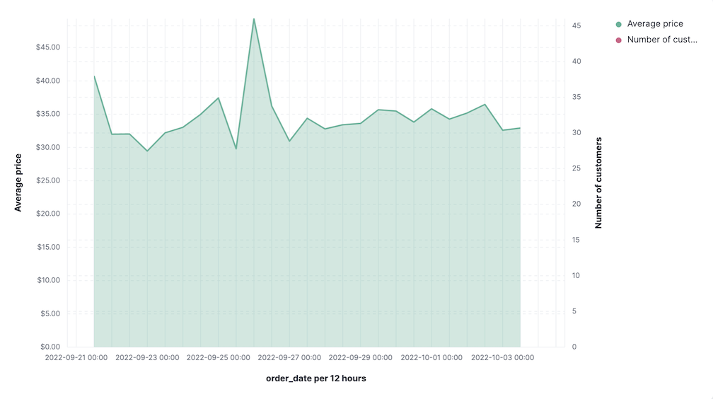

editWith layers, you can analyze your data with multiple visualization types. When you create layered visualizations, match the data on the horizontal axis so that it uses the same scale.

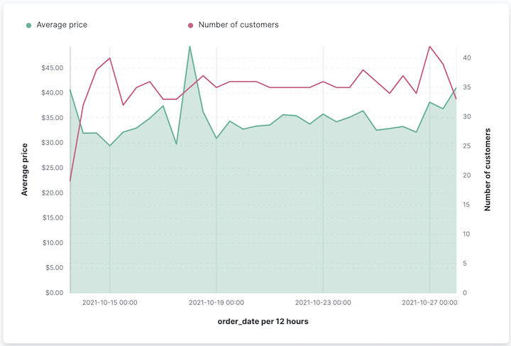

To analyze multiple visualization types, create an area chart that displays the average order prices, then add a line chart layer that displays the number of customers.
- Click the Average function.
Average price
, then click Close.
- Open the Visualization type dropdown, then select Area.
Add a layer to display the customer traffic:
- In the layer pane, click Add layer > Visualization.
- From the Available fields list, drag customer_id to the Vertical Axis field in the second layer.
In the layer pane, click Unique count of customer_id.
Number of customers
In the Series color field, enter
#D36086
Click Right for the Axis side, then click Close.
- From the Available fields list, drag order_date to the Horizontal Axis field in the second layer.
In the second layer, open the Layer visualization type menu, then click Line.
To change the position of the legend, open the Legend menu, then select the Alignment arrow that points up.

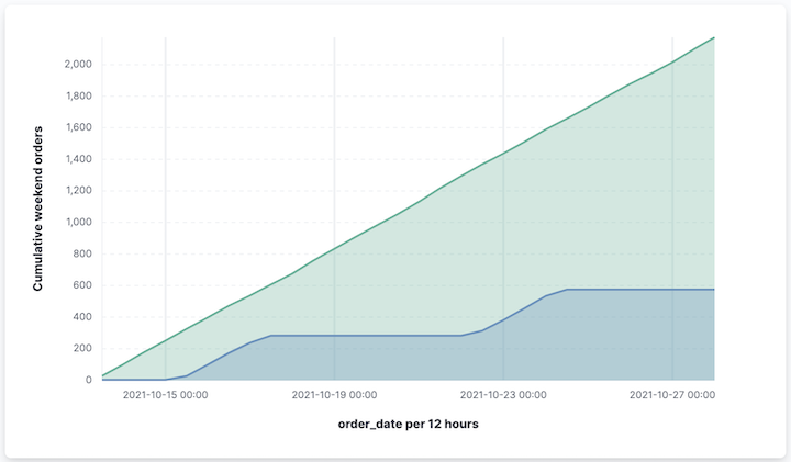

editTo determine the number of orders made only on Saturday and Sunday, create an area chart, then add it to the dashboard.
Configure the cumulative sum of store orders:
- From the Available fields list, drag Records to the workspace.
- In the layer pane, click Count of Records.
- Click the Cumulative sum function.
Cumulative weekend orders
, then click Close.
Filter the results to display the data for only Saturday and Sunday:
- In the layer pane, click Add or drag-and-drop a field for Breakdown.
- Click the Filters function.
Click All records, enter the following in the query bar, then press Return:
KQL —
day_of_week : "Saturday" or day_of_week : "Sunday"
Label —
Saturday and Sunday
The KQL filter displays all documents where
day_of_week
matchesSaturday
orSunday
KQL —
Open the Legend menu, then click Hide next to Display.

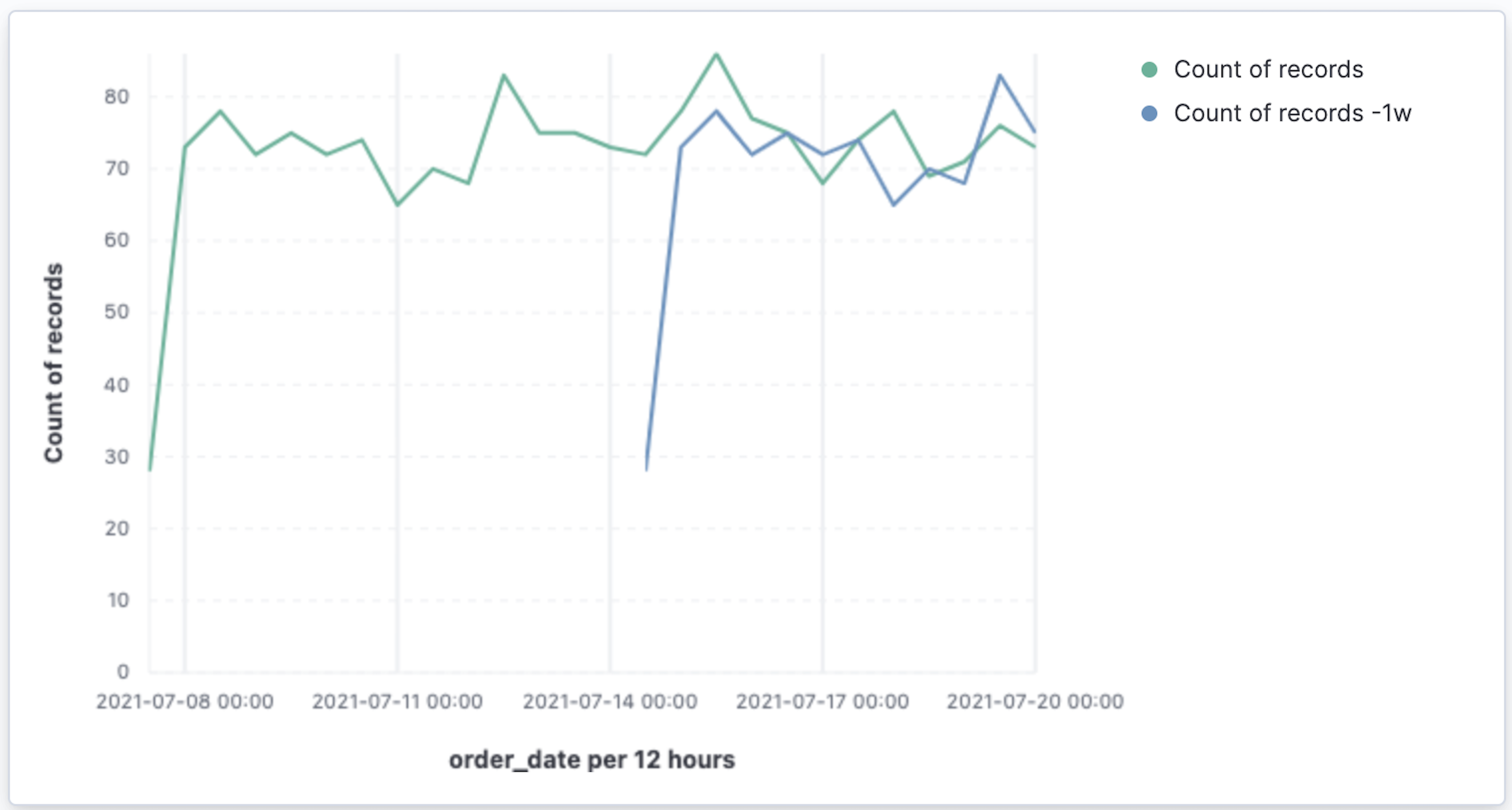

editWith Time shift, you can compare the data from different time ranges. To make sure the data correctly displays, choose a multiple of the date histogram interval when you use multiple time shifts. For example, you are unable to use a 36h time shift for one series, and a 1d time shift for the second series if the interval is days.
To compare two time ranges, create a line chart that compares the sales in the current week with sales from the previous week:
- To duplicate Count of Records, drag Count of Records to Add or drag-and-drop a field for Vertical axis in the layer pane.
To create a week-over-week comparison, shift Count of Records [1] by one week:
- In the layer pane, click Count of Records [1].
Click Advanced, select 1 week ago from the Time shift dropdown, then click Close.
To use custom time shifts, enter the time value and increment, then press Enter. For example, enter 1w to use the 1 week ago time shift.

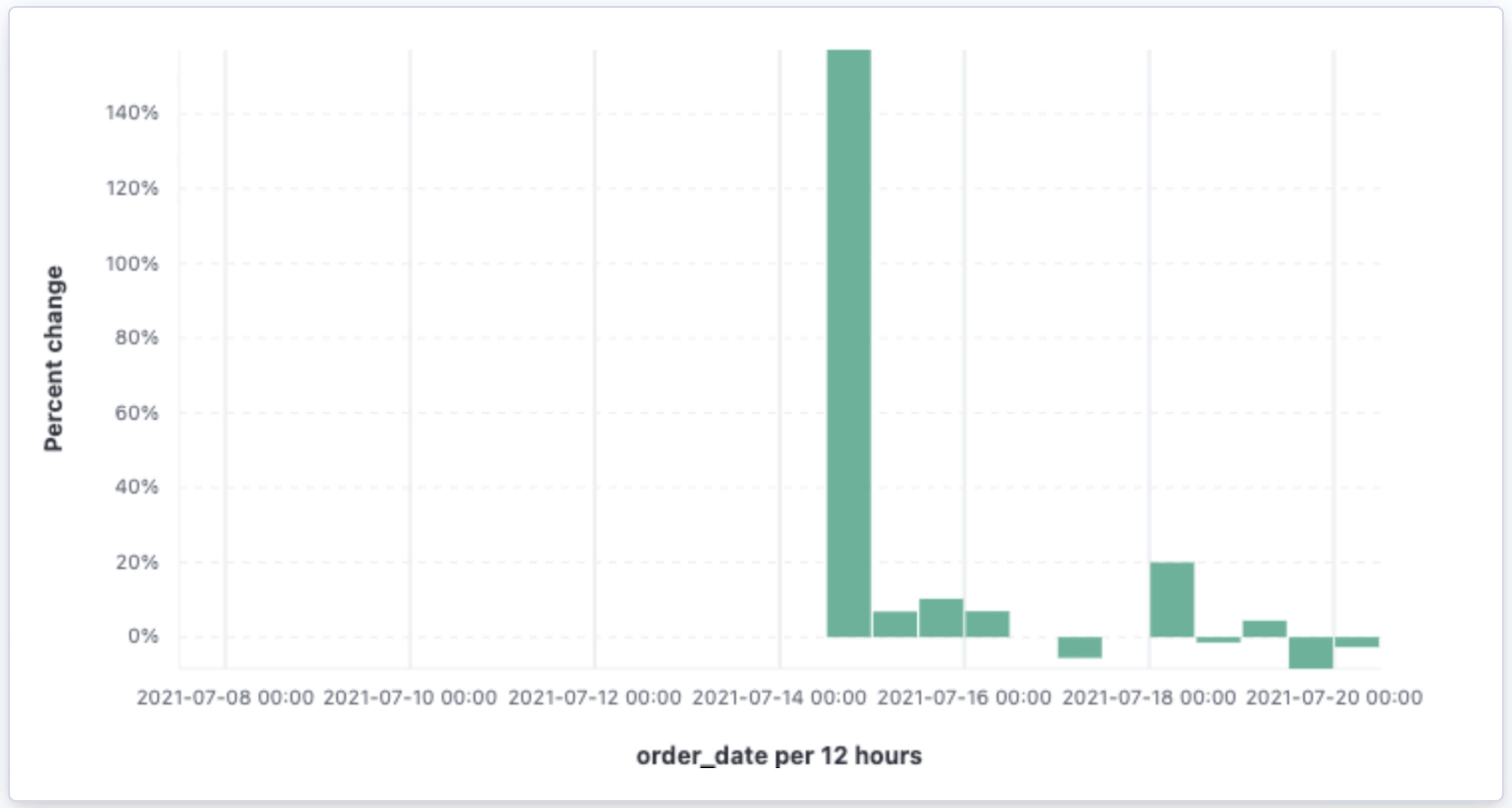

editWith Formula, you can analyze the percent change in your data from different time ranges.
To compare time range changes as a percent, create a bar chart that compares the sales in the current week with sales from the previous week:
Click Formula, then enter
count() / count(shift='1w') - 1
Percent of change
From the Value format dropdown, select Percent, then enter
0
in the Decimals field. -
Click Close.

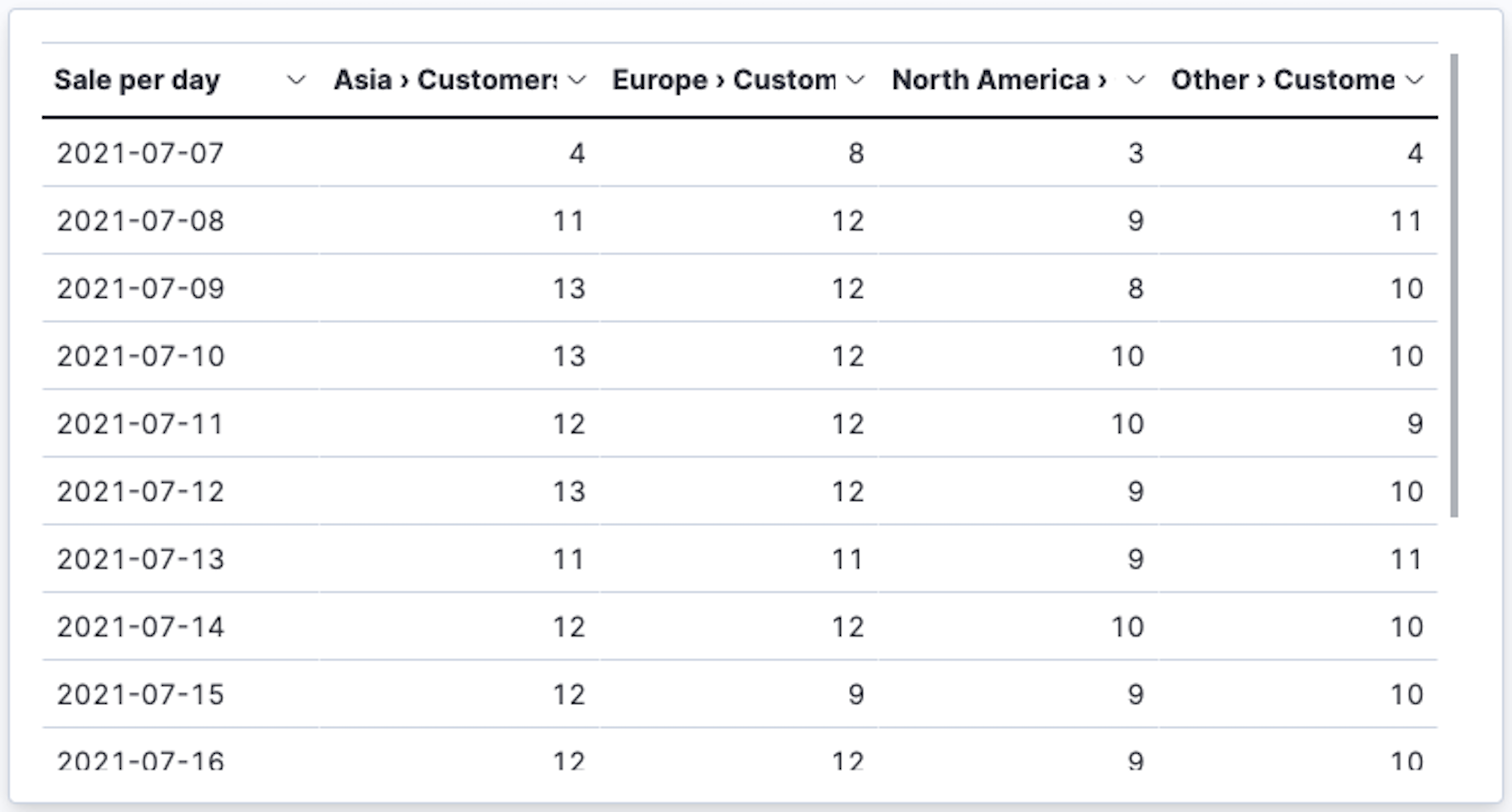

Analyze the data in a table
editWith tables, you can view and compare the field values, which is useful for displaying the locations of customer orders.
Create a date histogram table and group the customer count metric by category, such as the continent registered in user accounts:
- Open the Visualization type dropdown, then select Table.
From the Available fields list, drag customer_id to the Metrics field in the layer pane.
- In the layer pane, click Unique count of customer_id.
Customers
, then click Close.
From the Available fields list, drag order_date to the Rows field in the layer pane.
- In the layer pane, click the order_date.
- In the Minimum interval field, enter 1d.
Sales
, then click Close.
To split the metric, add columns for each continent using the Columns field:
From the Available fields list, drag geoip.continent_name to the Split metrics by field in the layer pane.

- In the toolbar, click Save.
On the Save dashboard window, enter
Ecommerce sales
, then click Save. - Select Store time with dashboard.
- Click Save.
