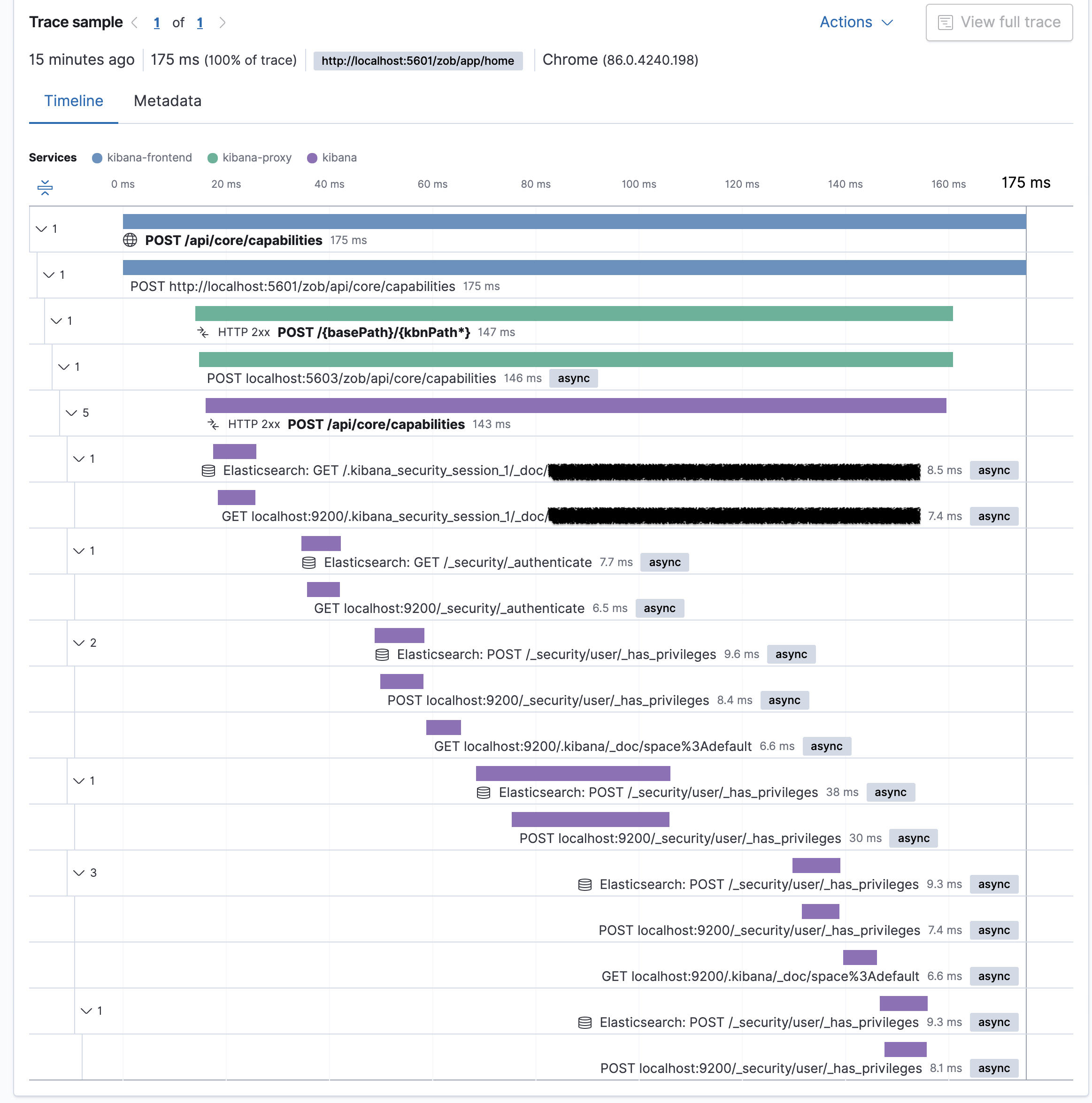

Once the agent is active, it will trace all incoming HTTP requests to Kibana, monitor for errors, and collect process-level metrics. The collected data will be sent to the APM Server and is viewable in the APM UI in Kibana.

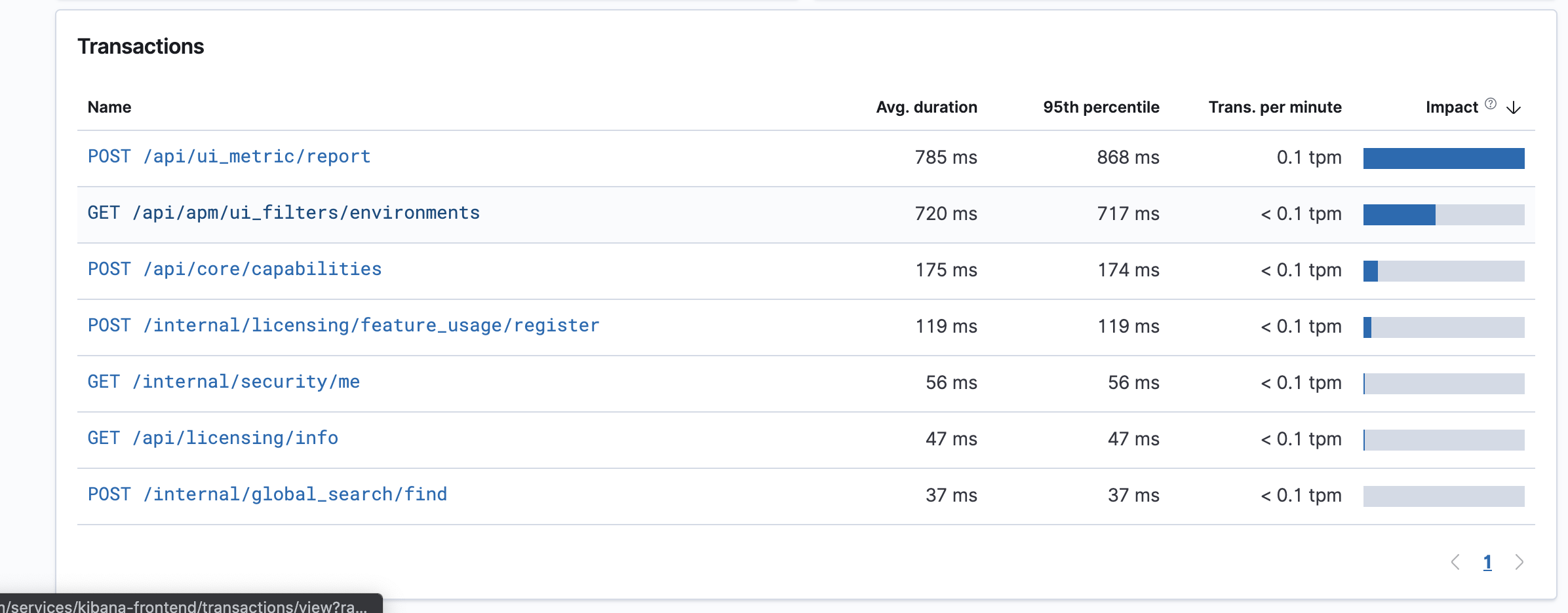

- After Kibana starts up, navigate to the APM app, where you should see some transactions.
