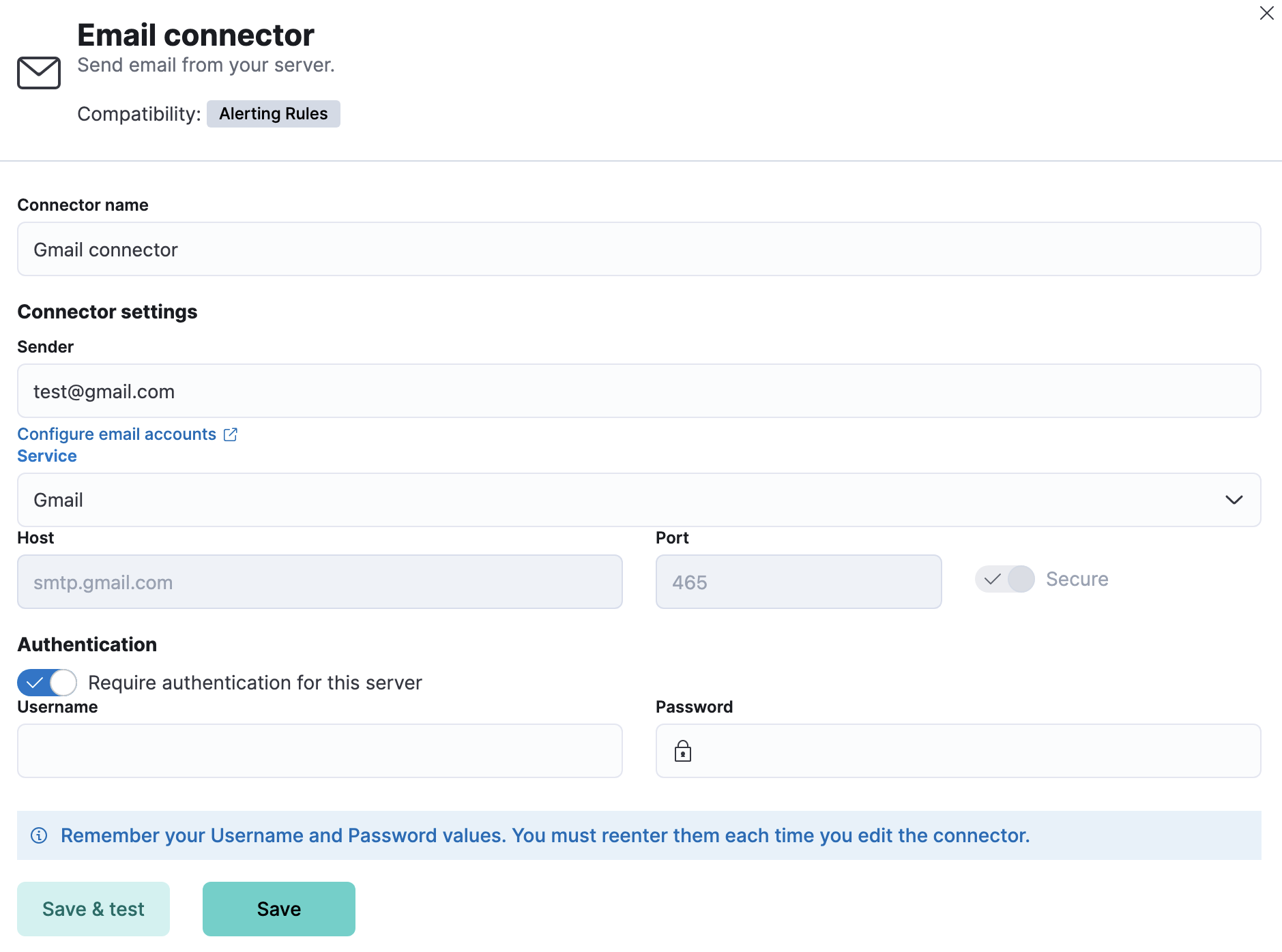

Connector configuration
editEmail connectors have the following configuration properties:
- Name
- Sender
The from address for all emails sent with this connector. This must be specified
in
user@host-name
format. See the Nodemailer address documentation for more information. - Service
The name of the email service. If
service
is one of Nodemailer’s well-known email service providers, thehost
,port
, andsecure
properties are defined with the default values and disabled for modification. Ifservice
isMS Exchange Server
, thehost
,port
, andsecure
properties are ignored andtenantId
,clientId
,clientSecret
are required instead. Ifservice
isother
, thehost
andport
properties must be defined. - Host
Host name of the service provider. If you are using the
xpack.actions.allowedHosts
setting, make sure this hostname is added to the allowed hosts. - Port
- The port to connect to on the service provider.
- Secure
- If true, the connection will use TLS when connecting to the service provider. Refer to the Nodemailer TLS documentation for more information. If not true, the connection will initially connect over TCP, then attempt to switch to TLS via the SMTP STARTTLS command.
- Tenant ID
- The directory tenant that the application plans to operate against, in GUID format.
- Client ID
- The application ID that is assigned to your app, in GUID format. You can find this information in the portal where you registered your app.
- Client Secret
- The client secret that you generated for your app in the app registration portal. The client secret must be URL-encoded before being sent. The Basic auth pattern of providing credentials in the Authorization header, per RFC 6749, is also supported.
- Require authentication
- If true, a username and password for login type authentication must be provided.
- Username
- Username for login type authentication.
- Password
- Password for login type authentication.

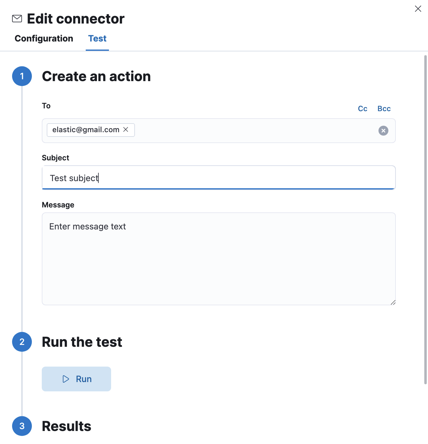

Test connectors
editYou can test connectors with the run connector API or as you’re creating or editing the connector in Kibana. For example:
Email actions have the following configuration properties.
- To, CC, BCC
Each item is a list of addresses. Addresses can be specified in
user@host-name
format, or inname <user@host-name>
format. One of To, CC, or BCC must contain an entry. - Subject
- The subject line of the email.
- Message
- The message text of the email. Markdown format is supported.

Configure email accounts for well-known services
editThe email connector can send email using many popular SMTP email services and the Microsoft Exchange Graph API.
For more information about configuring the email connector to work with different email systems, refer to:
For other email servers, you can check the list of well-known services that
Nodemailer supports in the JSON file
well-known/services.json.
The properties of the objects in those files — host
, port
, and
secure
— correspond to the same email connector configuration
properties. A missing secure
property in the "well-known/services.json" file
is considered false
. Typically, port: 465
uses secure: true
, and
port: 25
and port: 587
use secure: false

Sending email from Gmail
editUse the following email connector configuration to send email from the Gmail SMTP service:
config: service: gmail // `host`, `port` and `secure` have the following default values and do not need to set: // host: smtp.gmail.com // port: 465 // secure: true secrets: user: <username> password: <password>
If you get an authentication error that indicates that you need to continue the sign-in process from a web browser when the action attempts to send email, you need to configure Gmail to allow less secure apps to access your account.
If two-step verification is enabled for your account, you must generate and use a unique App Password to send email from Kibana. See Sign in using App Passwords for more information.

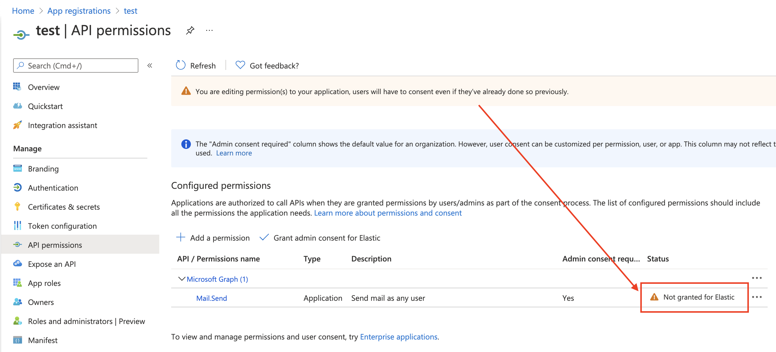

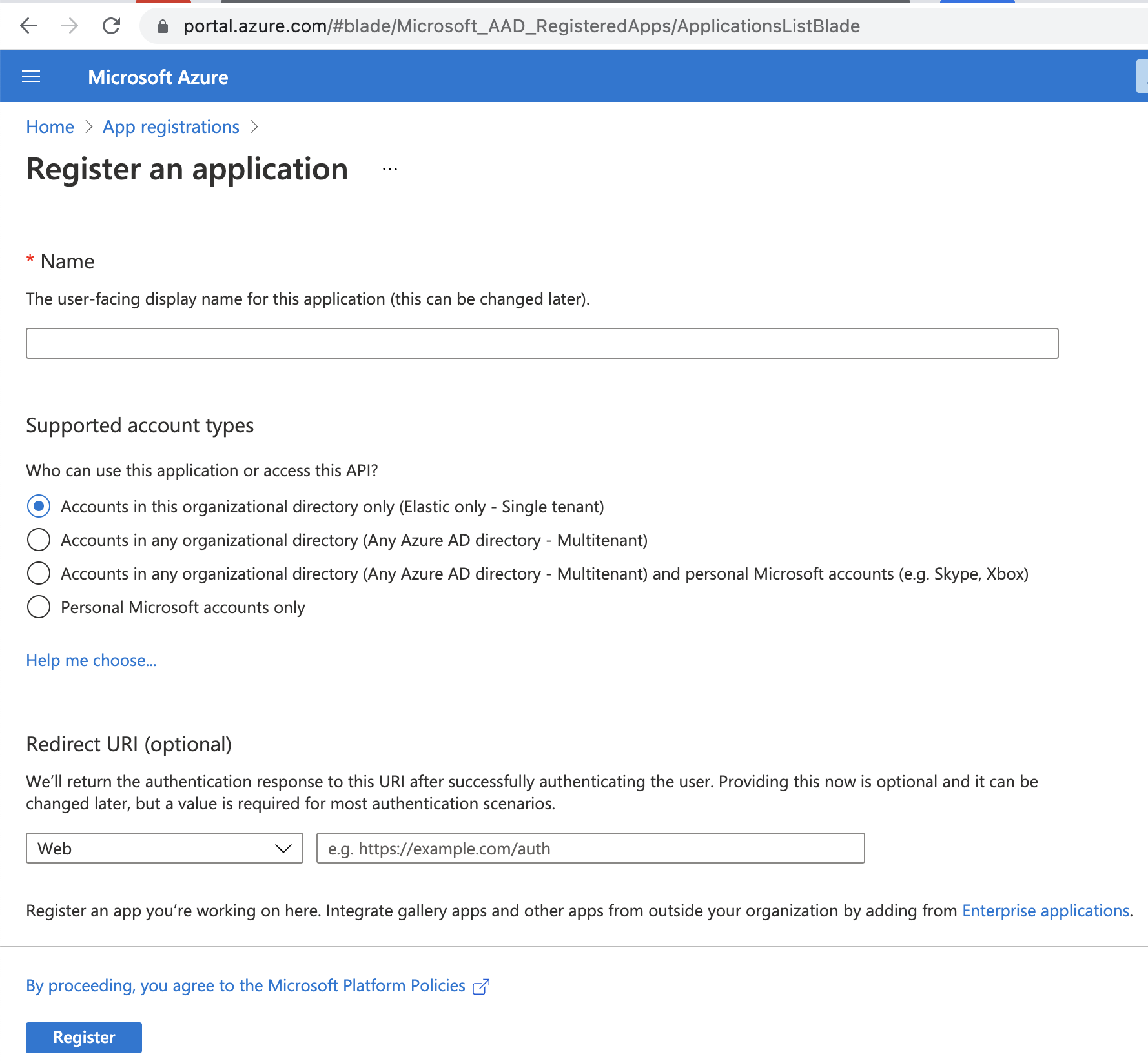

editBefore you create an email connector for Microsoft Exchange, you must create and register the client integration application on the Azure portal:

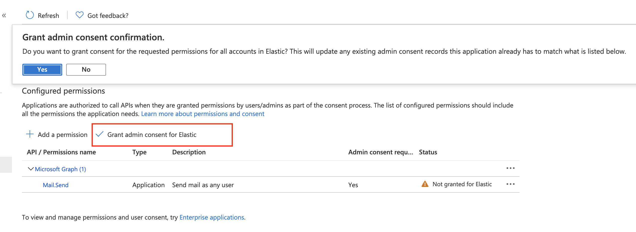

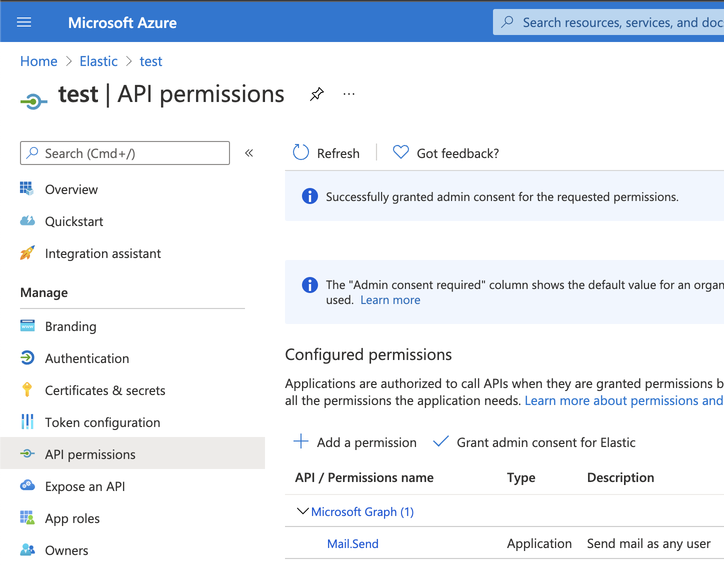

Next, open Manage > API permissions, and then define the permissions for the registered application to send emails. Refer to the documentation for the Microsoft Graph API.

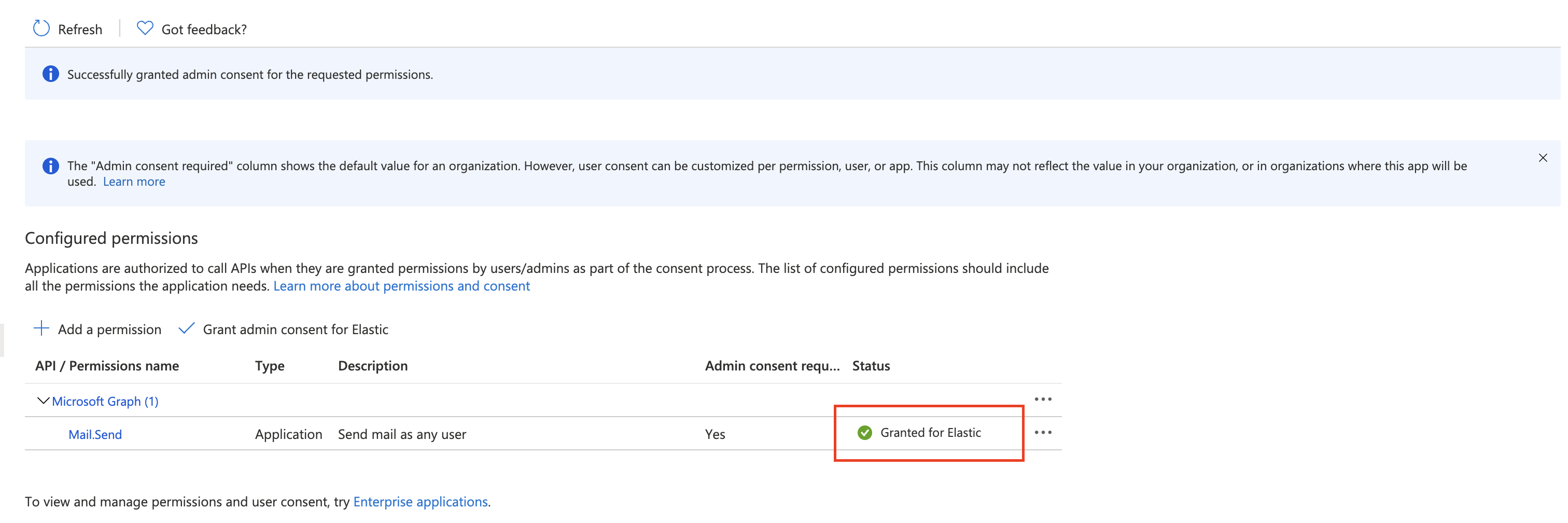

Add the "Mail.Send" permission for Microsoft Graph. The permission appears in the list with the status "Not granted for <your Azure active directory>":
Click Grant admin consent for <your Azure active directory>.
Confirm that the status for the "Mail.Send" permission is now granted.

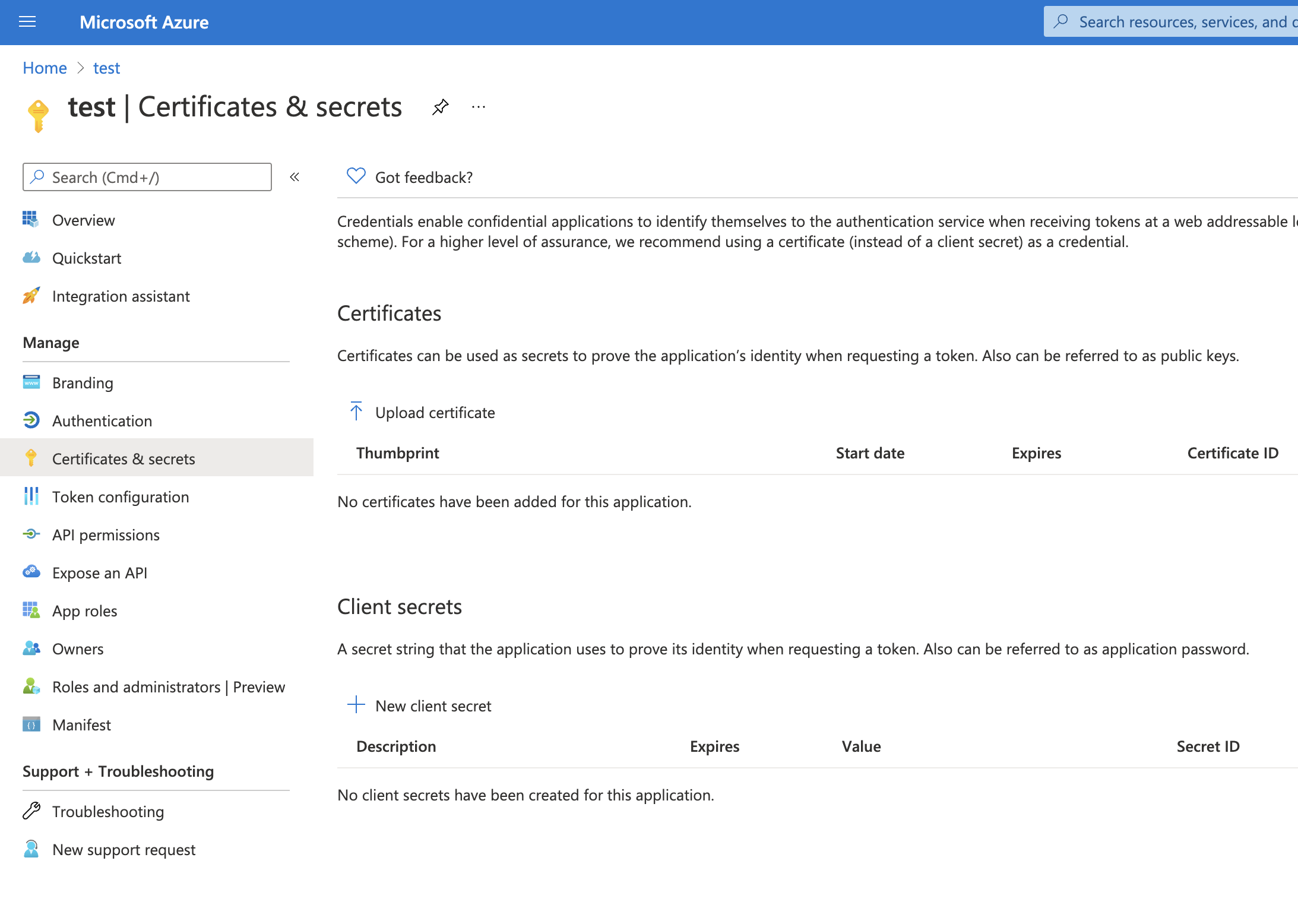

Configure Microsoft Exchange Client secret
editTo configure the Client secret , open Manage > Certificates & secrets.
Add a new client secret, then copy the value and put it to the proper field in the Microsoft Exchange email connector.

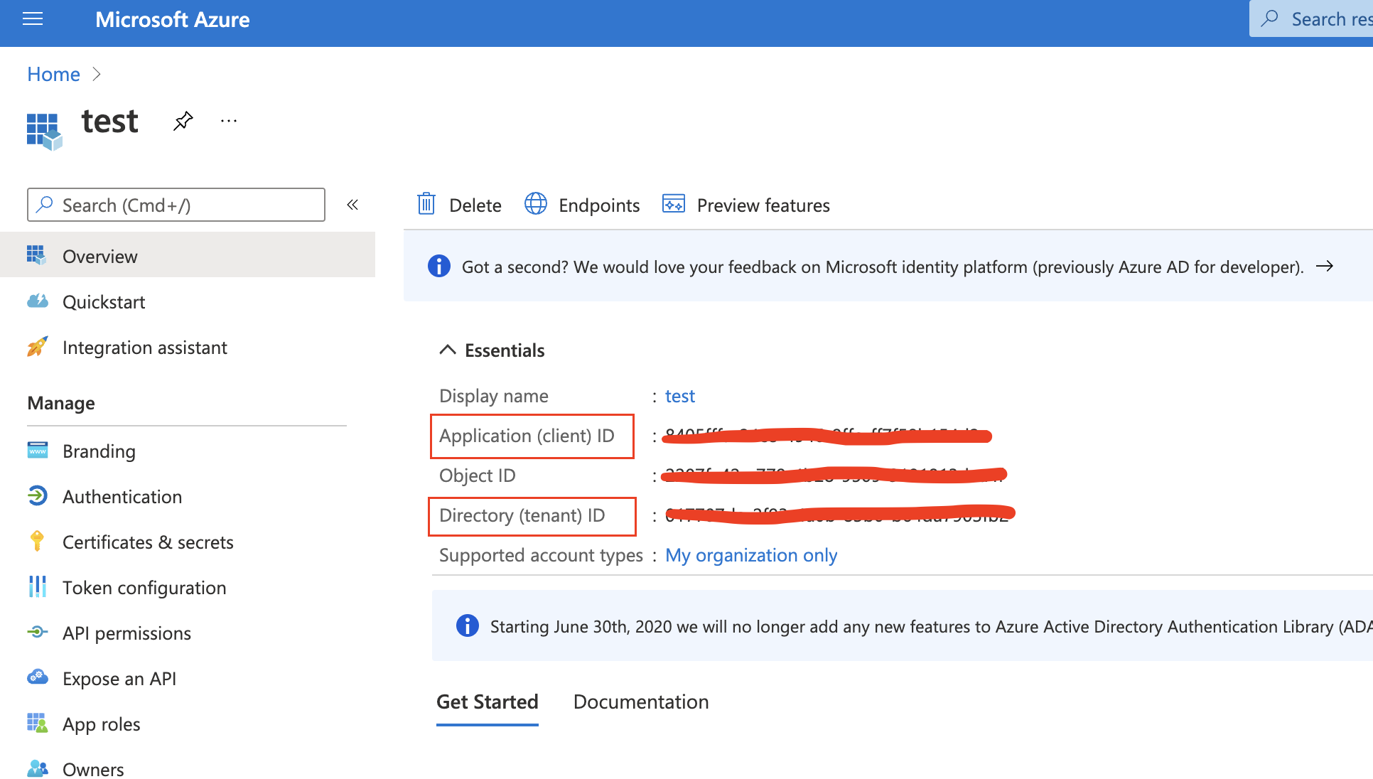

Configure Microsoft Exchange Client ID and Tenant ID
editTo find the application Client ID, open the Overview page.
Copy and paste this values to the proper fields in the Microsoft Exchange email connector.
