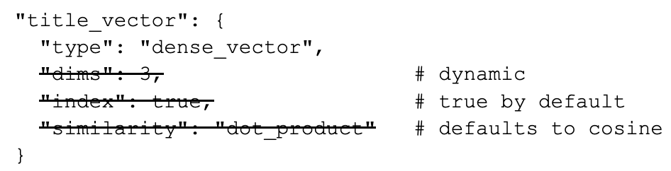

As we can see in the above table, since the version 8.11 the definition of vector fields has been drastically simplified:
Regarding the support for scalar quantization added in 8.12, remember we talked about this compression technique in the first part of this series. We won’t dig deeper in this article, but you can learn more about how this was implemented in Lucene in another Elastic Search Labs article. Similarly, we won’t dive into better binary quantization (BBQ) added in 8.18, and we invite you to learn more about that new groundbreaking algorithm in this article.
That’s all there is to it! By simply defining and configuring a dense_vector field, we can now index vector data in order to run vector search queries in Elasticsearch using either the knn search option or the knn DSL query (introduced in 8.12). Elasticsearch supports two different vector search modes: 1) exact search using the script_score query and 2) approximate nearest neighbor search using the knn search option or the knn query (8.12+). We’re going to describe both modes next.

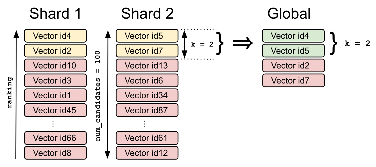

Let’s now move on and learn more about the num_candidates parameter. The role of num_candidates is to increase or decrease the likelihood of finding the true nearest neighbor candidates. The higher that number, the slower the search but also the more likely the real nearest neighbors will be found. As many as num_candidates vectors will be considered on each shard, and the top k ones will be returned to the coordinator node, which will merge all shard-local results and return the top k vectors from the global results as illustrated in Figure 1, below:
Figure 1: Nearest neighbor search accuracy using num_candidates
Vectors id4 and id2 are the k local nearest neighbors on the first shard, respectively id5 and id7 on the second shard. After merging and reranking them, the coordinator node returns id4 and id5 as the two global nearest neighbors for the search query.
