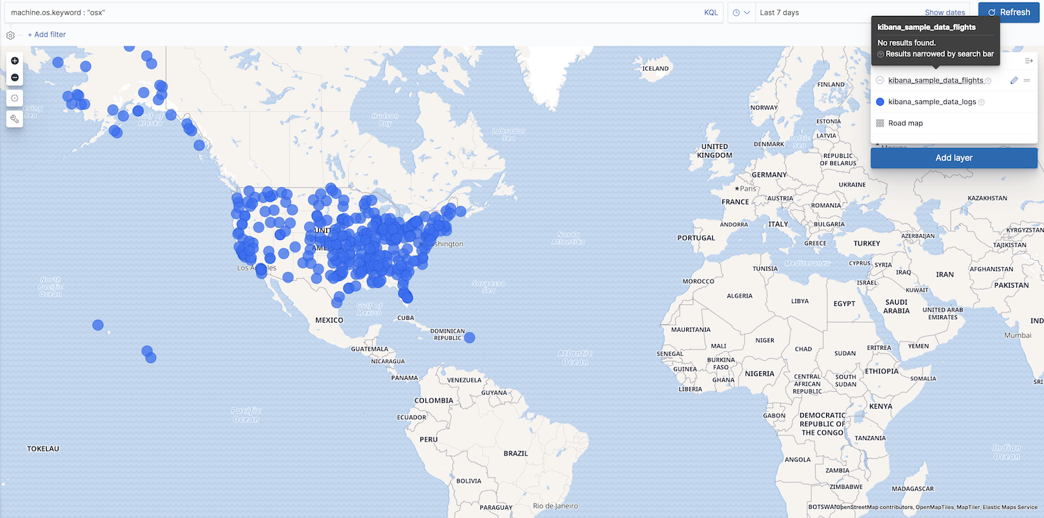

editYour map might contain multiple Elasticsearch indices. This can occur when your map contains two or more layers with Elasticsearch sources from different indices. This can also occur with a single layer with an Elasticsearch source and a Term join.
Searching across multiple indices might sometimes result in empty layers. The most common cause for empty layers are searches for a field that exists in one index, but does not exist in other indices.
Disable global search for a layer
editOne strategy for eliminating unintentional empty layers from a cross index search is to disable global search for a layer.
Use _index in a search
editAdd _index to your search to include documents from indices that do not contain a search field.
For example, suppose you have a vector layer showing the kibana_sample_data_logs
documents
and another vector layer with kibana_sample_data_flights
documents.
(See adding sample data
to install the kibana_sample_data_logs
and kibana_sample_data_flights
indices.)
If you query for
machine.os.keyword : "osx"
the kibana_sample_data_flights
layer is empty because the index
does not contain the field machine.os.keyword
and no documents match the query.
If you instead query for
machine.os.keyword : "osx" or _index : "kibana_sample_data_flights"
layer includes data.
