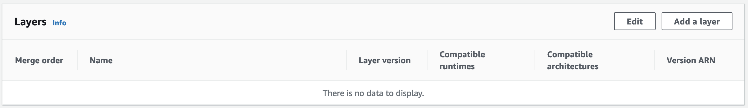

To add the layers to your Lambda function through the AWS Management Console:
  1. Navigate to your function in the AWS Management Console
  2. Scroll to the Layers section and click the Add a layer button image of layer configuration section in AWS Console
  3. Choose the Specify an ARN radio button
  4. Copy and paste the following ARNs of the Elastic APM AWS Lambda extension layer and the APM agent layer in the Specify an ARN text input:

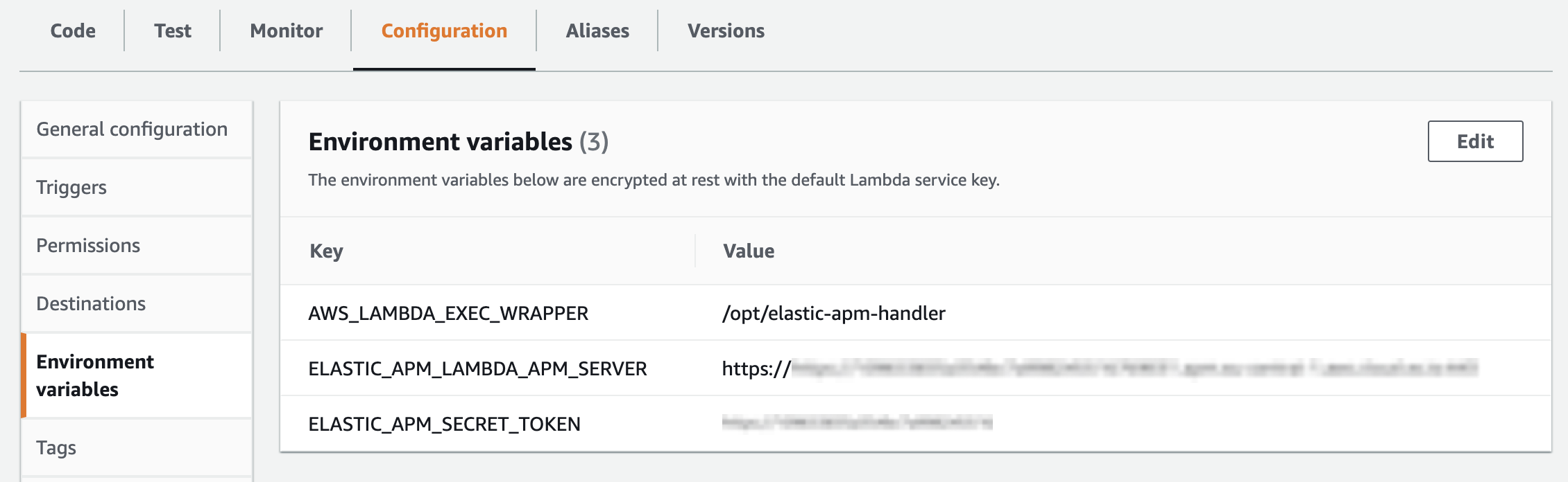

To configure APM through the AWS Management Console:
  2. Click on the Configuration tab
  3. Click on Environment variables
  4. Add the following required variables:
AWS_LAMBDA_EXEC_WRAPPER       = /opt/elastic-apm-handler
ELASTIC_APM_LAMBDA_APM_SERVER = <YOUR-APM-SERVER-URL>
ELASTIC_APM_SECRET_TOKEN      = <YOUR-APM-SECRET-TOKEN>
ELASTIC_APM_SEND_STRATEGY     = background
  1. Use this exact fixed value.
  2. This is your APM Server URL.
  3. This is your APM secret token.
  4. The ELASTIC_APM_SEND_STRATEGY defines when APM data is sent to your Elastic APM backend. To reduce the execution time of your lambda functions, we recommend to use the background strategy in production environments with steady load scenarios.
Java environment variables configuration section in AWS Console
