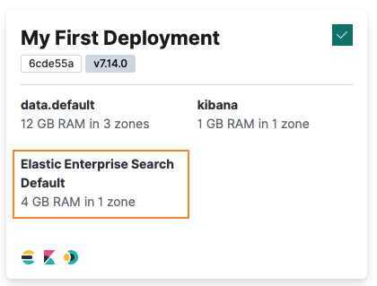

After the configuration change is complete, your deployment now includes Enterprise Search. If you switch back to the Cloud UI, you can open Enterprise Search to test that it works as expected.
The My First Deployment card in the ECE UI now shows Elastic Enterprise Search sized at 4GB RAM in 1 zone
