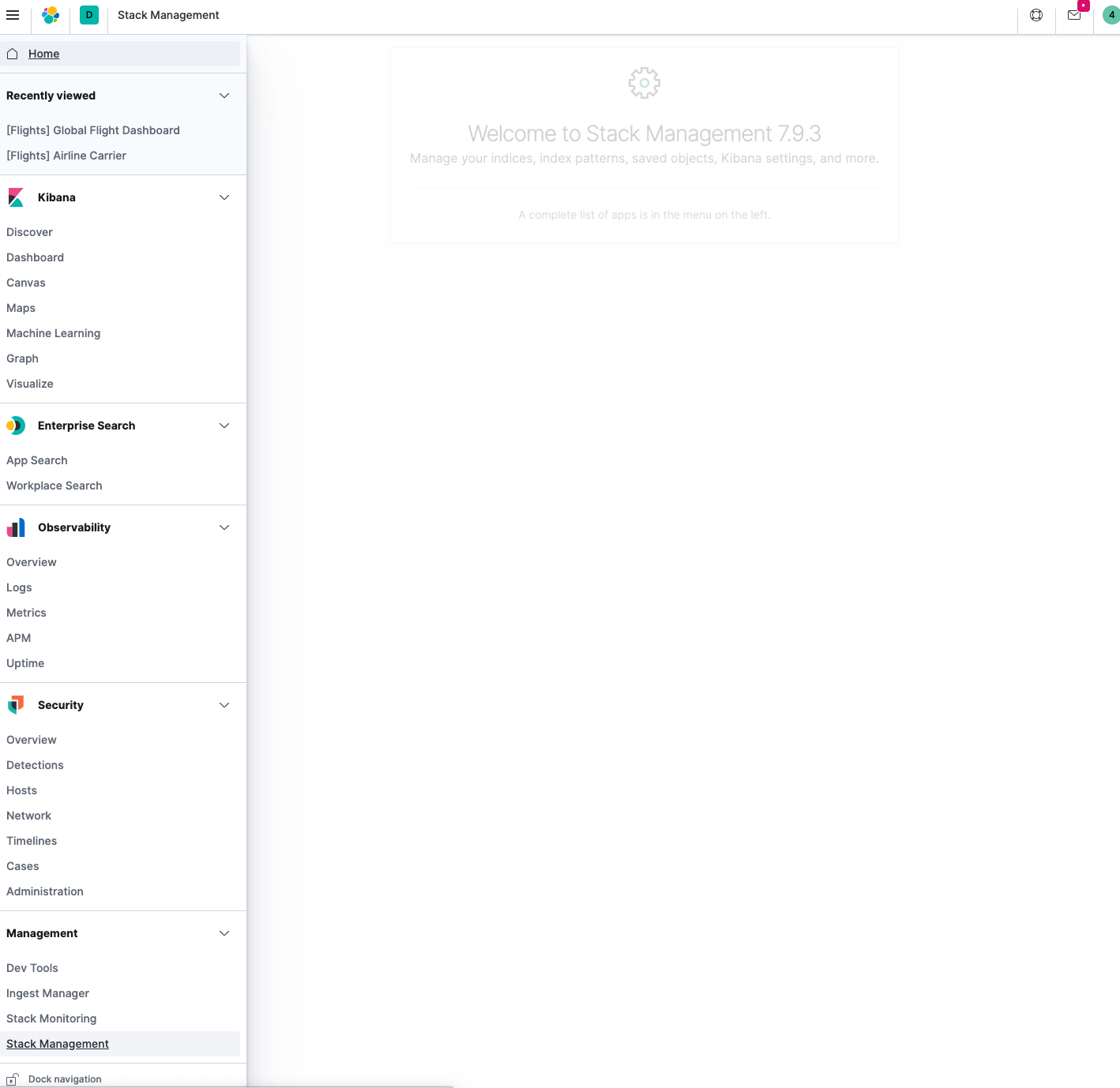

Centralized pipeline management is a subscription feature. If you want to try the full set of features, you can activate a free 30-day trial. To view the status of your license, start a trial, or install a new license, open the Kibana main menu and click Stack Management > License Management. For more information, see https://www.elastic.co/subscriptions and License Management.

  1. Open Kibana in your browser and go to the Management tab. If you’ve set up configuration management correctly, you’ll see an area for managing Logstash.
