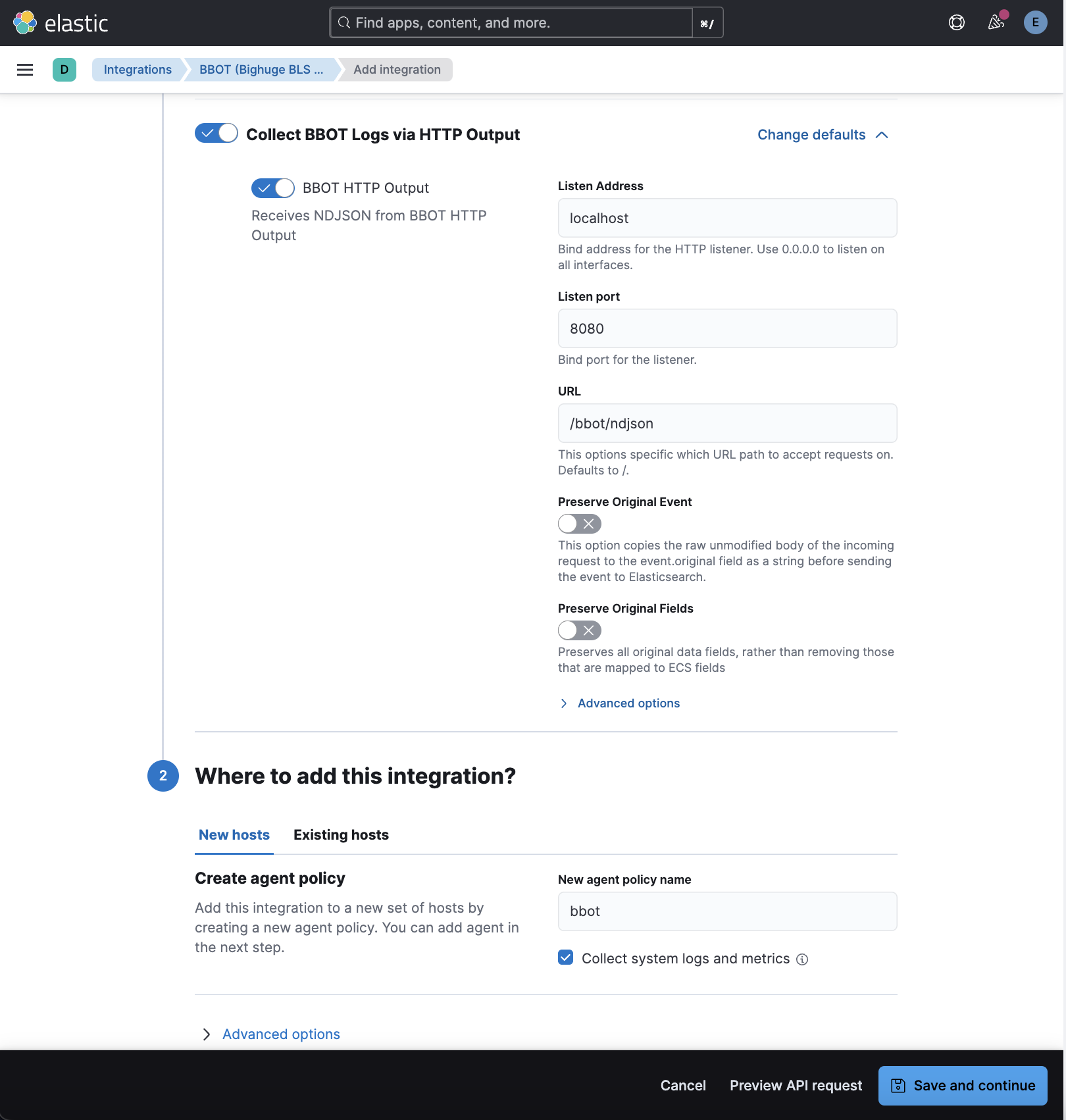

If using the integration to receive events via HTTP endpoint listener, you can use the the http output module.
bbot -t example.com -p subdomain-enum --config modules.http.url=http://your.elastic.agent:8080/bbot/asm_intel modules.http.username=bbot modules.http.password=P@55w0rd modules.http.siem_friendly=true -om http

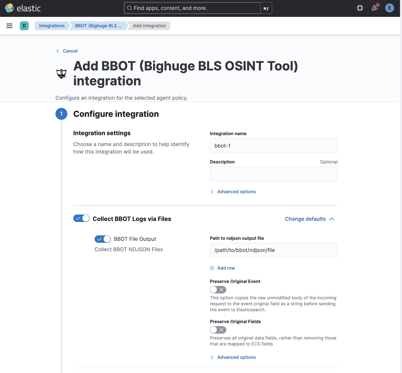

  1. In Kibana navigate to Management > Integrations.
  2. In "Search for integrations" top bar, search for BBOT.
  3. Select the "BBOT" integration from the search results.
  4. Select "Add BBOT" to add the integration.
  5. Add all the required integration configuration parameters including the Path to ndjson output file.
  6. Save the integration.
