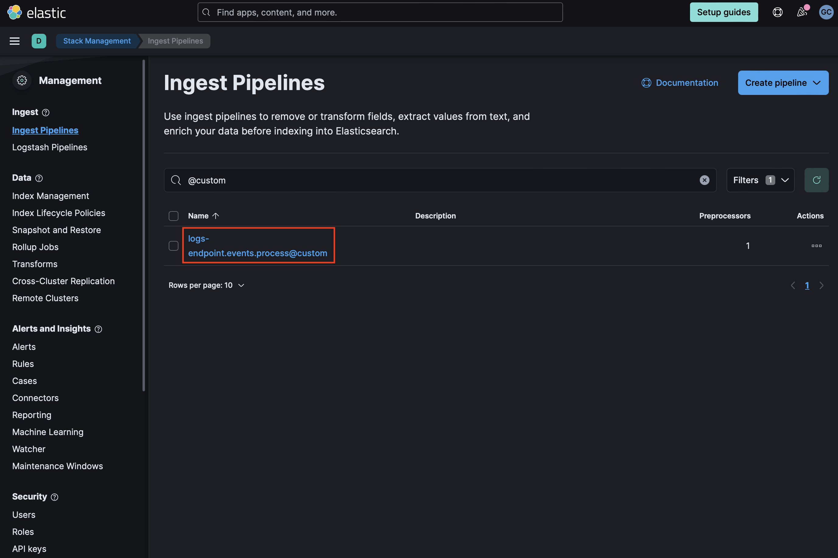

Configure the pipeline: To configure the pipeline you can use one of the following steps:
- If using Elastic Defend, add a custom pipeline to the data stream. Go to Stack Management > Ingest Pipelines, and check if the pipeline
logs-endpoint.events.process@customexists.
If it does not exist, you can create it by running the following command in the Dev Console. Be sure to replace <VERSION>with the current package version.PUT _ingest/pipeline/logs-endpoint.events.process@custom { "processors": [ { "pipeline": { "name": "<VERSION>-ml_pad_ingest_pipeline", "ignore_missing_pipeline": true, "ignore_failure": true } } ] } - If
logs-endpoint.events.process@customalready exists, select the three dots next to it and choose Edit. Click Add a processor. Select Pipeline for Processor, enter<VERSION>-ml_pad_ingest_pipelinefor name (replacing<VERSION>with the current package version), and check Ignore missing pipeline and Ignore failures for this processor. Select Add Processor.

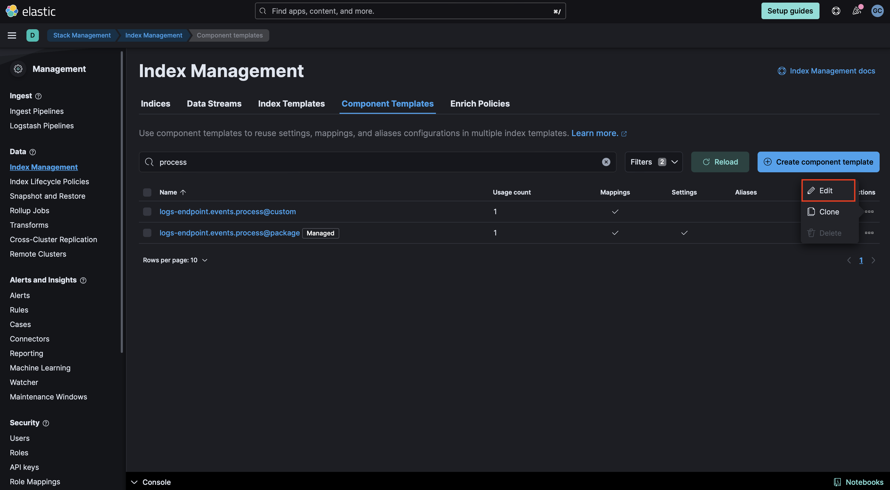

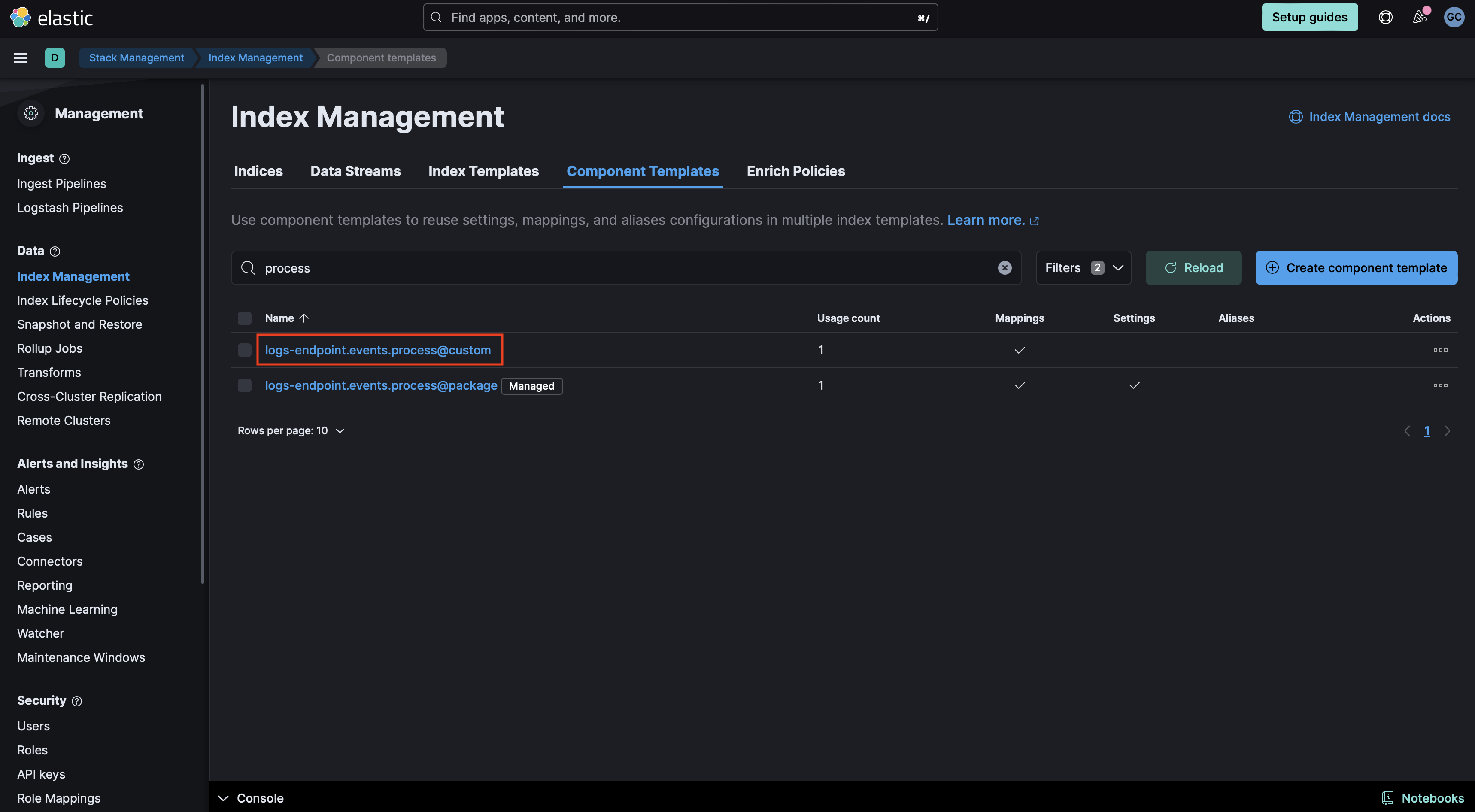

Add the required mappings to the component template: Go to Stack Management > Index Management > Component Templates. Templates that can be edited to add custom components will be marked with a
@customsuffix. For instance, the custom component template for Elastic Defend process events islogs-endpoint.events.process@custom. Note: Do not attempt to edit the@packagetemplate.
- If the
@customcomponent template does not exist, you can execute the following command in the Dev Console to create it and then continue to the Rollover section in these instructions. Be sure to change<VERSION>to the current package version.PUT _component_template/{COMPONENT_TEMPLATE_NAME}@custom { "template": { "mappings": { "properties": { "process": { "type": "object", "properties": { "command_line_entropy": { "type": "double" } } } } } } } - If the
@customcomponent template already exists, you will need to edit it to add mappings for data to be properly enriched. Click the three dots next to it and select Edit.

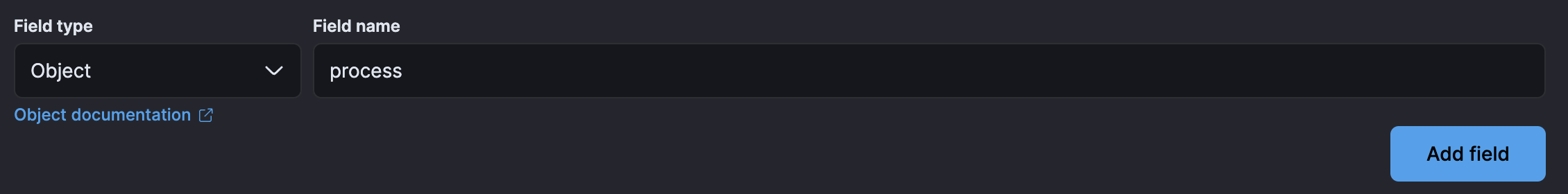

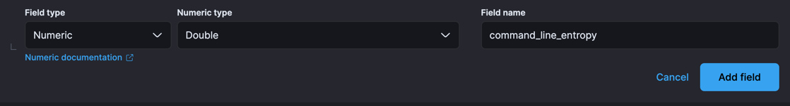

- Proceed to the mappings step in the UI. Click Add Field at the bottom of the page and create an
Objectfield forprocess:
- Create a property under Process for
command_line_entropyof typeDouble.
- Your component mappings should look like the following:
- Click Review then Save Component Template.

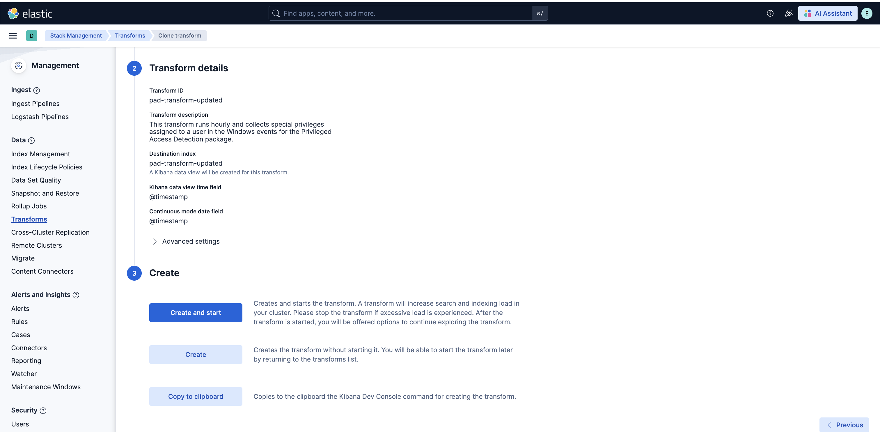

To customize filters in the Privileged Access Detection transform, follow the below steps. You can use these instructions to update basic settings or to update filters for fields such as process.name, @timestamp and others.

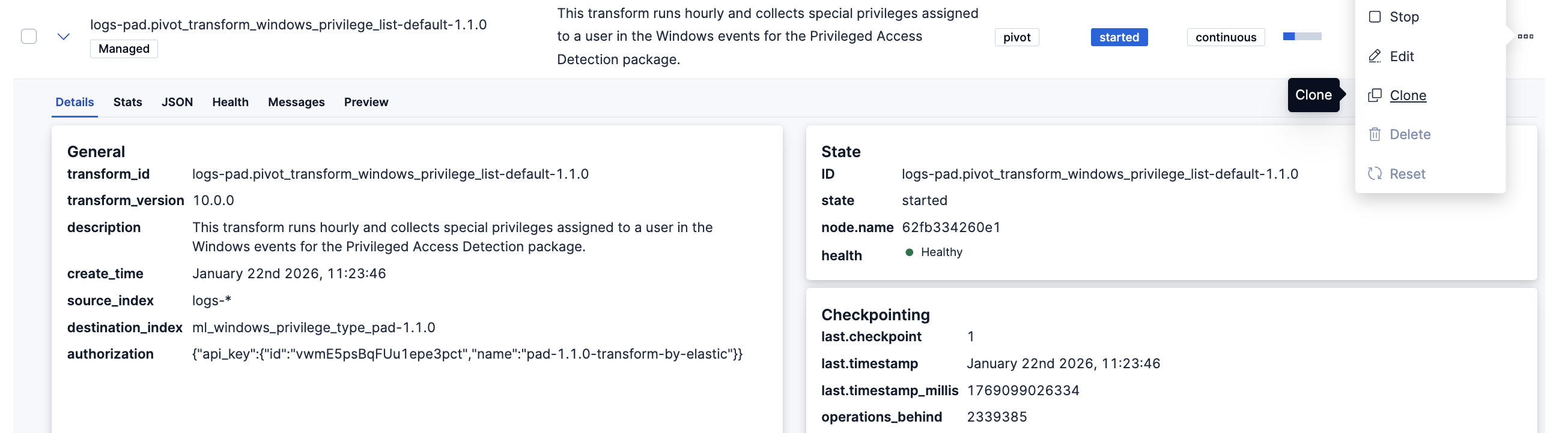

- To update settings such as retention policy, frequency, or destination configuration, stop the transform, click Edit from the Actions bar, make the required changes, and start the transform again.

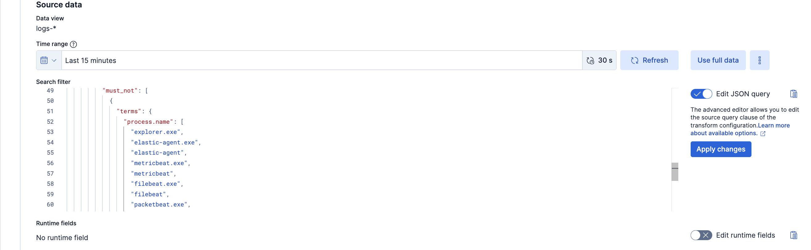

- To update the query filters, go to Stack Management > Data > Transforms >
logs-pad.pivot_transform_windows_privilege_list-default-<FLEET-TRANSFORM-VERSION>. - Click on the Actions bar at the far right of the transform and select the Clone option.

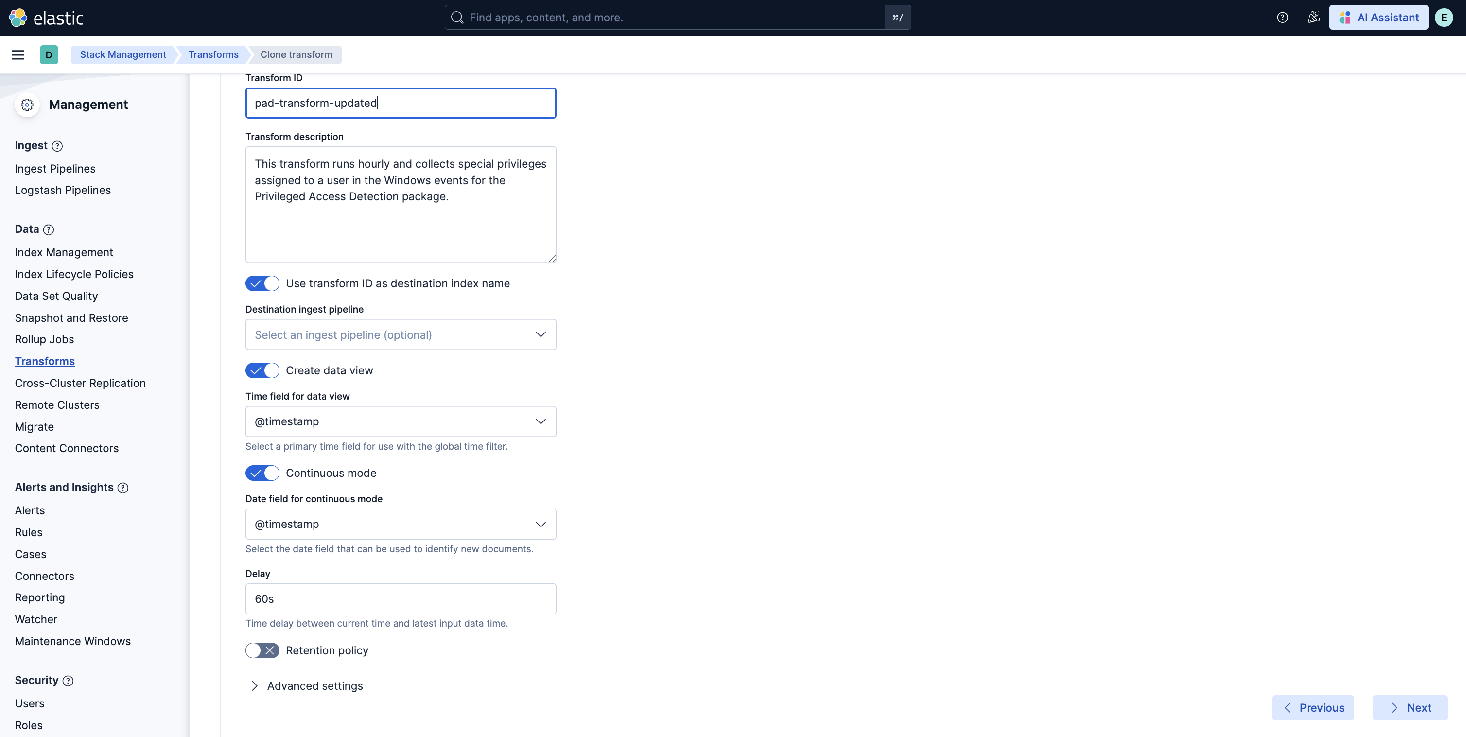

- In the new Clone transform window, go to the Search filter and update any field values you want to add or remove. Click on the Apply changes button on the right side to save these changes. Note: The image below shows an example of filtering a new
process.nameasexplorer.exe. You can follow a similar example and update the field value list based on your environment to help reduce noise and potential false positives.
- Scroll down and select the Next button at the bottom right. Under the Transform details section, enter a new Transform ID and Destination index of your choice, then click on the Next button.
- Lastly, select the Create and Start option. Your updated transform will now start collecting data. Note: Do not forget to update your data view based on the new Destination index you have just created.

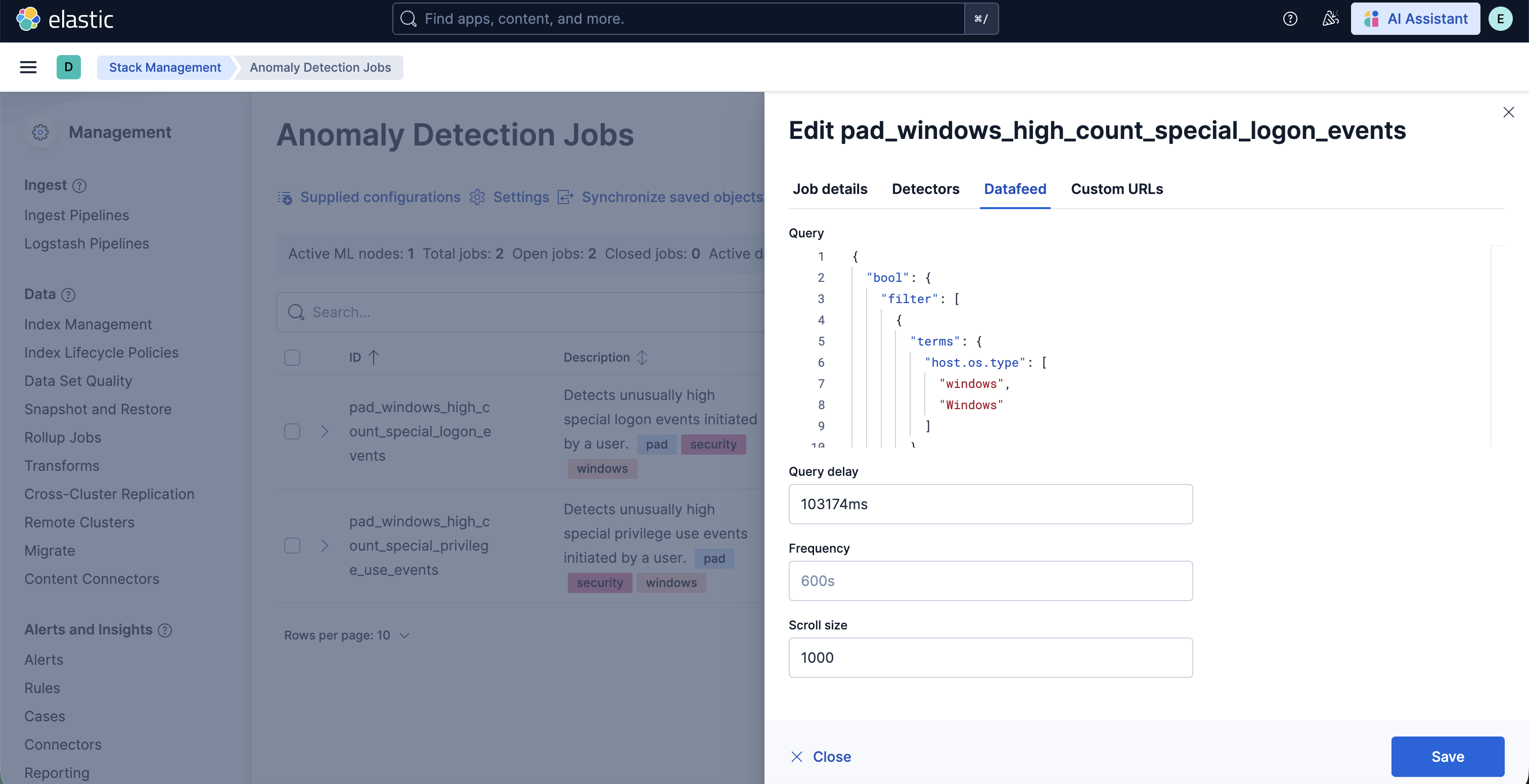

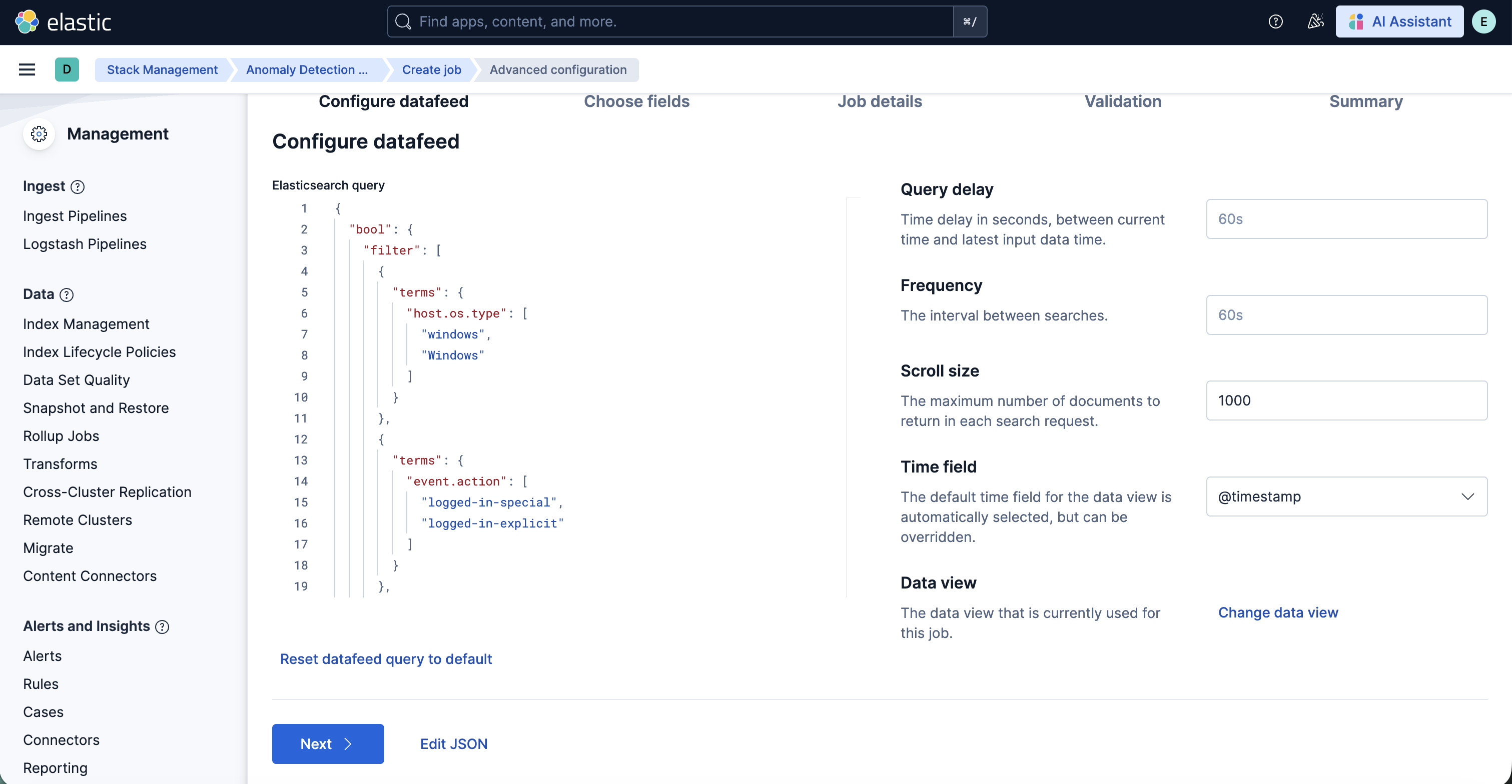

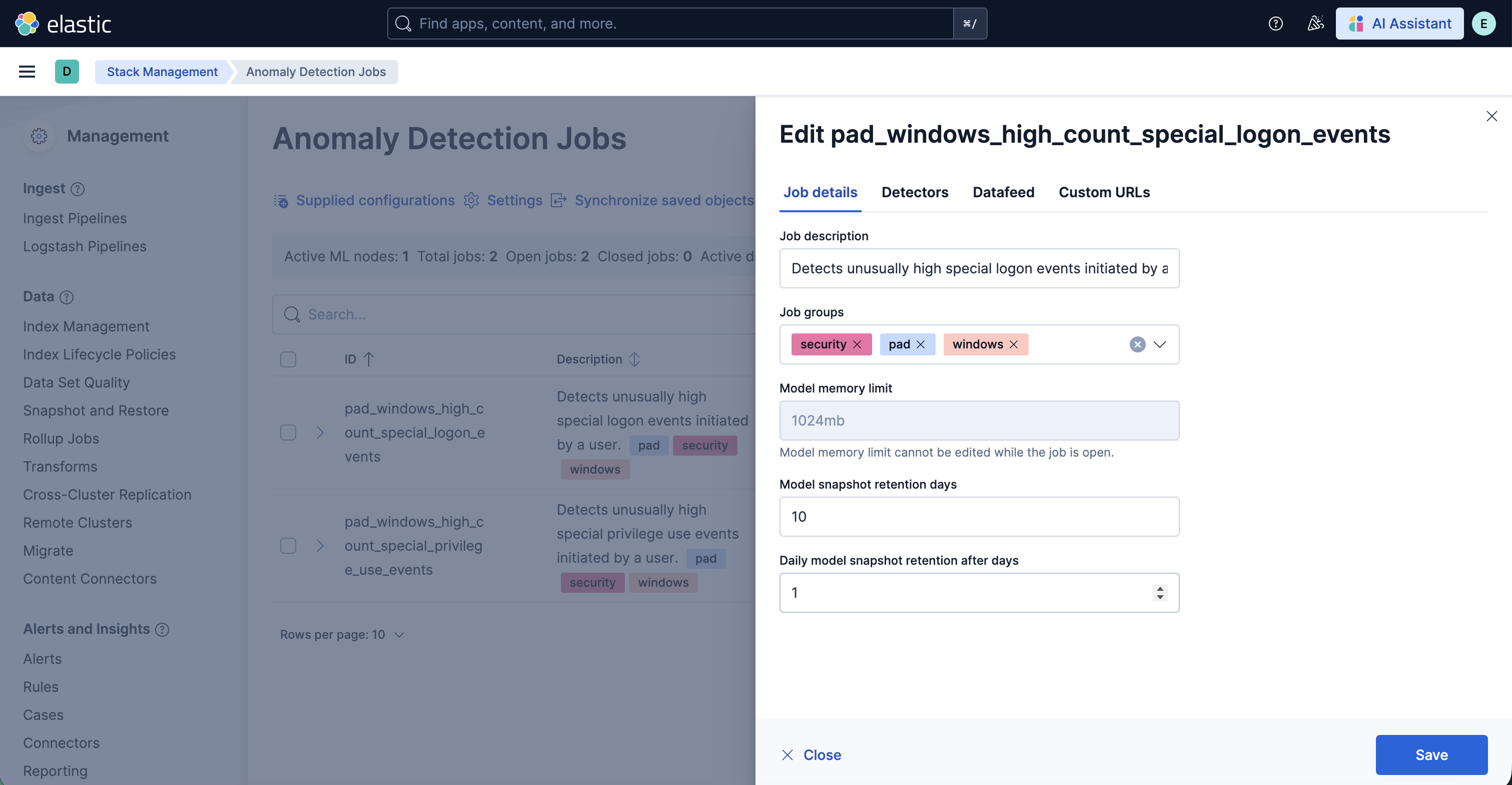

To customize the datafeed query and other settings such as model memory limit, frequency, query delay, bucket span and influencers for the Privileged Access Detection ML jobs, follow the steps below.

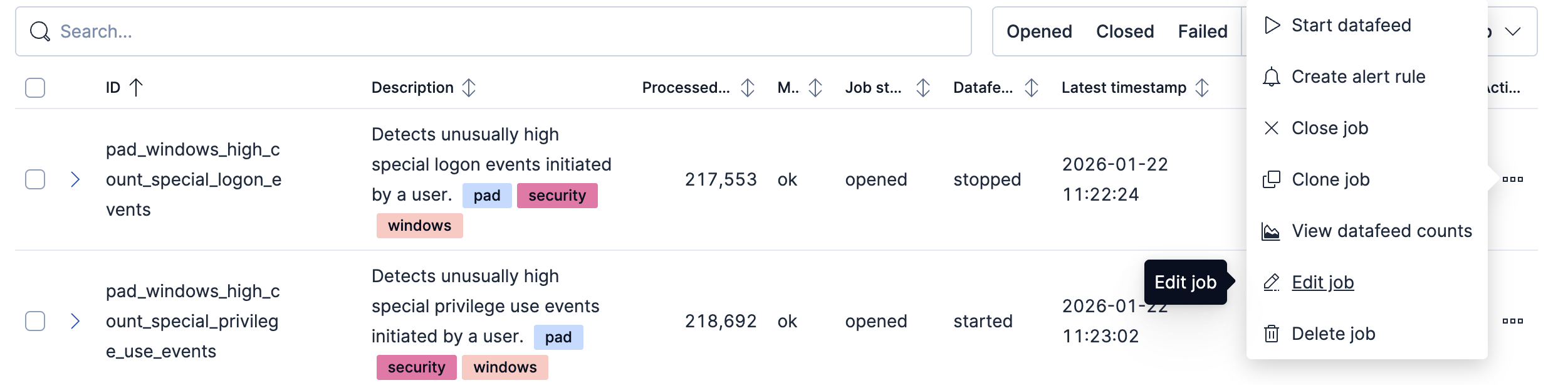

- To update the datafeed query, stop the datafeed and select Edit job from the Actions menu.
- In the Edit job window, navigate to the Datafeed section and update the query filters. You can add or remove field values to help reduce noise and false positives based on your environment.
- You may also update the model memory limit if your environment has high data volume or if the job requires additional resources. Go to the Job details section and update the Model memory limit and hit Save. For more information on resizing ML jobs, refer to the documentation.

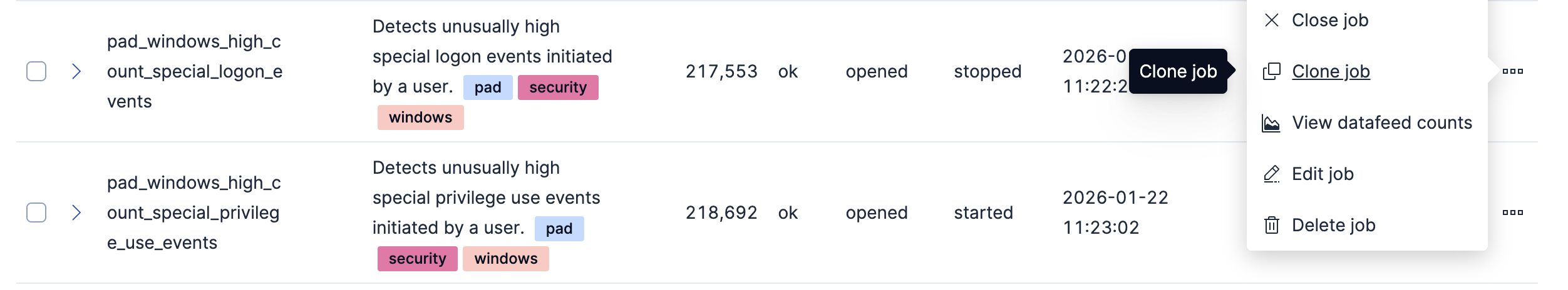

- In order to do more advanced changes to your job, clone the job by selecting Clone job from the Actions menu.
- In the cloned job, you can update datafeed settings such as Frequency and Query delay, which help control how often data is analyzed and account for ingestion delays.

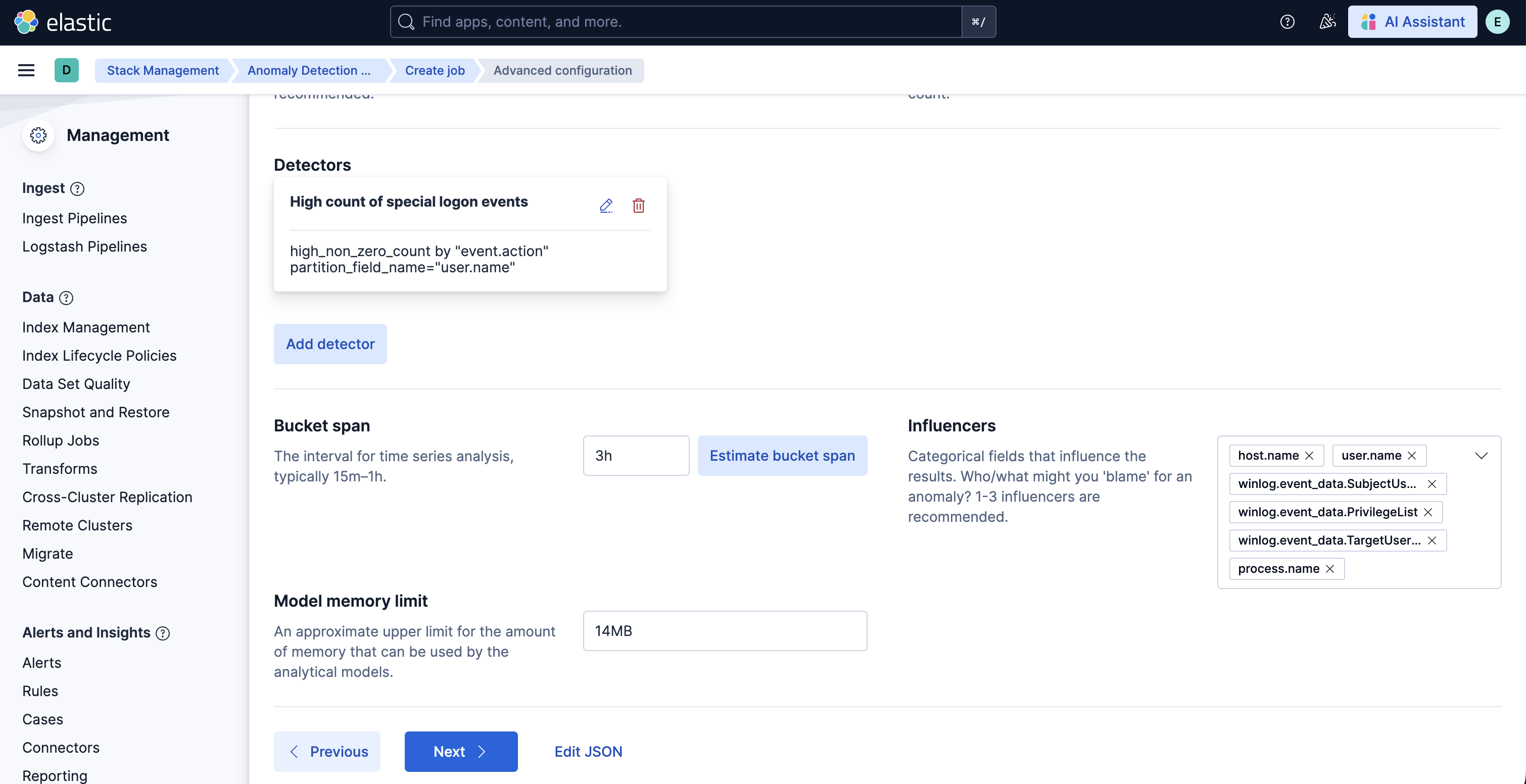

- You can also modify the job configuration by adjusting the Bucket span and by adding or removing Influencers to improve anomaly attribution.
- Finally, assign a new Job ID, and click on Create job, and start the datafeed to apply the updated settings.
