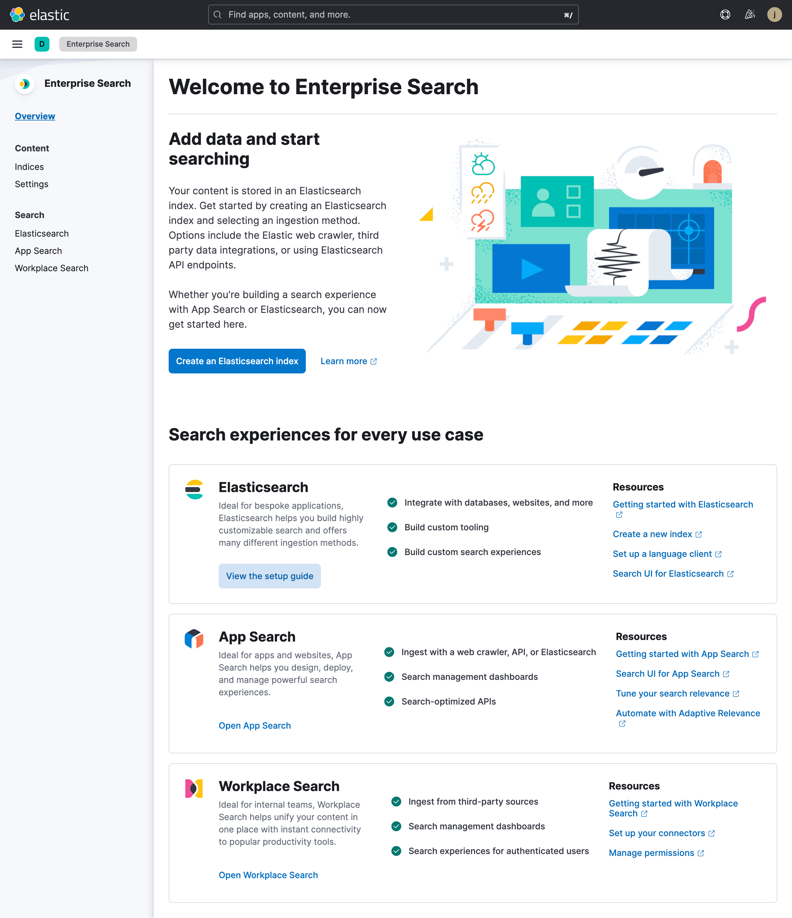

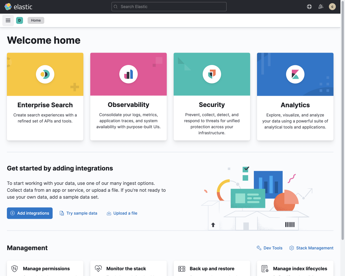

First we need to setup App Search, which is a part of Elastic Enterprise Search. The easiest way to do this is to create a deployment on Elastic Cloud. You can sign up for a free 14-day trial here, no credit card required.
Once your deployment has been created, navigate to Enterprise Search in Kibana. You should be able to see a link to Enterprise Search from the home menu.
search-ui
search-ui

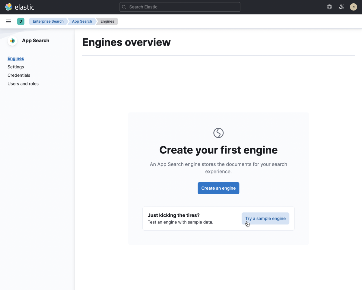

In the next step, we’ll navigate to App Search and create an engine that will hold our US national parks documents.
Select "Try a sample engine", which creates a engine loaded with useful sample data. The sample engine will be pre-loaded with the US national parks dataset that we’ll need for our search experience. Easy!
search-ui

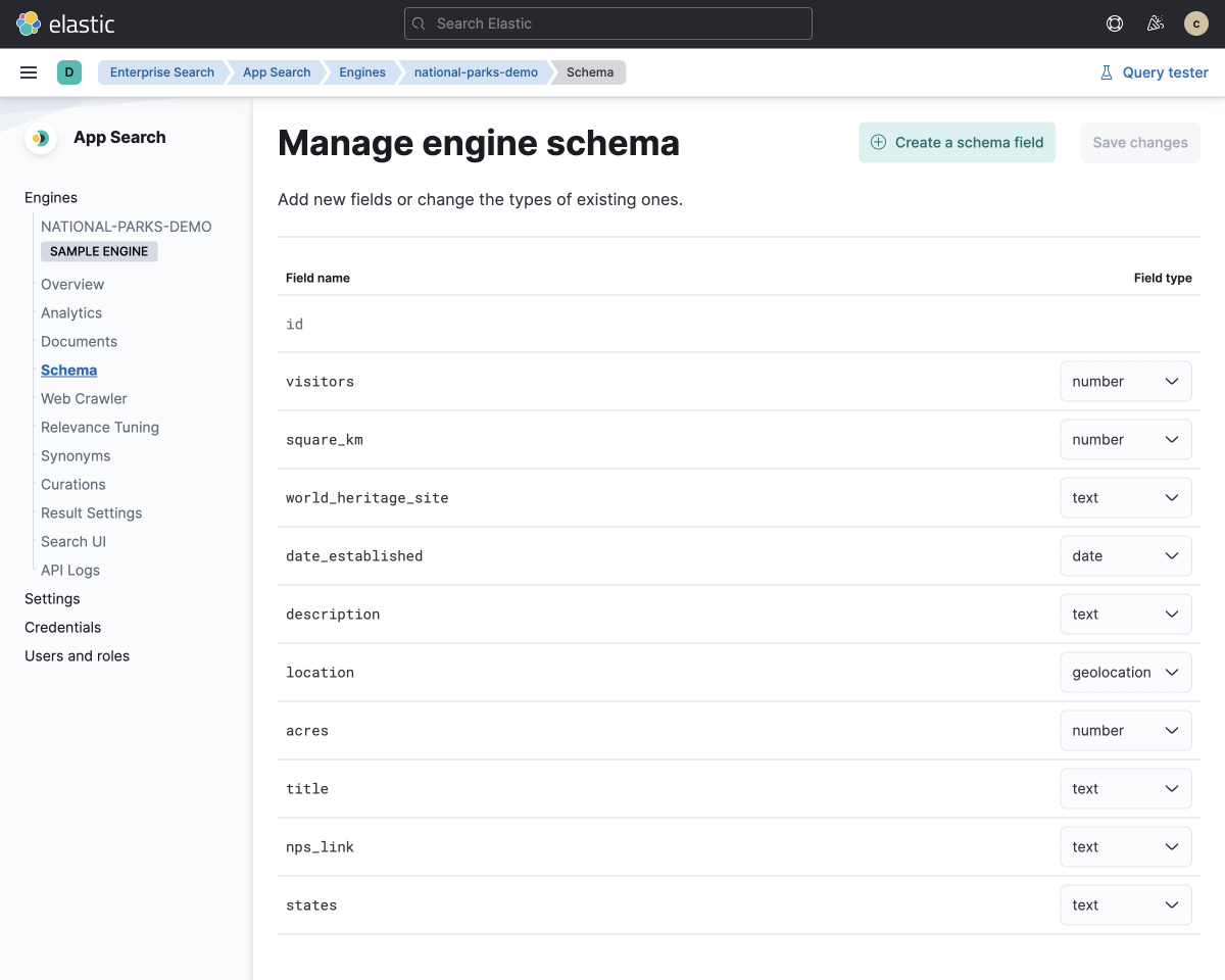

Once our sample engine has been created, the next step is to inspect our engine’s schema. By default, App Search will choose the field type "text" for each field, but we can manually configure the field types to match the type of data each field represents — text, date, geolocation, or number. For the sample engine, the fields have been pre-configured for us.
search-ui
If you inspect the schema, you’ll notice that a number of fields have been changed from their default text field type:
  • visitors to be a number
  • square_km to be a number
  • date_established to be a date
  • location to be a geolocation
  • acres to be a number
Adjusting the field type allows us to use different queries, facets, and filters only applicable to the field types we are using. Learn more about App Search schemas

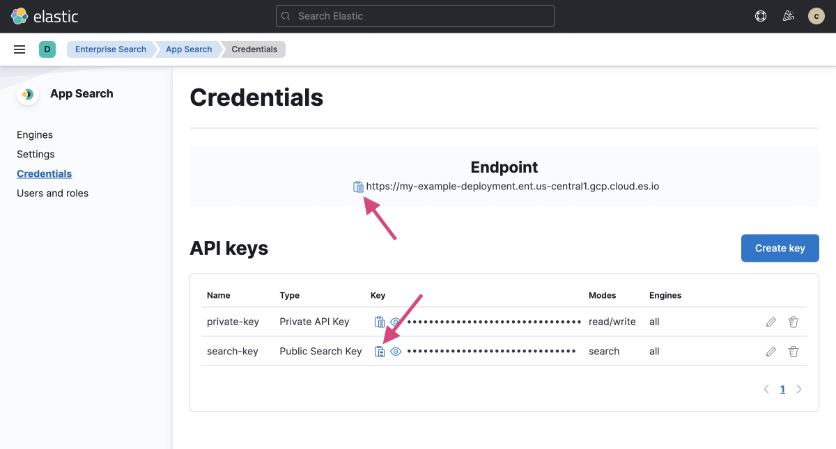

API keys are used to access the engine. By default, there are two key types available:
  • private-key: This is the key that is used to read and write to the engine.
  • search-key: This is the key that has read only access to the engine.
search-ui
For this example, we are going to use the search-key. By default the search-key has been created. To use it, we must copy the key. Keep this key safe, we will be using it later on.
Also above is the host url. Copy this as we will use it later on as well.

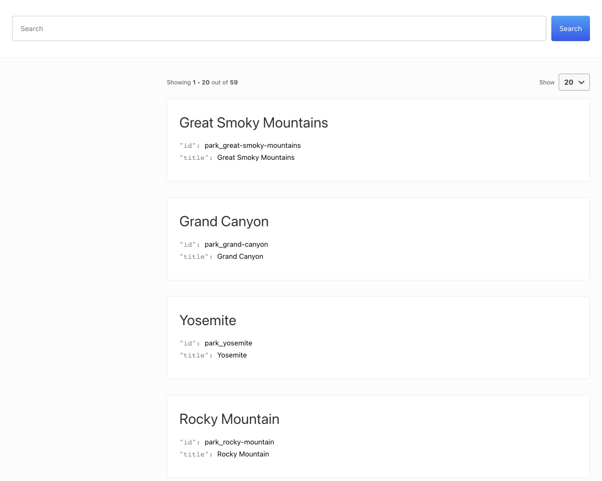

Lets check that the app works by running the following command:
yarn start
You should now have a working, basic search experience that looks similar to the example below:
search-ui

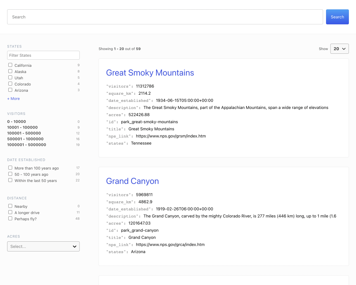

For these facets to appear, we need to add the facet components to our view. Let’s replace the sideContent prop in our view with the example below:
sideContent={
  <div>
    <Facet
      field="states"
      label="States"
      isFilterable={true}
    <Facet
      field="world_heritage_site"
      label="World Heritage Site?"
      view={BooleanFacet}
    <Facet
      field="visitors"
      label="Visitors"
      view={SingleLinksFacet}
    <Facet
      field="date_established"
      label="Date Established"
    <Facet
      field="location"
      label="Distance"
    <Facet
      field="acres"
      label="Acres"
      view={SingleSelectFacet}
  </div>
Last but not least, we want some of our facets to be "OR" facets rather than "AND". Making that change is a two step process:
  1. Make the facet "disjunctive" by adding it to the disjunctiveFacets list config. This will ensure that the facet displays all available options for selection, so that users can make multiple selections.
disjunctiveFacets: ["states"],
  1. Make the Facet component user the filterType of any.
<Facet field="states" label="States" filterType="any" isFilterable={true} />
You should be able to see the results of your search like below:
search-ui
