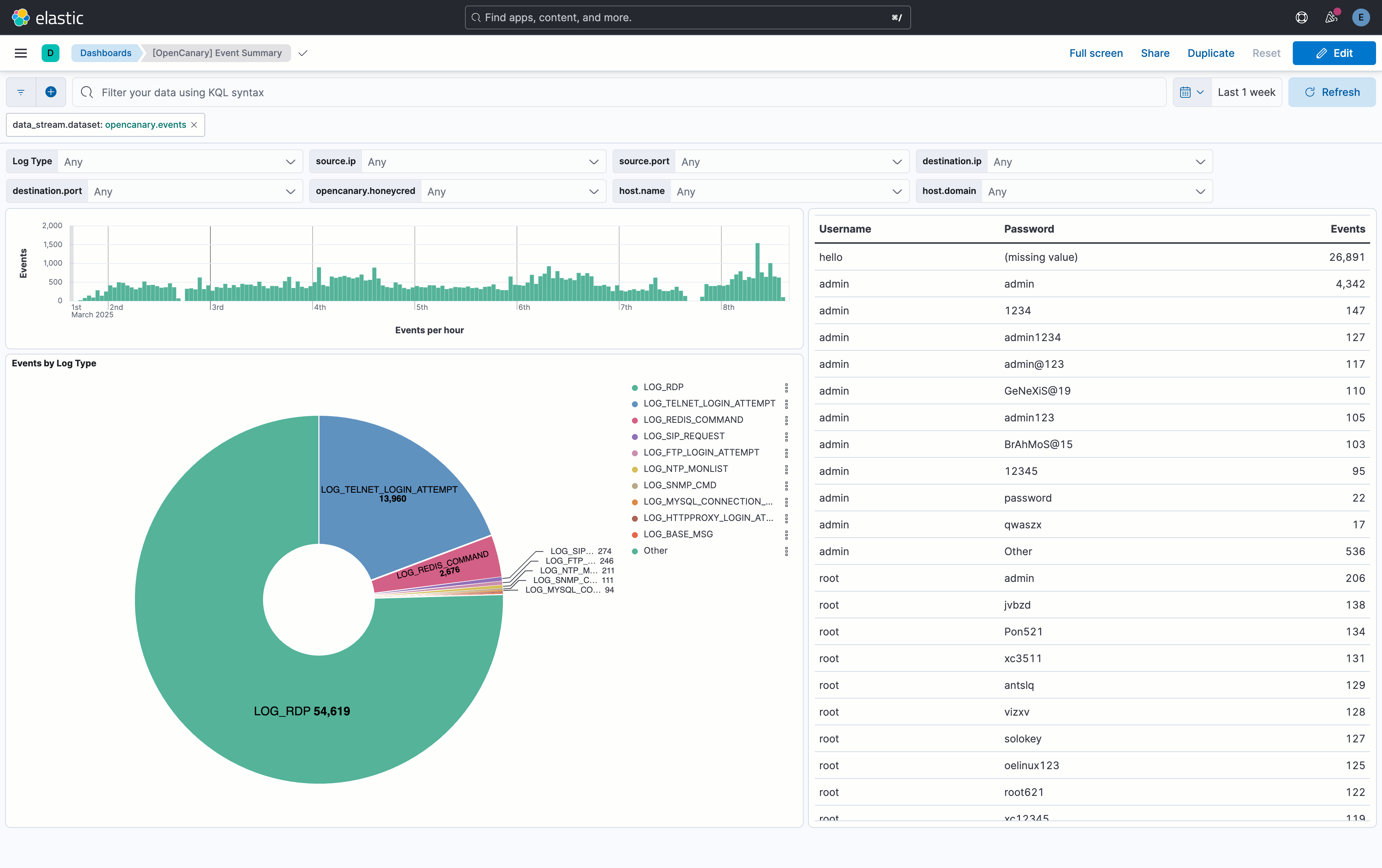

This integration is for Thinkst OpenCanary honeypot event logs. The package processes messages from OpenCanary honeypot logs.
The OpenCanary integration collects the following event types:
- events

The events
dataset collects the OpenCanary logs.
Example
