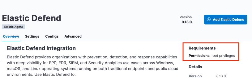

Most Elastic integrations support running Elastic Agent in unprivileged mode. For the exceptions, any integration that requires Elastic Agent to have root privileges has the requirement indicated at the top of the integration page in Kibana:
Elastic Defend integration page showing root requirement

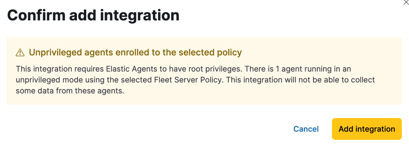

As well, a warning is displayed in Kibana if you try to add an integration that requires root privileges to an Elastic Agent policy that has agents enrolled in unprivileged mode.
Warning indicating that root privileged agent is required for an integration

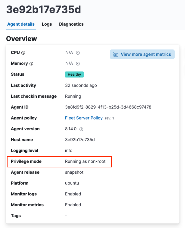

The Agent details page shows you the privilege mode for any running Elastic Agent.
To view the status of an Elastic Agent:
  1. In Fleet, open the Agents tab.
  2. Select an agent and click View agent in the actions menu.
  3. The Agent details tab shows whether the agent is running in privileged or unprivileged mode.
    Agent details tab showing the agent is running as non-root

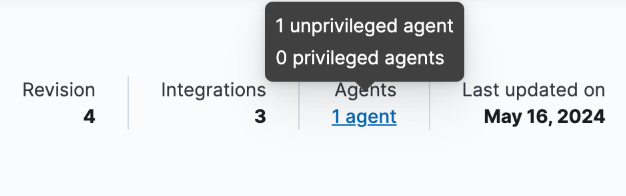

As well, for any Elastic Agent policy you can view the number of agents that are currently running in privileged or unprivileged mode:
  1. In Fleet, open the Agent policies tab.
  2. Click the agent policy to view the policy details.

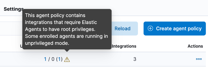

The number of agents enrolled with the policy is shown. Hover over the link to view the number of privileged and unpriviled agents.
Agent policy tab showing 1 unprivileged agent and 0 privileged enrolled agents
In the event that the Elastic Agent policy has integrations installed that require root privileges, but there are agents running without root privileges, this is shown in the tooltip.
