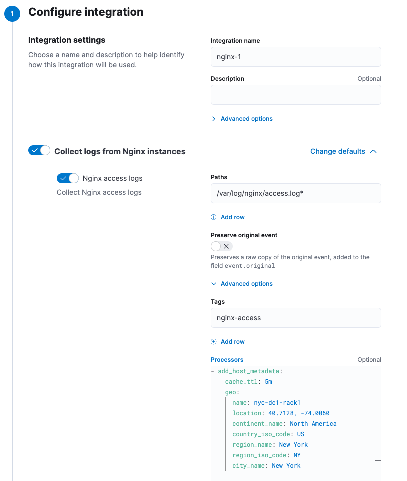

  • Under integration settings in the Integrations UI in Kibana. For example, when configuring an Nginx integration, you can define processors for a specific dataset under Advanced options. The processor in this example adds geo metadata to the Nginx access logs collected by Elastic Agent:
    Screen showing how to add a processor to an integration policy
